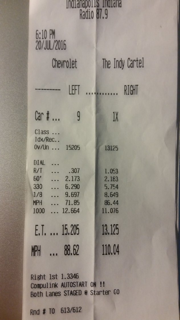

I have a bone stock '02 Z06 w/ 59k miles. I have owned it for 3 weeks, and finally got it out to the track this last wednesday. Of 10 passes, this was the 3rd one I made. It was also the fastest. DA was around 2700. I understand that my ET was bad because of my 60' amd the DA, but is my mph something I should be concerned about? I was expecting 113+ even with the high DA. Here is a pic of the slip. I am the right lane btw.

picking up 24 miles an hour in the back half is pretty good

Incrementally, the timeslip appears correct. The trap speed does correspond to those numbers. I would suspect that you may pick up a small amount of trap speed once you become more familiar with the car. Given that it is your first time out, I would say that you have done quite well.

Correcting for altitude alone puts you at 113.77. Add in driver mod via more seat time and you are good to go.

Other then your 60' being garbage ehh mph-1/4 looks correct
