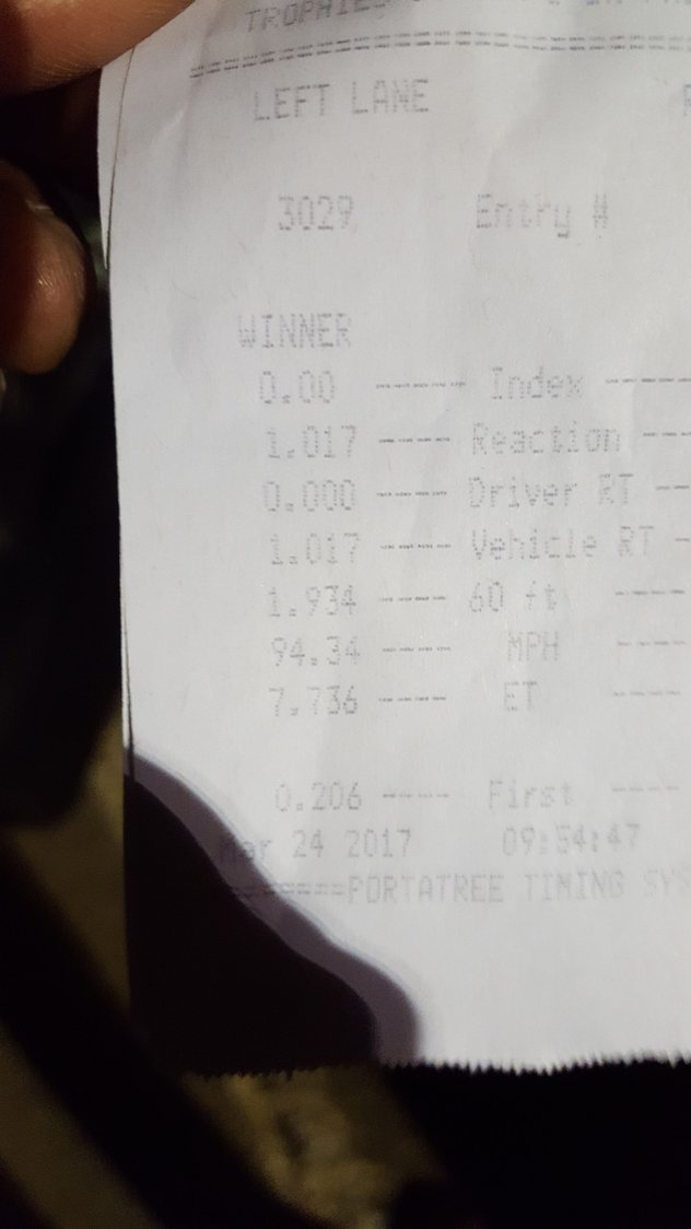

Default Update: McLeod RST
New clutch, tweaked my tune and lowered tire pressure. Cut a 1.8 60 ft. and 7.6 ET, but lower mph??? Tire pressure too low maybe? This is with old 295s up front at 30 psi. I imagine this factors in somehow.

lower mph because you hooked better, probably bogged some. You have too much tire for your setup. Go to 26s honestly. I had 28s on my full bolt on T/A and it did the same thing.. dead hooked but crappy 60 foots.
You mentioned tune. That is likely your lower MPH issue, not the 60'.

If he lost 5mph in the 1/8th from a tune something is waaay wrong with that tune.

I agree. But I would not pin the mph loss on a better 60'. Once that event (the 60' that is) is done, it's done. MPH down is indicative of motor not accelerating through the power band as quickly as before; timing/fuel/DA are likely culprits.

It's definitely not the tune. I tuned it.
Reviewed my logs and turns out I was low on nitrous. Way too rich on wot....no nitrous.
Best mph on motor was 91 mph. Ran 94 this time. So it's making more power for sure.
