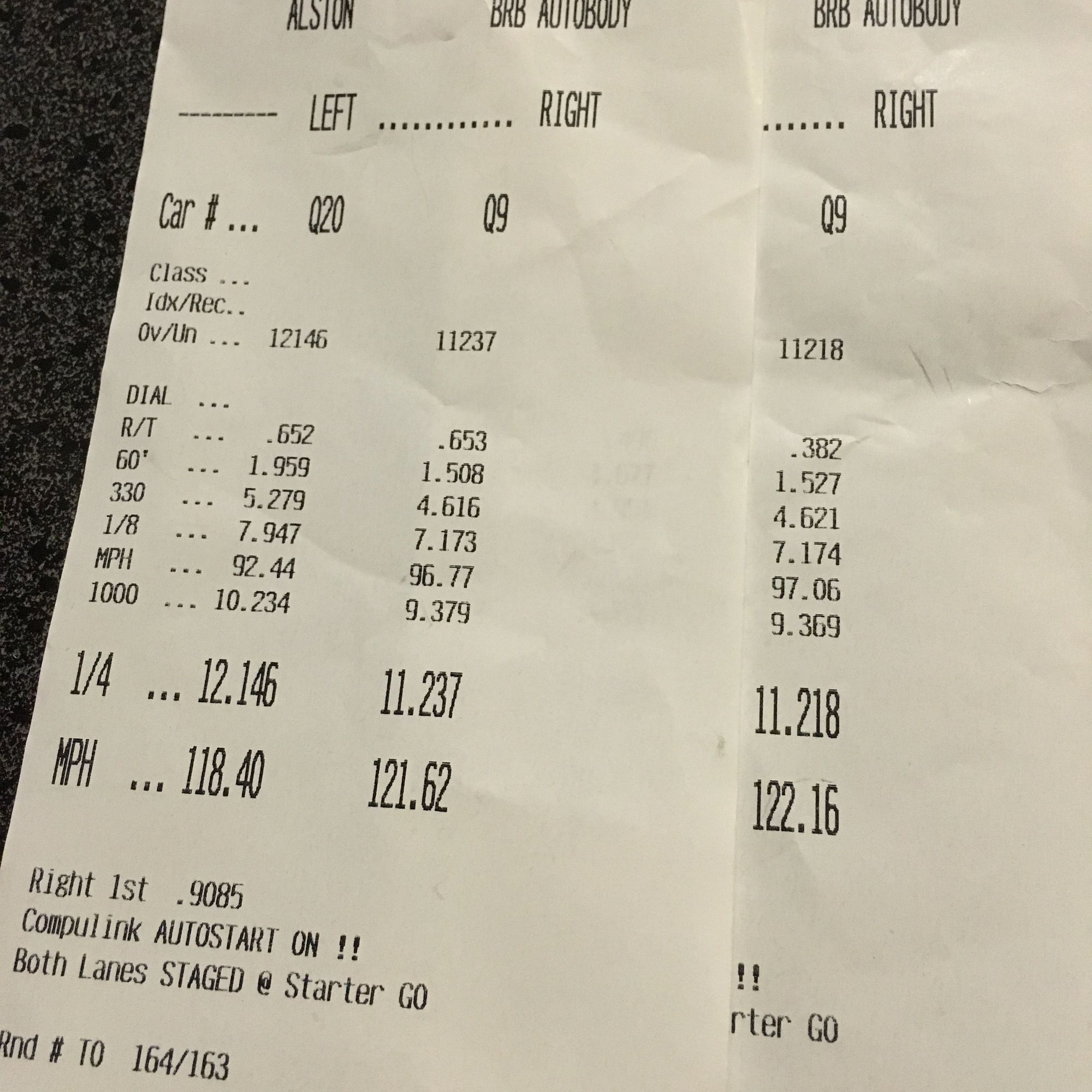

car info 01 c5z h/c/i full bolt'ons 475rwhp 415rwtq N/A 600rwhp 599rwtq spray
took my car down to RPM to have the clutch changed, the trans & diff gone true while it was all open i decided to upgrade the trans output shaft to 30 spline and the only 30 spline ring and pinion they had in stock was a 3.90 & 3.42 gear, I had a 3.73 in the car and really liked it wanted to stick with it but sort notice unplanned swap i said the hell with it put the 3.90 in
so wondering if i done the right thing? the car sees the the strip usually after modding to see the results and some nights in Mexico with some friends
last track passes with 3.73 gear n/a no spray

I have been running a 390 gear on the street since 2009. Great for the track (some say the 410 is a better move). However, it is a lot for the street. Hard to get any traction in first and second...and sometimes third will get loose in the upper rpm range. No regrets though !

i have about 500 miles on the car now, car feels a little better then when it had the 3.73 but for such a small jump in gear ratio its a huge change in that car i think i need to retune mileage is really low about 15mph mix and thats keeping my foot out of it, cam surge is annoying at times and to keep the rpm under 2500 i need to be in 5th gear by like 40mph
at this point i was much happier with the 3.73 on the street, this feels like a 4.10 gear to me
