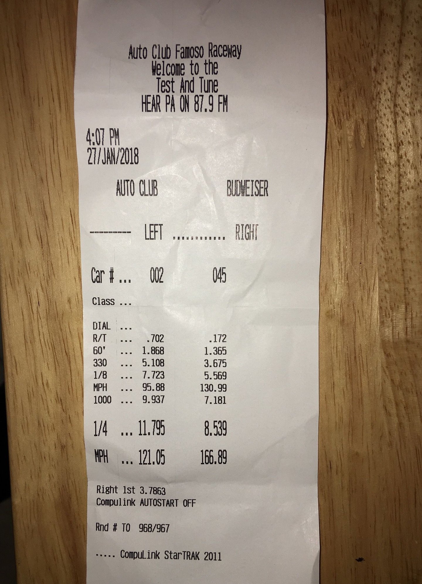

Please add me to the 346< power adder list. 1998 C5 coupe full interior with stock seats and cage certified to 8:50. 3800 lb with me in it race weight.
427 LS7 style ERL block
callies dragon slayer crank
manly Pro I-beam rods
Diamond custom turbo pistons hard anodized
All Pro LS7 style heads by West Coast CH
Custom cam by BTR
Twin 70mm Garett self designed rear mount turbos
water meth injection above 5lb boost
Foot brake to 2800RPM with 200 shot of nitrous off the line for 100’ to spool turbos.
RPM’s best 4L60E trans with 3.73 quafie stock case
and girdle
3400 stall Yank Pro 3 disc converter
stock suspention with ZO6 shocks
Converted drive line with U-joints in torque tube
28”x 10”x16” Hossier slicks and M&H front runners
Set national record for C-5 with 4L60E trans full weight
19LB boost on MS-109. Drove 20miles to track and home. 8.539 @ 166.89. 1.365 60’. Ran 8.80 on street tune and pump gas at 15LB boost.Link to video on FB
1st run on 9LB boost controller off. second sets record
19LB boost. Weight and MPH put RWHP at 1390
Conditions we’re as good as I’ve ever seen. DA 275 outside temp 67 deg. Track temp 95. Track prep was outstanding. Ran at Famoso in Bakersfield.
