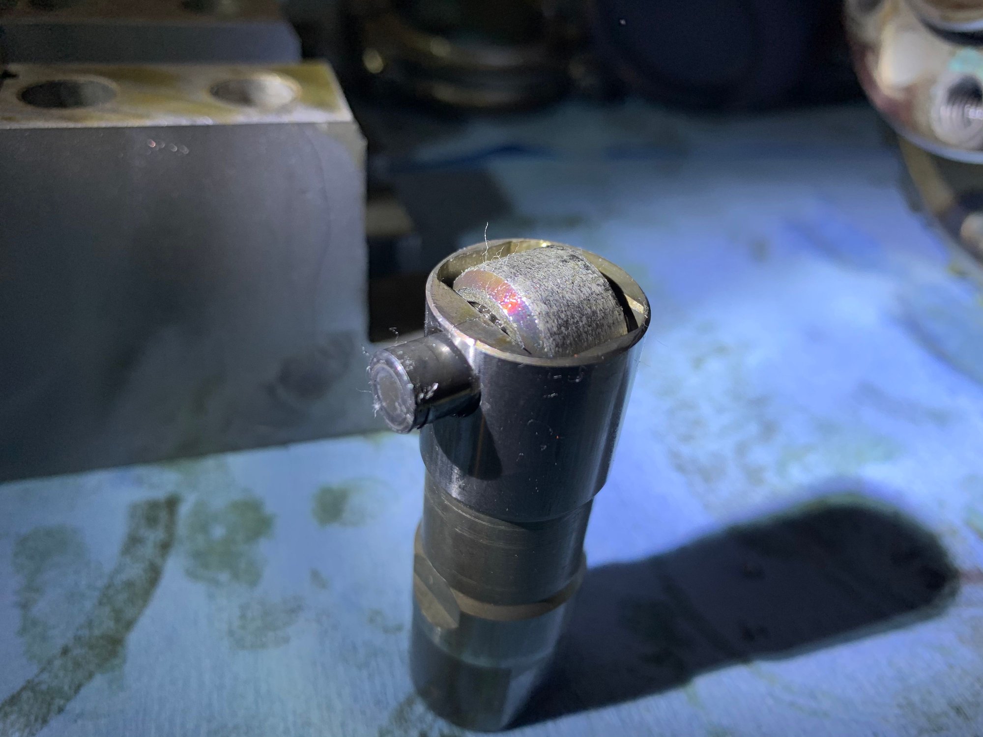

So a small update is this got delayed. The day before swapping to e85 and upping the boost I had a lifter failure. It’s almost back together now just waiting on a new clutch while I have the motor out. I was considering doing the 15” conversion but the clutch was not looking so awesome so that takes precedence.

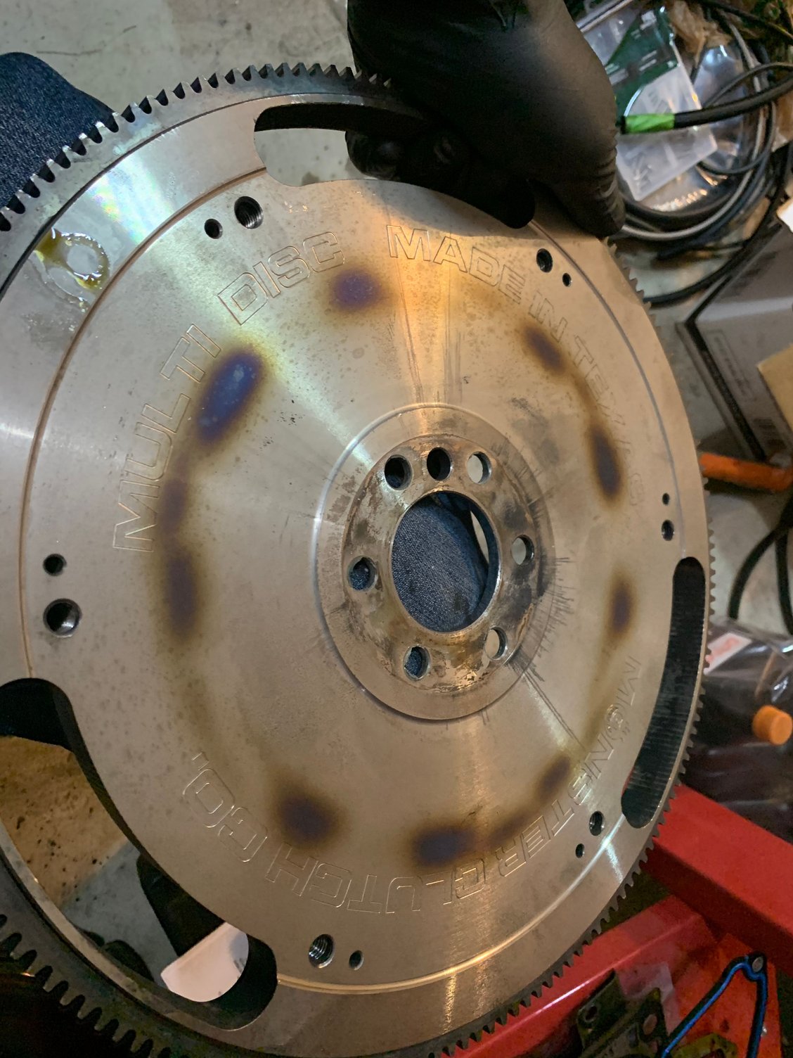

She was getting a little hot.

This is the lifter that failed.
A 15" setup can make it easier but again not absolutely necessary.
Sorry to hear about the lifter.
Just wondering, how's the cam look after that?

the cam on just that tip was a little jacked up. Went with a tsp cam this time. Thank you.
