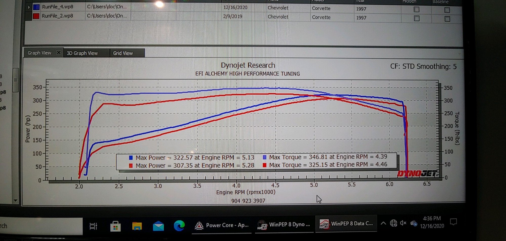

Good evening everyone
I am curious what my 97 A4 with 3.15 gears would run in the 1/4. The car has Texas speed 1 3/4 long tube headers 3 Inch catless x pipe and Billy boat bullet axle back. It also has blackwing filter ported TB and ls6 intake with both motor and trans tuned. Below is my dyno graph. Also I live in FL so Im right at sea level
I have not gone to the track with it because the closest track to me is 2hrs away and I don't to have some go wrong and then have it towed home lol. I'm sure there are several members here with the same mods that do run their car that can offer opinion. Thanks in advance

Im curious about this as well i have a 99 c5 3.15 gears and tsp headers. Is one without the tune and the higher numbers are tuned? You made that much torque at 2200 rpms? May i ask where you got the ported throttle body or how the port work was done? They opened up the beveled part?

No unfortunately I never got a base line pull to see what the car made completely stock. The 307rwhp is what it made with ls6 intake and zip tie mod and ported TB and tune. The 2nd graph is with headers and xpipe pipe and blackwing filter and tune.
To answer your other question. I ported the TB myself. It wasn't difficult to do.

So, headers/x-pipe and a black wing netted 15 hp? Am I reading this correctly?
As far as quarter times you’re looking at low 13’s. A Z06 cam would give you about a thousand more rpm and drop your et by a second, or more.
