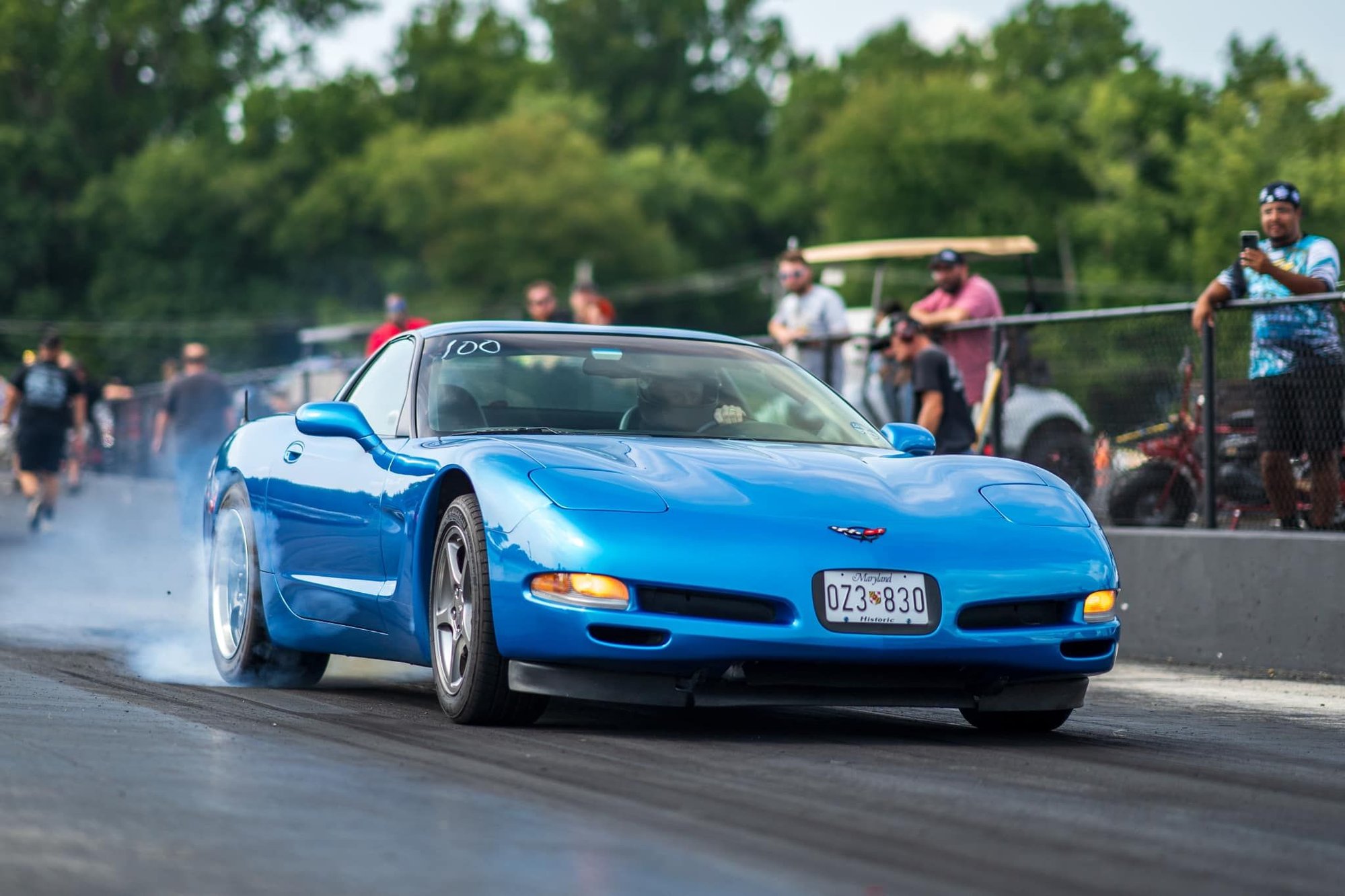

Hi all. Don’t post much but been on the board for a little over a year, gathering info as I learned more about the c5 I had just bought. I’m a longtime racer/builder of various projects but this is my first Corvette. When I bought it, it there were a lot of unknowns. I know someone has been in the motor, but I’m not completely sure exactly what/if anything was done, so I’ll only post what I know.

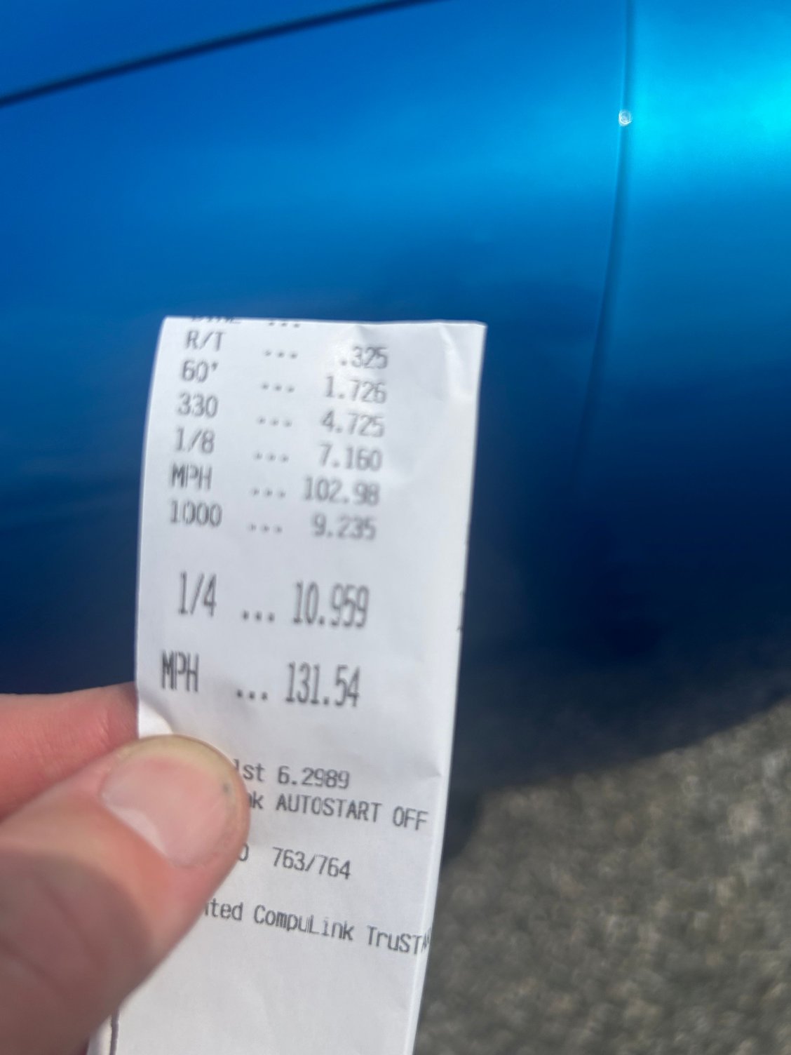

Took the car to Cecil County Dragway yesterday to get some tuning passes in and to test some of the recent changes made. Pretty happy with how it went but did discover my clutch is by far its biggest limiting factor. Regardless of what my left foot did, the clutch slipped its way to a 1.7 60 foot. Made 3 passes, went 11.09 @ 131.6, aborted the second pass when the car in the other lane made a move to the centerline, and then finished with a 10.95 @ 131.5 on a soft 1.72 60 foot. This was as I drove the car into the track after the 100 mile drive…still had my crap in it, some tools, etc. All I did was adjust tire pressure.
It’s still an LS1, believe it has a small cam in it, 241 heads, A&A V3 Ti with a 3.8” pulley, OBX headers and x pipe into a z06 titanium rear section, Chris1313 dual 450’s, Holley rails and 60lb injectors. It has 4.10’s in the diff and four year old Nitto 305/40/18 Drag Radials. The tune I built seems very safe based on plug reads and data logs. Plenty of fuel and soft on timing, which is how I want it.
As a new Corvette guy, I have to say I am so impressed with this thing. For what went into it, it’s damn quick, is comfy, handles, and generally does everything well. Just a fun car!
Now need to decide what to do with it next…

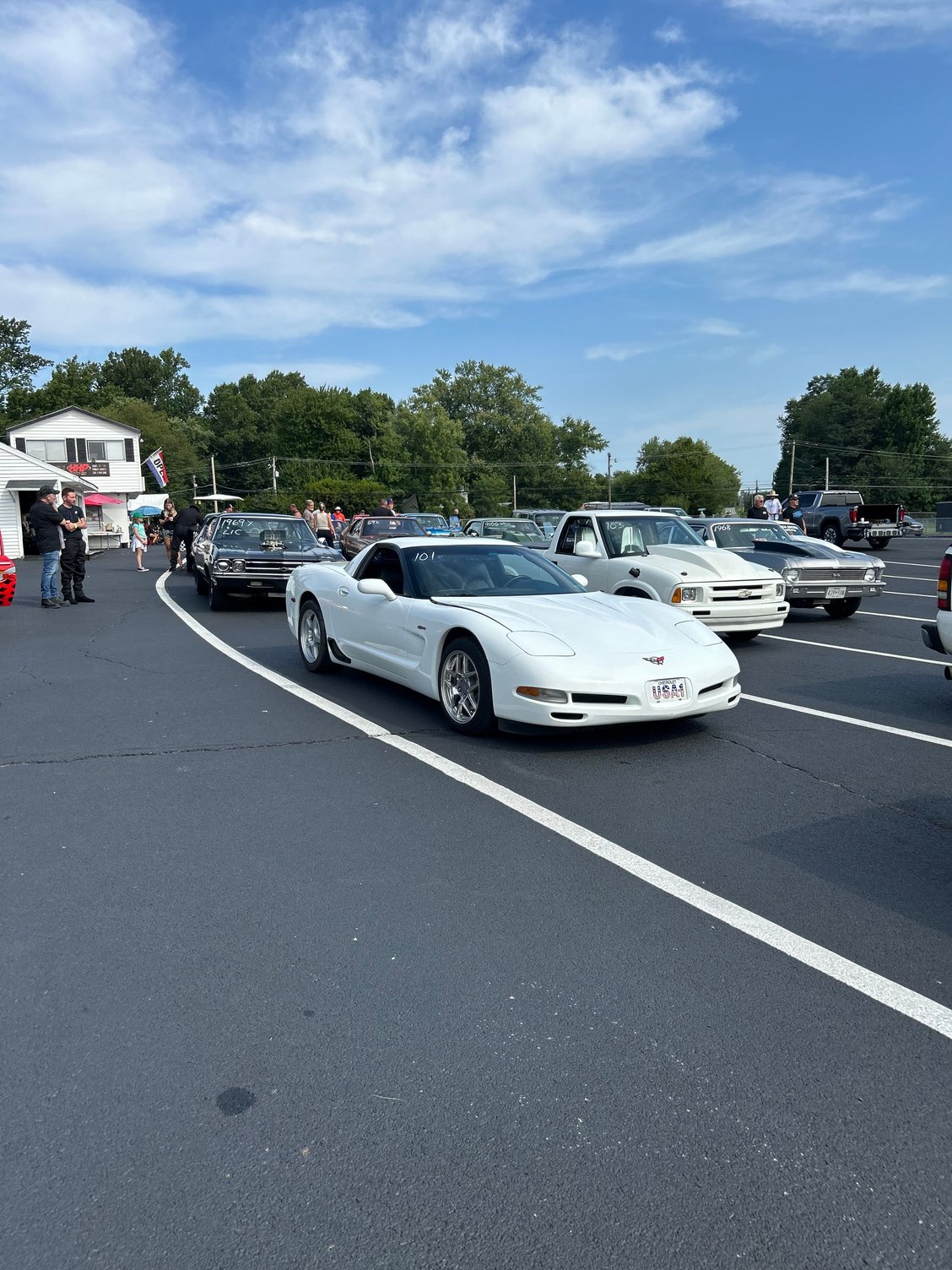

I chatted with your buddy in the White FRC a little bit.

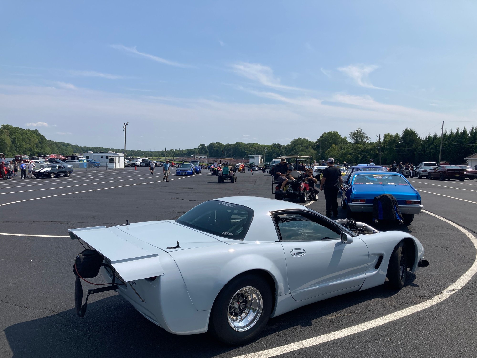

I guess we did chat! lol. I thought you were the guy with the white one, or perhaps it was both of you two.
I run No Time. It was my first full pass in the car since I built it. It’s been a long journey to get to this point. I was hoping to get more than one pass in yesterday, but I got there late.
Last full pass I made was in 2016. When it was still all motor 427.

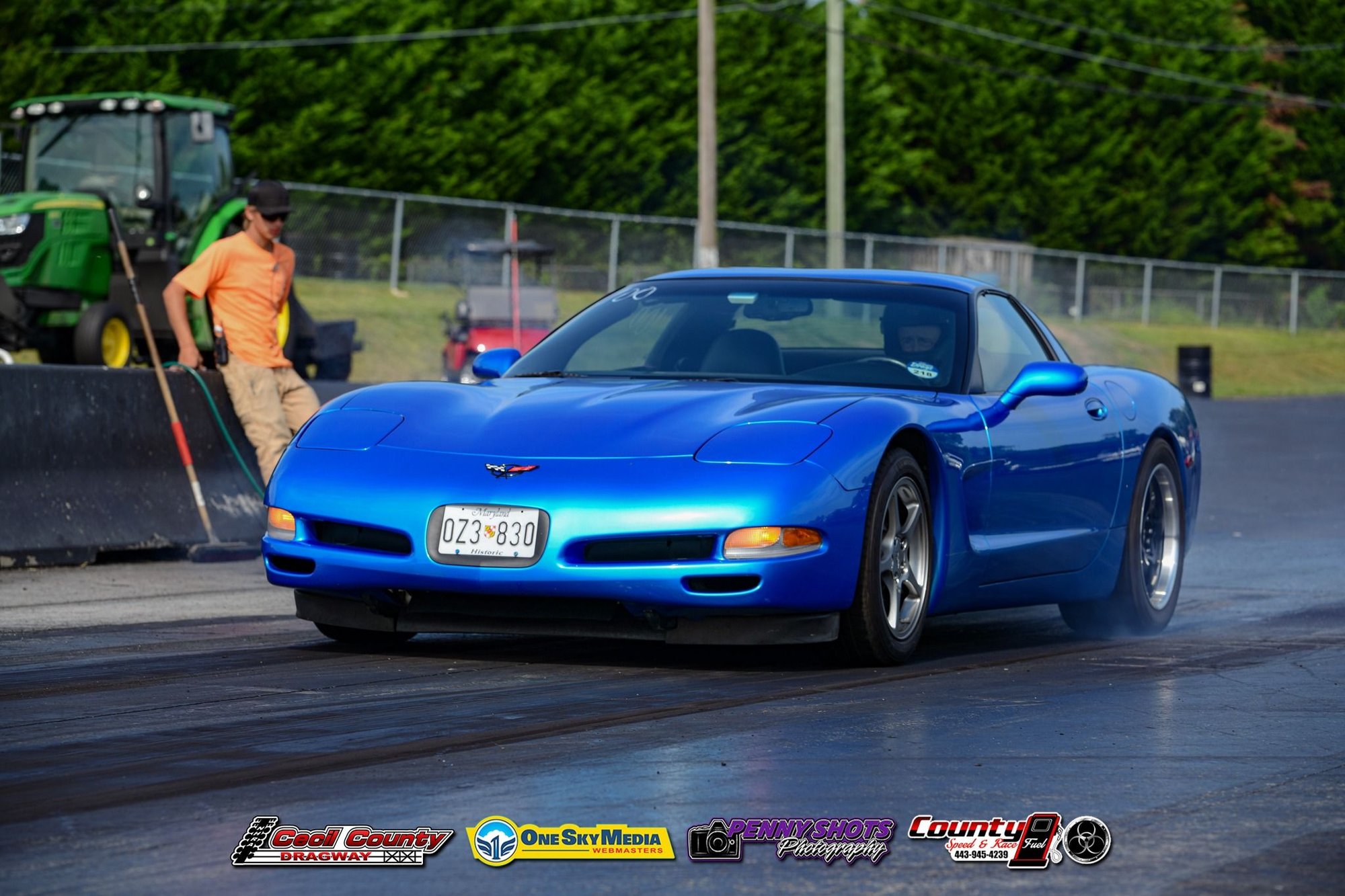

Look what I found…

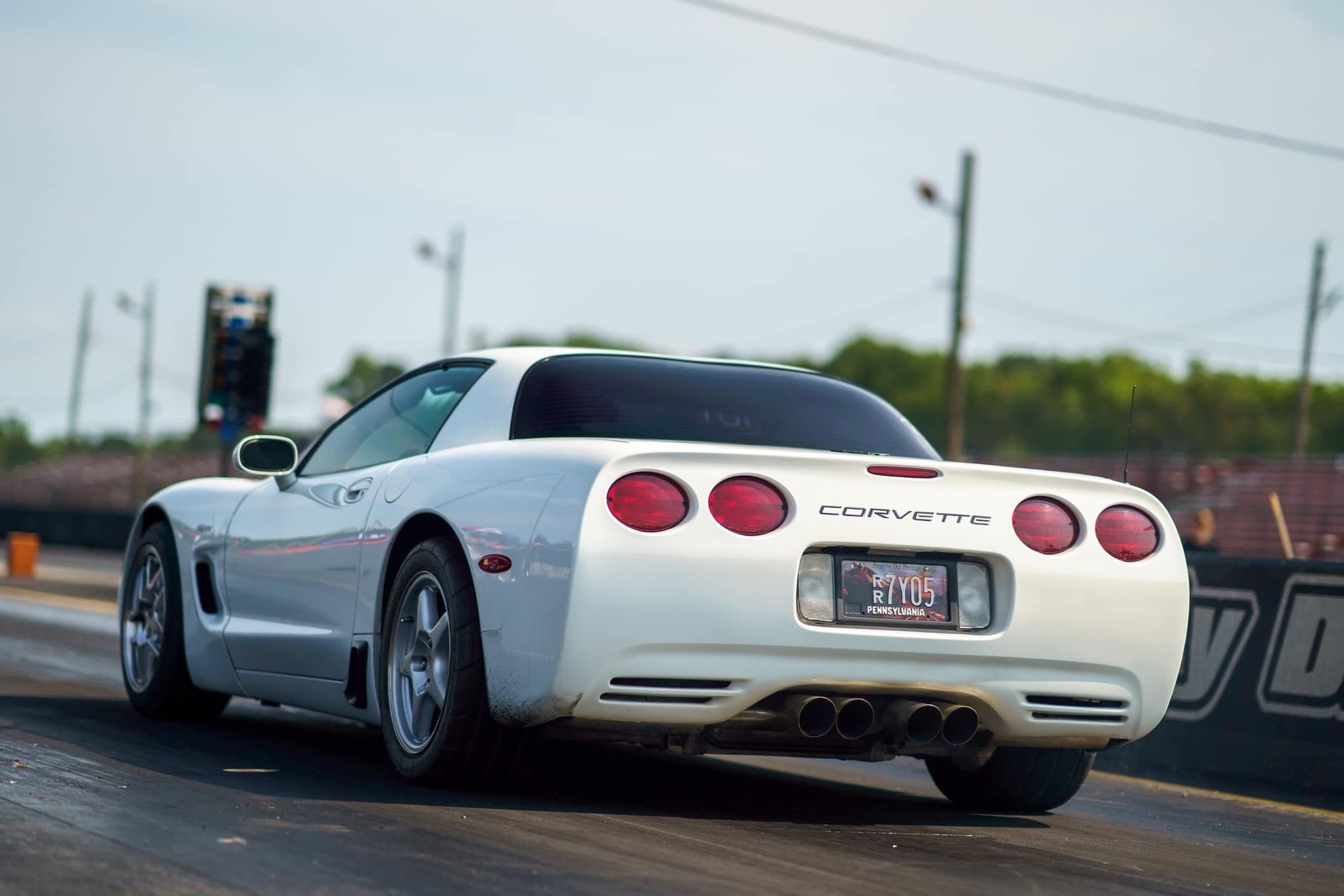

And, this…
