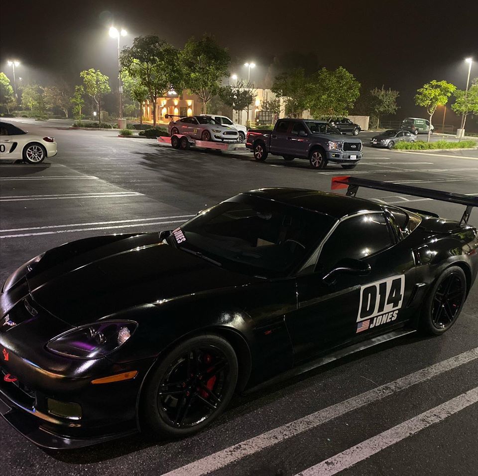

This is my setup. Steel 22' but the 4x8x3 box makes the deck equivalent to an 18', so close to your #2. I've had a C6Z on it, so it can handle the width and OE front spoiler. I don't have the removable fenders so, I have 1" thick plates that go under the back tires to raise the door enough to get out. To get it on and off, I run the rear tires on the tow vehicle up on ramps and then also need like a race ramp (I made homebuilt 2x12 steps) + the trailer ramps to get it on / off without scraping the spoiler (or high centering it) since the trailer deck is sort of high off the ground (even with the dovetail). So there is a small amount of additional labor involved. If the steel you are looking at, is anything like mine, the cost offset to the tilt may balance the ease of getting it on and off. But long story short, how you have the steel spec'd, it will work.

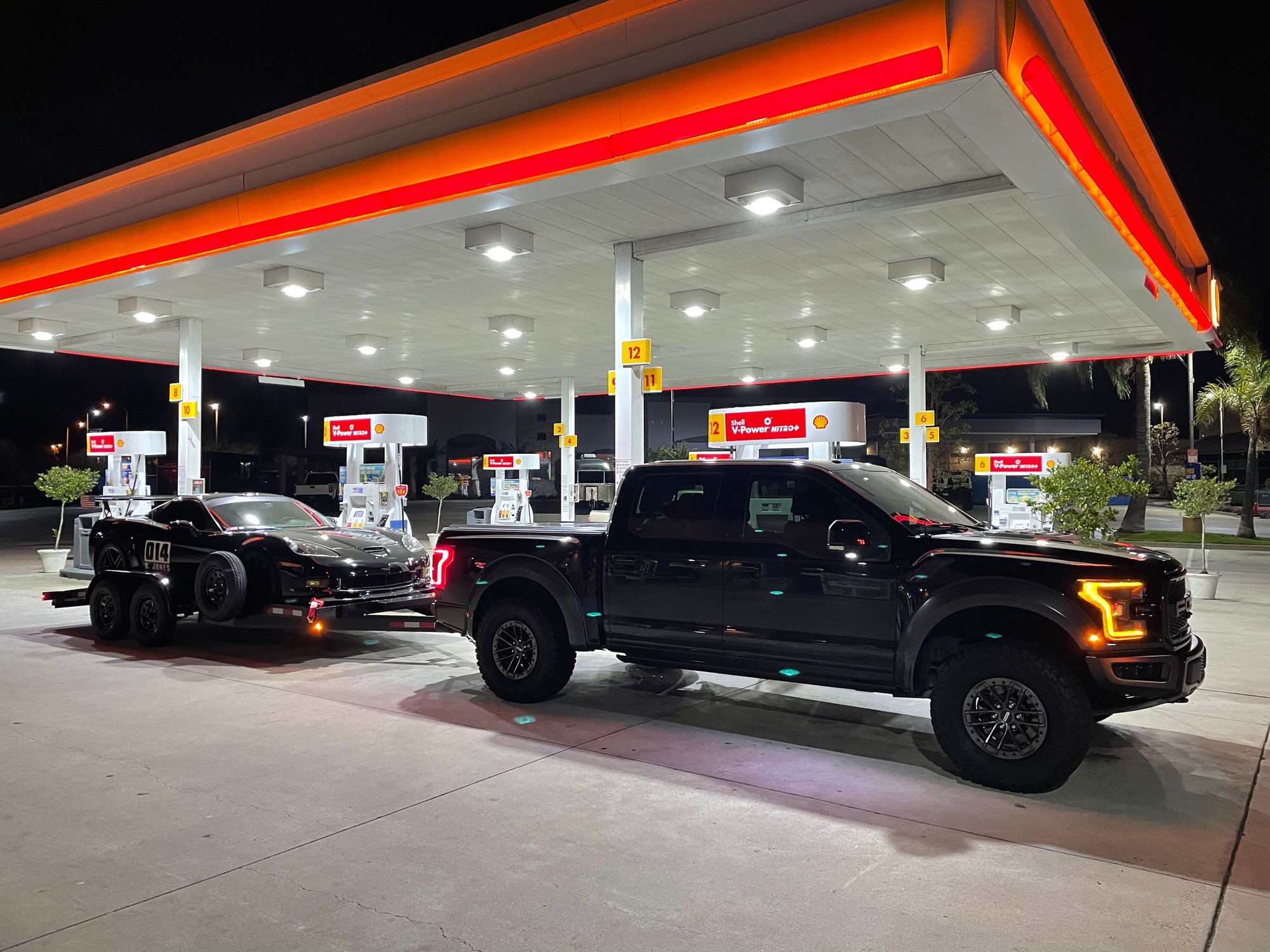

I ended up passing on the $13k alum trailer and went to a local shop to get one built to spec. It’s perfection.
16x8.5
dual axle
tilt fender
2’ dovetail
low deck
6’ ramps
led lights
winch plate (working on getting that setup)
I can get my car up without any fancy wood contraptions.
I timed the load time, 17 minutes total from ramp deployment to driving off.
It’s so nice to be able to drive to and from events in comfort!
