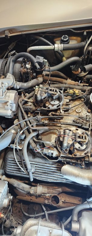

Missing vacuum hose from PCV valve does it get connected to the missing hose on the bottom of the picture?

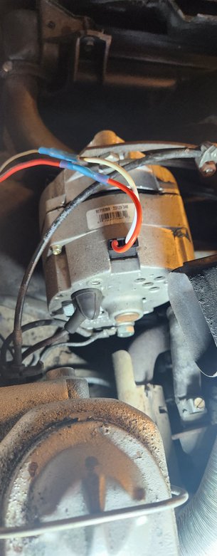

This is connected wrong. Terminal 1 should be the thinner wire going to the instrument panel
Plugged hose going to pcv valve.
After changing the plug the Parasitic drain no longer was there and its starting and charging ok.

I am awaiting going to test the vacuum line with smoke machine and I have changed the right side head light actuator. Its working fine now. Bought the vacuum line kit and will be changing it but I will test the lines first to see if there still is vacuum leak. Working on getting the EGR valve solenoid and replacing it with 95 Cadillac Deville Which I saw at Bits of Wisdon on you tube.
. Once replaced will report. I also damaged the knock sensor connector when it fell on the exhaust pipe and got melted. Ordered a replacement once both are connected hopefully some of the idle symptoms will go away. I was also losing power while driving in the side streets but now prior to losing the knock sensor connector it only happened after. Also when its cold start it starts right away but when its warmed up it hesitates to start but does start when i keep my gas pedal down.
Wires and plugs still remains to be changed.
