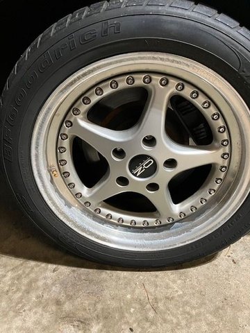

I know nothing about wheels……
Are those bolts for show or do they come off and can be replaced with a different color

That is a two or three piece wheel, the series of bolts hold them together. And yes, they can be replaced.

I'm like 90% sure those are OZ Mito's. I tried to get a set of them a few months back. You can replace the hardware and rebuild them kinda to the specs of your choosing.

I can’t find the outer ring

I have (4) OZ FITTIPALDI's
Still available, packed away as they wouldn't fit
around my new brakes.
https://www.corvetteforum.com/forums...aldi-rims.html
I'm ready to deal as they are just taking up garage space.
Ted
PS: And yes, they are (3) piece wheels. There is a special tool to fit the nuts. The pieces should also be sealed If opened or they might leak. Ask me how I know...
