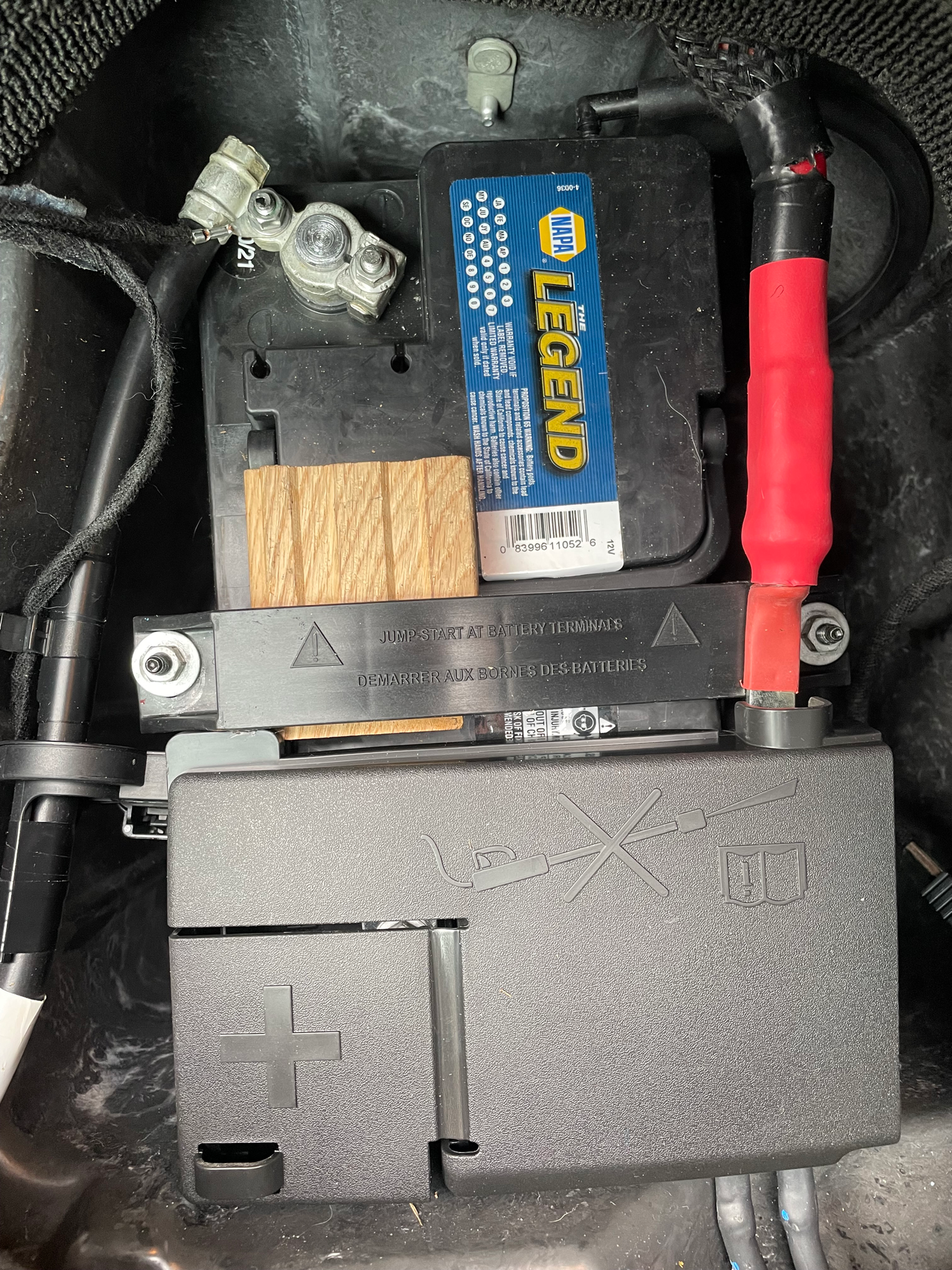

NAPA said this was the correct battery for the 2017 Stingray that I owned at the time. But once installed, it proved to be too short. So I added a block of wood to make the strap tight. When my 2018 Stingray needs a new battery, I will buy an OEM battery. I used a bungee cord under the old battery to lift it out.
