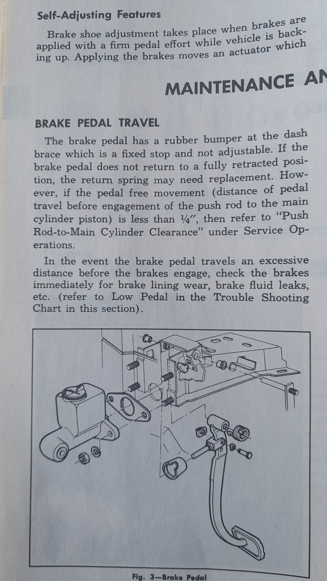

I could not find the Rod to Main Cylinder Clearance spec in the Service Operations section in the manual. But it looks like if you have at least 1/4" clearance your good to go. It did not say where or how to check the clearance.
