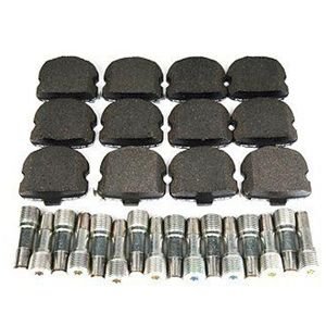

When searching for new brake pads, it's important to go with a set that are high quality, especially for a sports car. Cheap brake pads will not stop nearly as well, which could cause you to get into an accident. Ceramic pads are some of the best you can get due to their stopping power, low noise, and low dust generation. Other pad materials create a dark, sticky dust that will cling to your wheels and can make your car look pretty bad. Ceramic pads generate dust that is not only lighter in color, but also less clingy, so the dust that does stick is hardly noticeable.

There are a lot of mixed reviews on the Hawk ceramic brake pads, which is due to the squealing noise they have. While most ceramic pads are relatively quiet, these don't mate well with the OEM rotors and have a pretty high chance of producing a squealing sound. The harsh break-in process is another downer for these pads; it's extensive and not the best thing to do to your rotors. However, brake dust is minimal and the stopping power is pretty similar to the factory brake pads. Recommended if you are looking for minimal dust.
