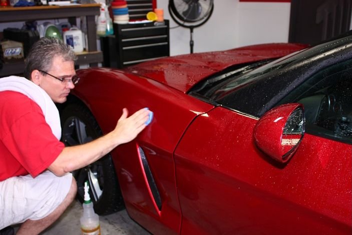

Step 1 – Use white vinegar
According to seasoned vehicle owners, once your black Corvette gets dotted with water spots, apply white vinegar on the spots immediately. Then wait for half a minute and wipe the spots with a white cloth. This way, it's easier to remove them before they harden and etch on the Corvette's surface, hence requiring buffing (which is pricier) or wet sanding (which is riskier if done badly).
