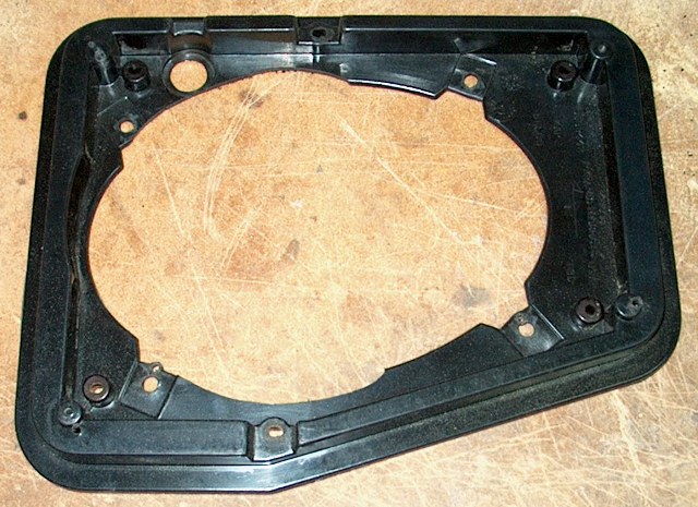

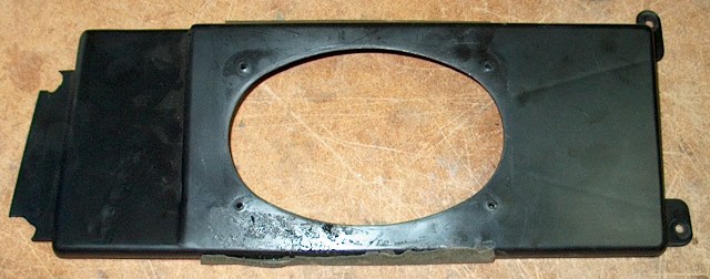

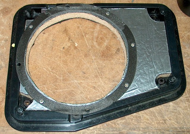

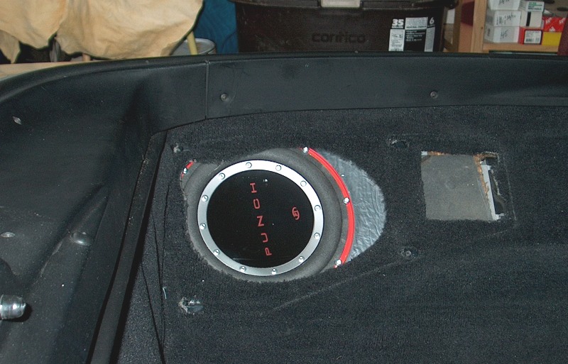

Here are some pics of the completed work so far (I promiss to do a full write-up when I'm done).
Here's the original front speaker mount:
And my modified mount reinstalled (also note the amp power wire entering the car):
The rear stock speaker mount:
The modified mount (3/4" MDF shelf board fitted into the stock mount's recess and covered both sides with edead):
And installed to stock location (the original cover fits perfectly):
