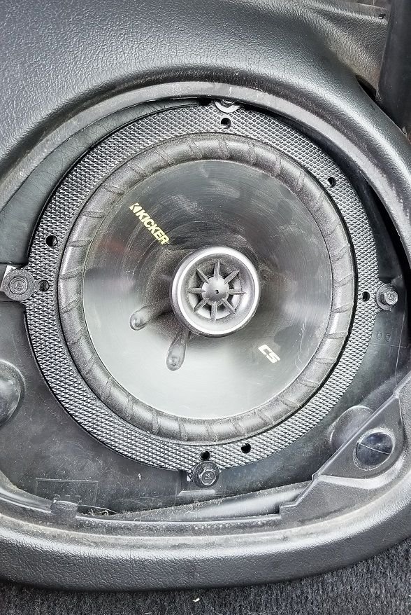

This is an old thread, but I thought I’d share a tip that worked for me. I swapped in a set of speakers I found in my garage, and agree with the 10:30 position on the fader.
After trial & error on the first side, I finally found a method that allowed me to install a speaker on the other side in 20 minutes start to finish with all 4 screws!

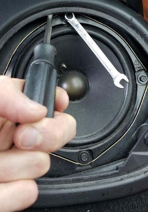

Use a flathead screwdriver to "lift" the panel so you can access that top screw with a wrench for removal. Then, for install, I have slotted holes on my aftermarket speaker, so hand starting the screw (again, using a flathead to create extra space) allowed me to slip the speaker in then tighten after.
I wouldn't say this was a significant upgrade, but I'm happy with the result since it was only a little work (did this on my lunch break) and zero dollars out of pocket.

So the speaker grill just pulls out? I was thinking the whole 1/4 panel trim piece needed to be removed.
Did you just pry it out?

This may already be known but yes, the rear mesh covers can be removed without the whole plastic panel. Gently pry on upper corners and middle, they should pop out. If you want to remove plastic body panels, I highly recommend getting a panel puller tool set - I got one on Amazon for pretty cheap and it helps greatly compared to a flathead screwdriver (which can damage things).
