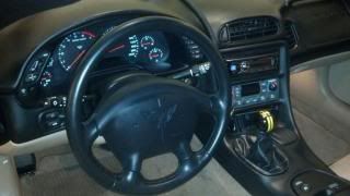

So I am attempting to install a single DIN Alpine HU in my C5 today - all was going well until I tried to put the new HU in and it won't fit - I can't manage to get it to go back all the way in - It seems to want to stop with about an extra inch sticking out - not sure if I am bumping up against the metal bracket in the back or not. Anybody know what I am doing wrong here?
I posted a pic below - Sorry for the crappy quality...
Any input you can provide would be greatly appreciated

Cut the metal bracket

This is the direction I was thinking I would need to go - is this normal?

Yes, it's normal. I didn't want to cut mine because I once thought I might want to return the car to 'stock' after I was done. So I cut the bracket off but purchased a new metal 'cage' that is part of the dash to replace it in the future.
My C5 is long gone, but that dang cage is still in my garage...

great, thanks guys - pulling out the dremel now...

Worked like champ - thanks!!!
