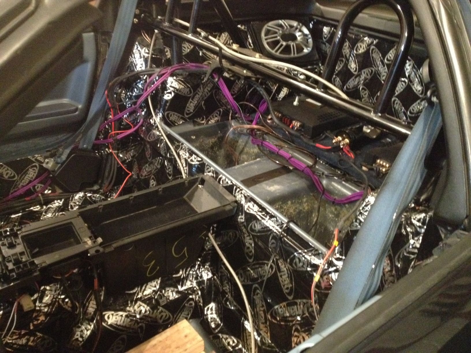

Before I converted the interior from blue to black I covered 100% of all panels with Dynamat and Dynaliner. Areas of the inner door I could not reach were sprayed with Boom Mat. The attached picture shows what almost $600 looks like under the new carpet......

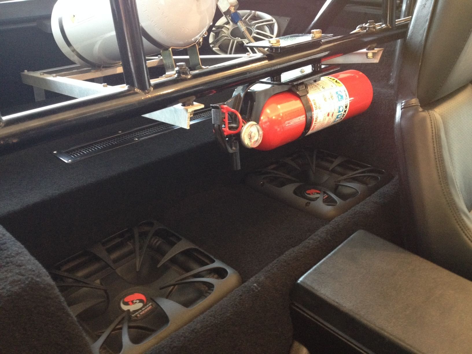

For the two Kicker L5's:
  • I first glassed the storage bins
  • Lined them with both Dunamat and Dynaliner
  • Made a 3/4" MDF mounting base
  • Covered both top and bottom of mounting base with Dynamat
  • Silicone caulked and screwed MDF base down
  • Half filled the enclosures with poly fill
  • Mounted Kickers for an air tight seal
I had to turn the JBL amp down by over 50%. Good gosh these things hit hard
