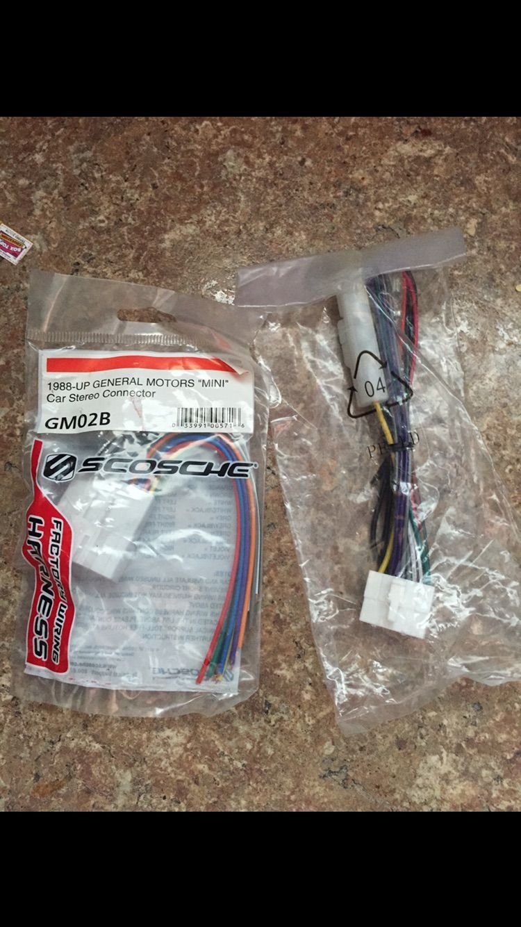

I have a 2000 model with Bose CD player. I am removing all speakers and head unit. When I am hooking up the new CD player, do I need the harness that connects to the old CD player? Most installs that all you do and your done but since I am running new speaker wires I wasn't sure. All I think I need is accessory and ground for the head unit right? Do I need to connect my scosh harness as well? Sorry if this doesn't make since.

Here is a quick picture of my head unit plug and my adapter harness

If you're replacing everything all you need is B+, ground, and switched power. Switched isn't in the stock radio harness, so I'd just get all 3 in the footwell on the accessory pigtail.

Exactly what I needed to know. Guess the harness can go back!

If you want to you can use the harness and connect B+ thru the stock Radio fuse instead of C/LTR in the footwell, otherwise not much use for it.
