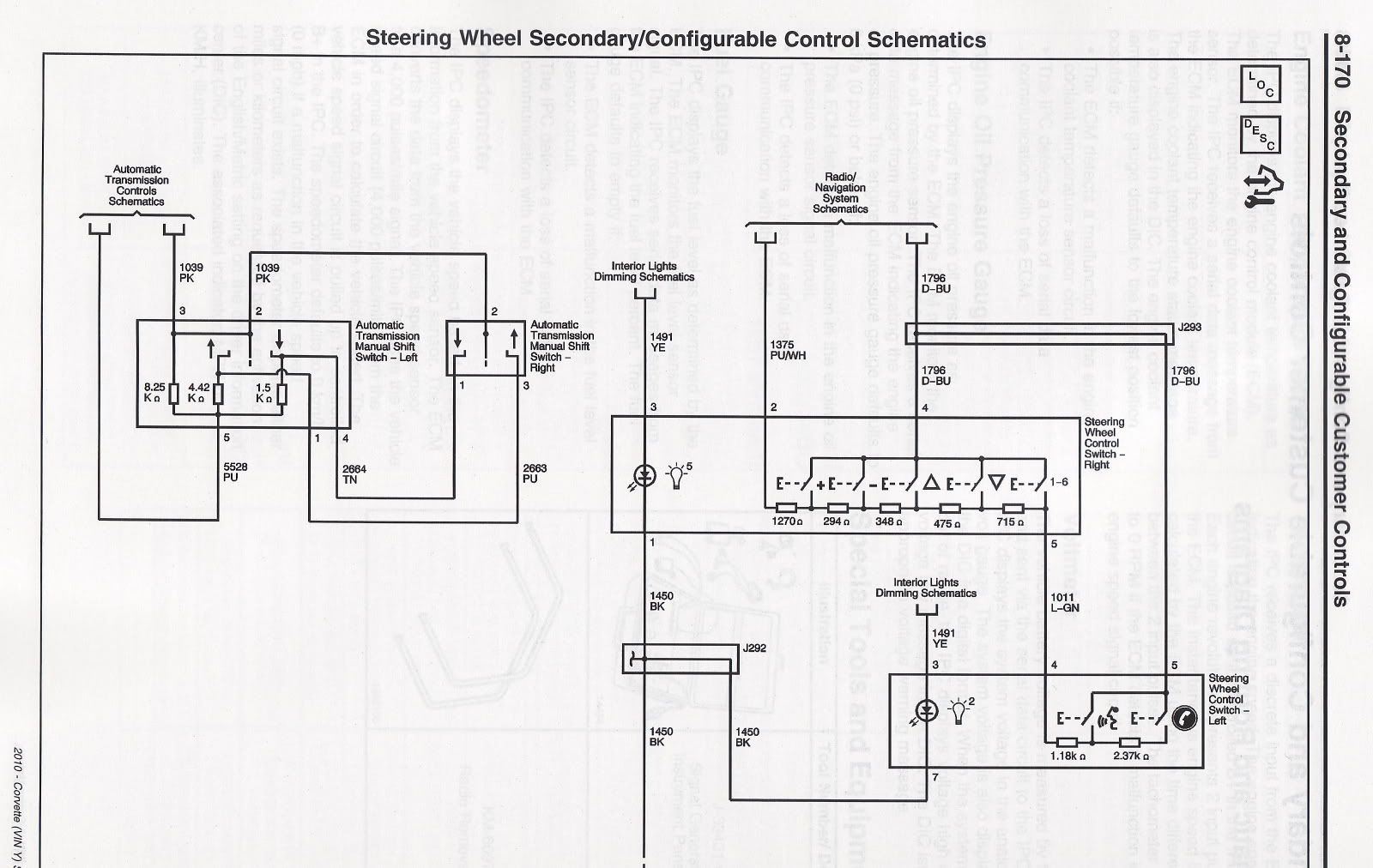

My 2012 C6 steering wheel volume up control does not increase the volume it is decreasing it. The volume down is working properly. This is a Bose system. Is there a reset to the system??
any thoughts thanks Kenny

The + button should show the radio 1270 ohms, the - button should show 1564 ohms (1270 + 294). Sounds like the + button is making both contacts.
Try popping out the airbag and using canned air to blow off under the buttons, you may get lucky.
