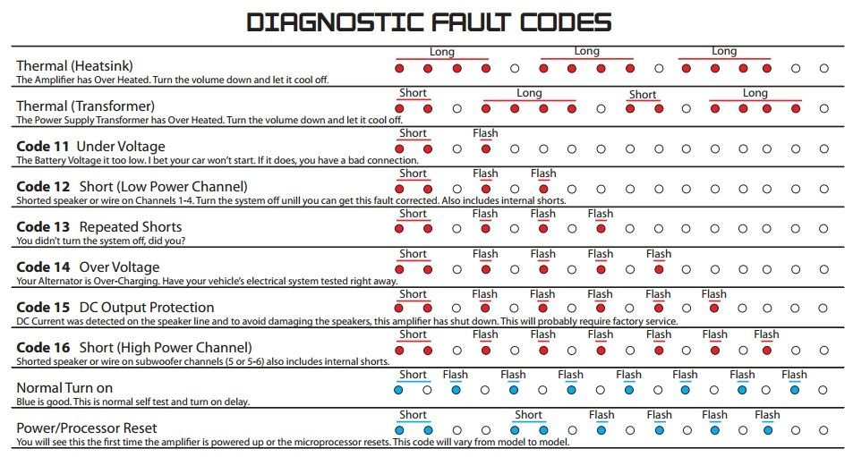

Look at the amp when it's cut out. If it's completely dead you're prob losing trigger voltage (common issue with some interface adapters).
If it's in some sort of protection mode this chart will tell you the issue.
When it cuts out, the power LED goes out.
