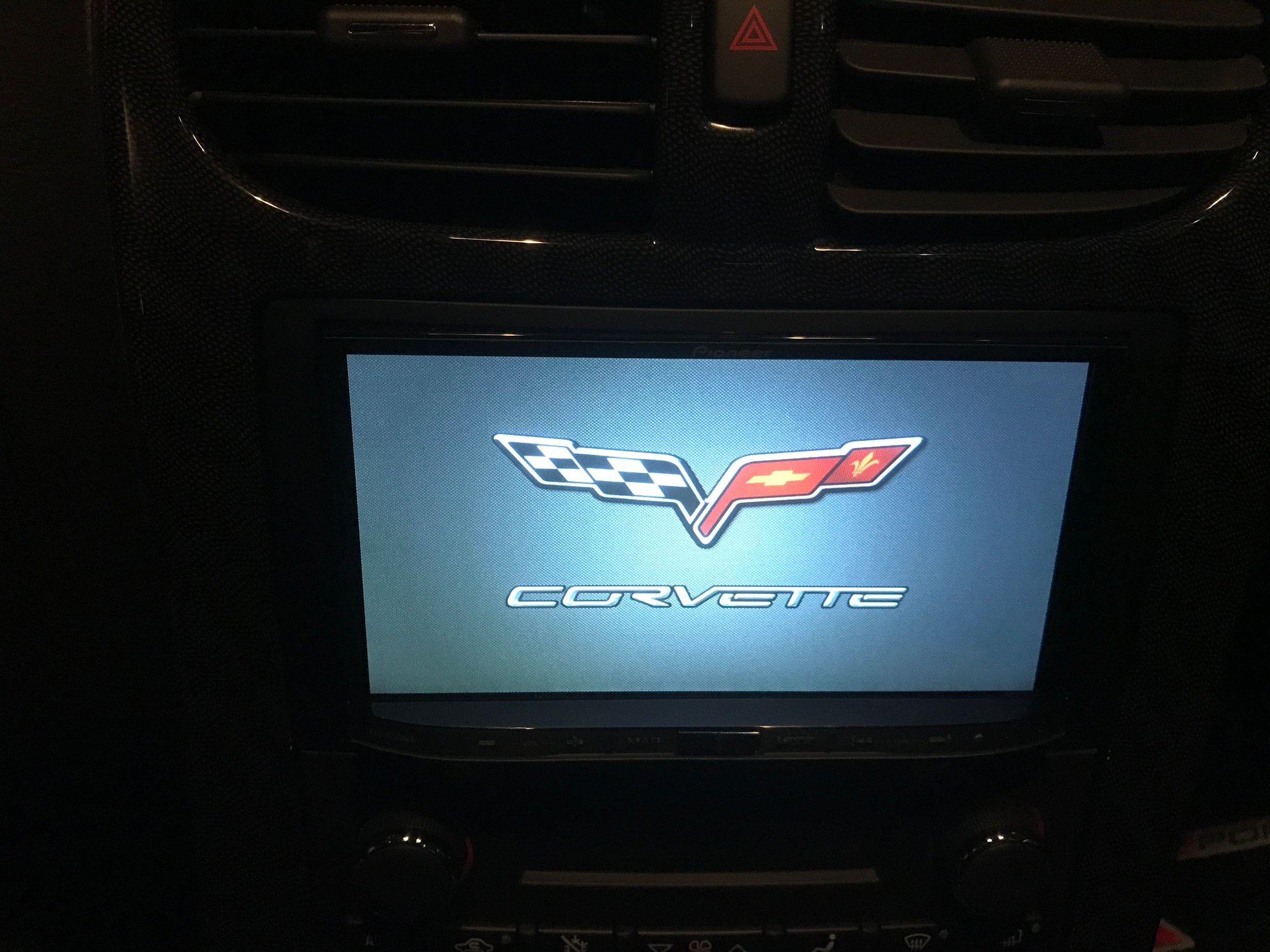

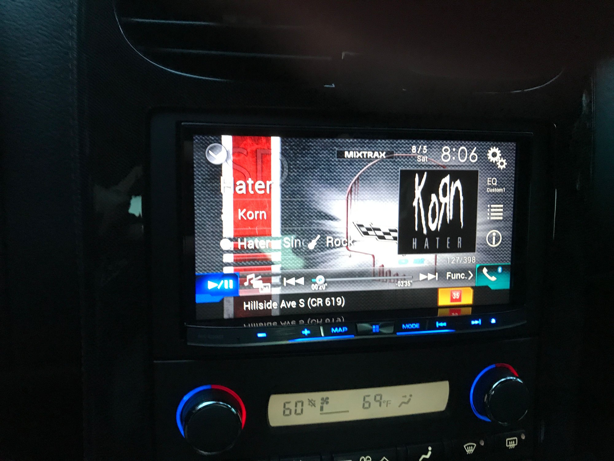

Just to give you an idea of what an aftermarket unit looks like installed, here is a picture of my Pioneer. If you are changing the head unit you may also want to consider a back up camera. This particular unit is a little pricier than what you are budgeting.
