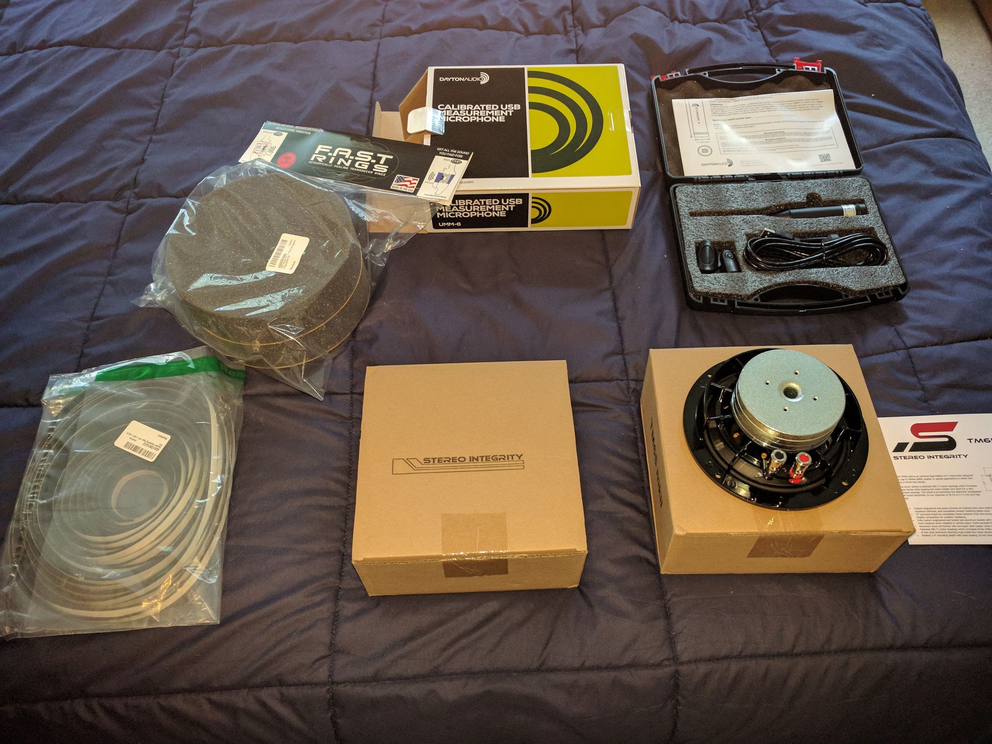

Just back from driving across the country, from San Francisco to Daytona Beach.
Amazon delivered.
Stereo Integrity 6.5" MKII midrange speakers.
Gasket tape
Fast Rings
Dayton Audio UMM-6 microphone

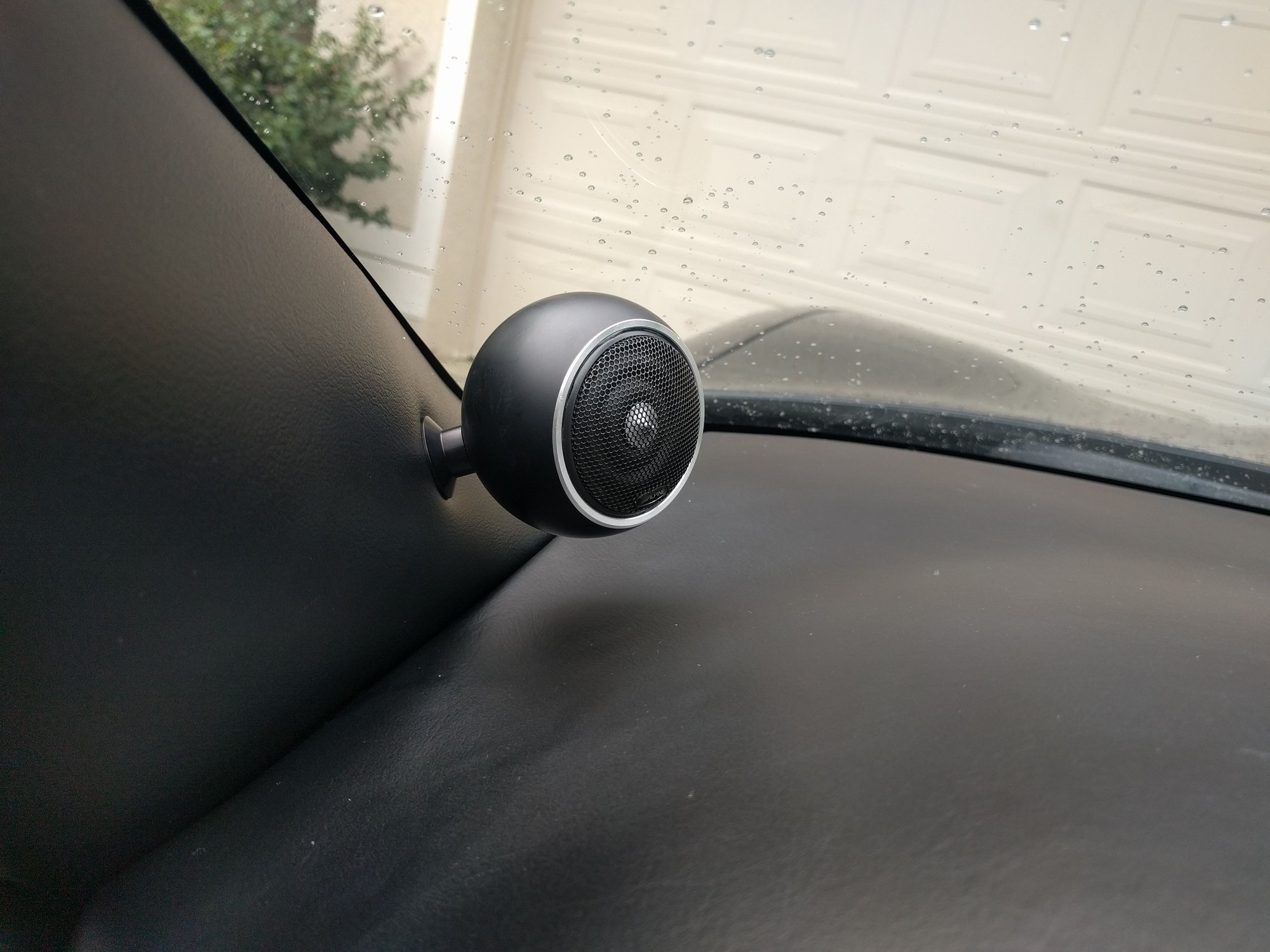

FWIW, I am running Alpine Type X tweeters.
Active Crossovers of 60hz to 3.15khz for mids, 3.15k and up for tweeters.

i have a pair of the type x tweeters here. it's a cheap typhany ring radiator. it's not terrible. i kept them for a future work truck install. it's okay. no where near as good as the mt230 in the hybrid set however. it's maybe on the same level as a JL c3. you HAVE to cross them at 3200-3500hz as they break up badly under 3k and power handling goes down

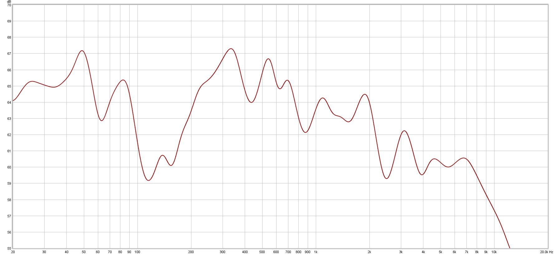

If I told you no subwoofer, would you believe me? Check the db range too

Wow that baby gets down there and you have a nice dip at the best spot, in that aggravating 120 hz neighborhood that tends to be dominant in an auto environment.

Update: I overpowered my Alpine tweeters. I upgraded. I ordered a pair of Audiofrog GS10 tweeters. I can't wait to hear them. They should fit the German pods. See that dip above at 2khz for the mids. Well, I hope to solve that with these tweeters.
