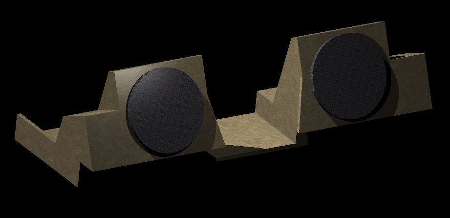

I had toyed with the idea for a while, came up with this...
All the shape weirdness comes from top clearance. It's designed around the Earthquake SWS-10 ultra shallow sub. It was still a challenge getting the appropriate air volume and basket clearance, and a shallow 8" sub might yet be a better choice overall.
I saw another guy here who mounted a sub and box into the back wall of the cargo area, extending into the rear fascia somehow...
