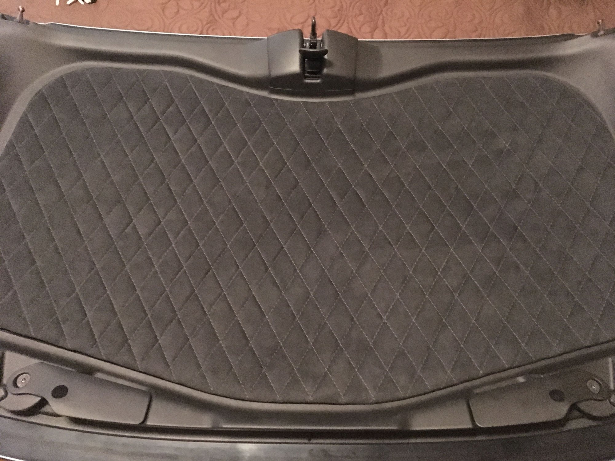

It is glued down very effectively on the coupe's hard top. I had to tear mine off and then used dental floss to get off whatever was left. I purchased a new one for ~$100 and my upholsterer used it as a template to make an alcantara one for me.
Here is a pic of it just laying in place. It is not yet glued down.
