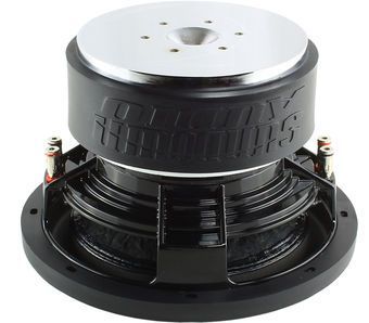

I've got an entire system I can sell you. I'm trading my car in and going back to stock. It's still in the car but I can have it removed quickly.
Pioneer 4200nex
Hertz Mille Pro 6.5" component front speakers
Audison Prima APX5. 5.25"rear speakers
Hertz HDP4 1000w amp for the fronts and sub
Hertz HCP2 400W amp for the rears
Both amps are very compact and can both fit behind your passenger seat.
Vettenuts corner sub box with an Image Dynamics IDQ 10" subwoofer. It fits in the driver's side cubby hole and won't interfere with your top.
These components were over 2500 new and they've been in my car for about 8 months. These are all higher end components and sound amazing. I'd sell it all for $1200 shipped

UmcanesZ06- Would you consider selling the sub box separate?

How much with out the sub? I have a zr1. That sub is a no go. Looks like a potential buyer for the sub above.

$1000. I've got a sub and box for a zr1 too. Its a Sundown Audio SA10. It's a great sub, in a box that was made specifically for it. I'd include it for the $1300.
