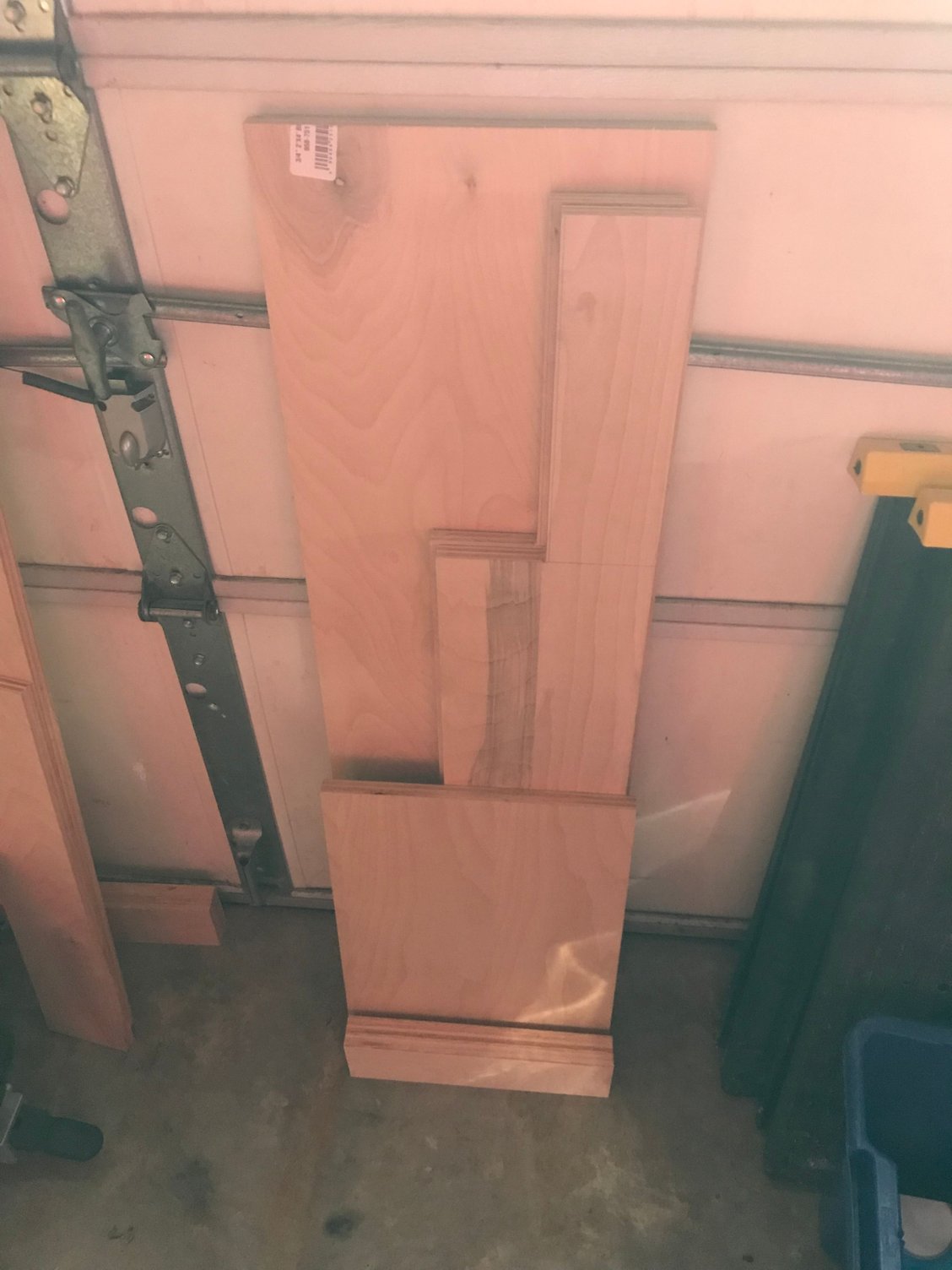

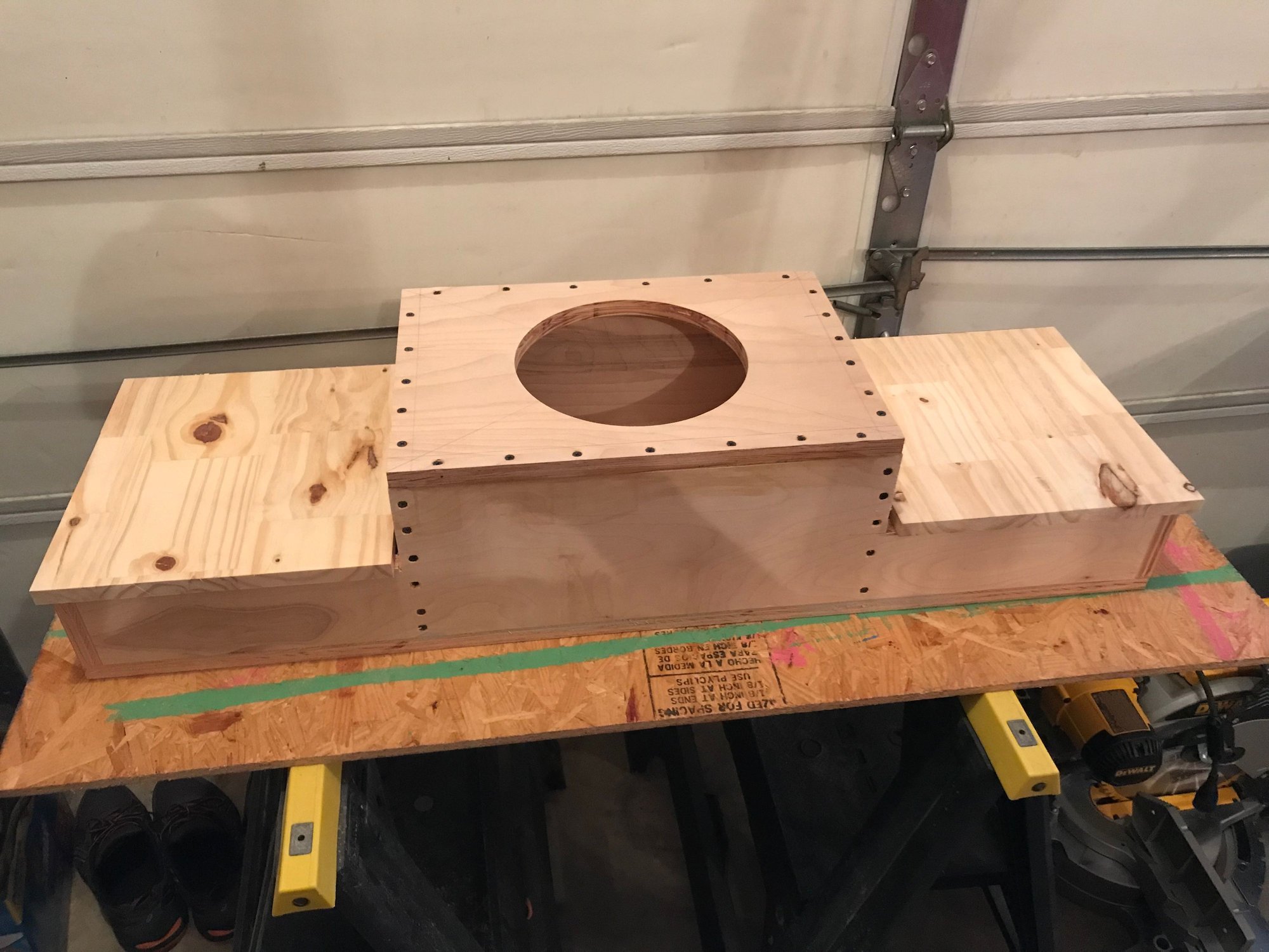

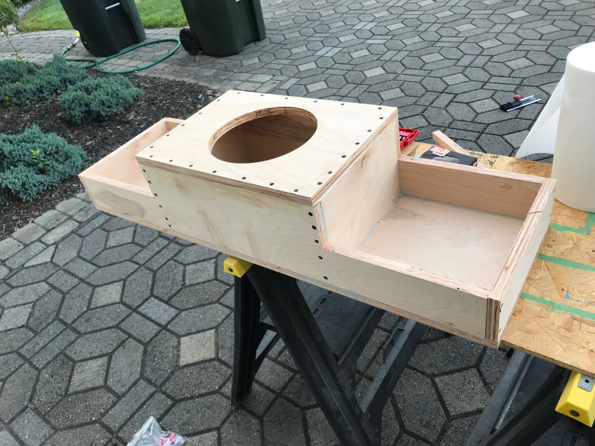

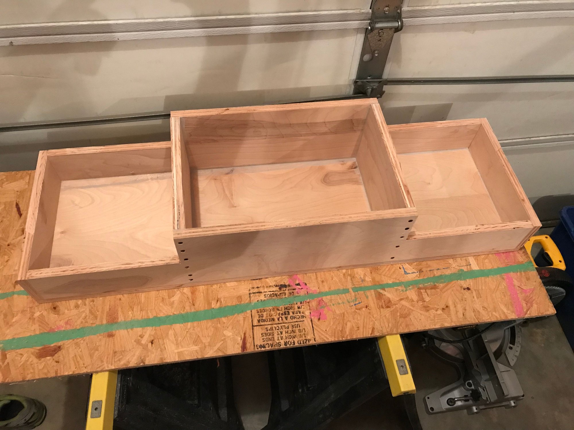

My latest audio project, building a subwoofer box to house a JL 10W6v3. I ordered a 10W6v3 sub that I'm still waiting on. Also waiting on carpeting to complete the box. Material is 3/4" birch plywood. I wasn't planning on doing it myself but figured what the hell. I never can seem to find anyone to do good work at a reasonable price so I decided to try and tackle this myself. The W6 will go in the center box with 2 storage cubbies on the sides. I used liquid nails and a bunch of screws to make it as solid as possible.
Internal air space is .75 cu. ft.​ while empty​​​​​​. The sub uses .08 cu ft of space, so the end result will be about .67 cu. ft. of air in the box which is a little more than what JL asks for. JL's specs ask for a box with .63 cu. ft. empty, which comes out to .55 cu. ft. with the sub installed.
This is the first time I have attempted to build a sub box, so hopefully the end results will be worth it. I enjoy seeing new threads in the audio section so I figured I would share in case anyone is interested. Feedback or suggestions are appreciated.

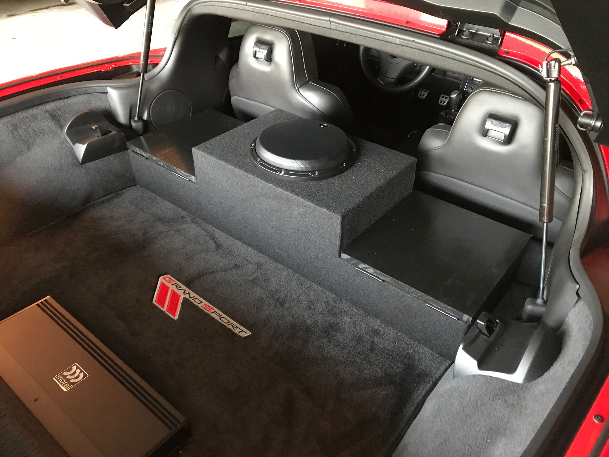

Finished the box and installed it. As you can see, I stained the cubby doors. I'm not sure if I'm going to leave them like that or end up carpeting them. I figured I would leave it for now and decide later. The sub sounds great. I only got to mess with it for a little while before I ran out of time.

Looks good! I guess you could mount the amp to the back if you wanted to. Interested in seeing if the box should of been slanted towards the back some vs straight up.
I thought about incorporating the amp with the box build but I was reluctant to redo so much of my wiring since I just made some adjustments to include a DSP and all the wiring is measured and neatly tucked away.
Slanting the sub sub towards the back slightly would of been more ideal and if I was having someone build it, I would of done it that way and made it less boxy looking also. But since I did the build myself, I tried to keep it as simple as possible to compliment my limited skill set.
