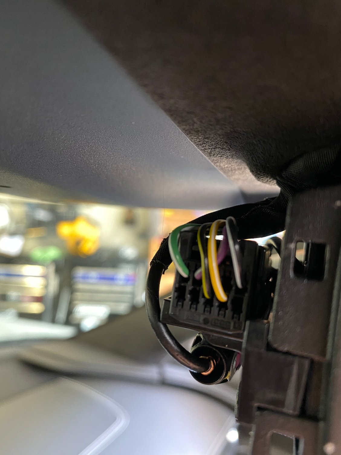

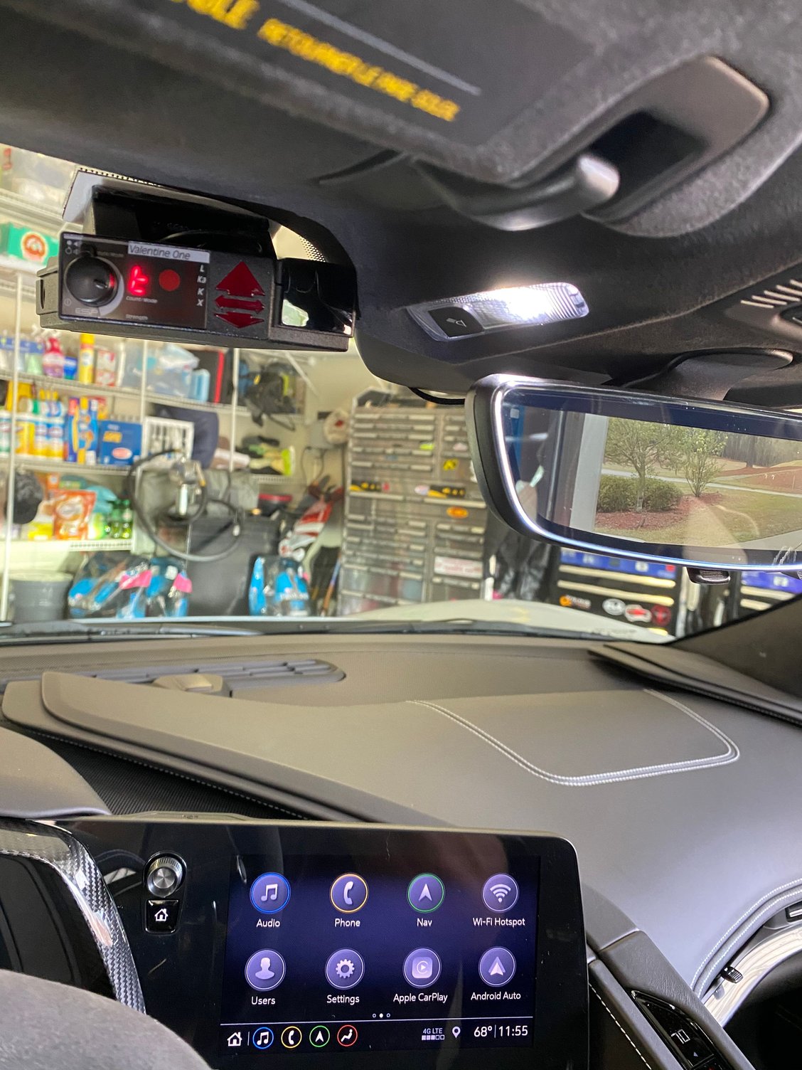

It’s easy to run power behind the mirror. Remove the back cover, run switched power wire to the purple with white stripe and ground wire to black with white stripe. I power a V1 with RJ11 invisacord or similar purchased from Amazon. Whole process takes about 10 minutes.

2020VSN, where did you get that mount for the V1?

I ordered a kit from Amazon. It’s actually the suction cup mount that came with the detector. The kit...around $10 is just a flat piece of metal that attaches to the mount to allow use of velcro or double sided mounting tape in place of the suction cups. It works great and never comes off

Is your Invisicord fused, and what length is it? Tia.

This one doesn’t have an in-line fuse but you can get them with one. The cord I used is 14” long

2020 VSN did you have to modify the pins before sticking them into the back of the plug in anyway and was it a tight fit when you put the cover back on?

No modification to the plugs and no issues re-installing the cover. It’s an easy 10 minute job.
