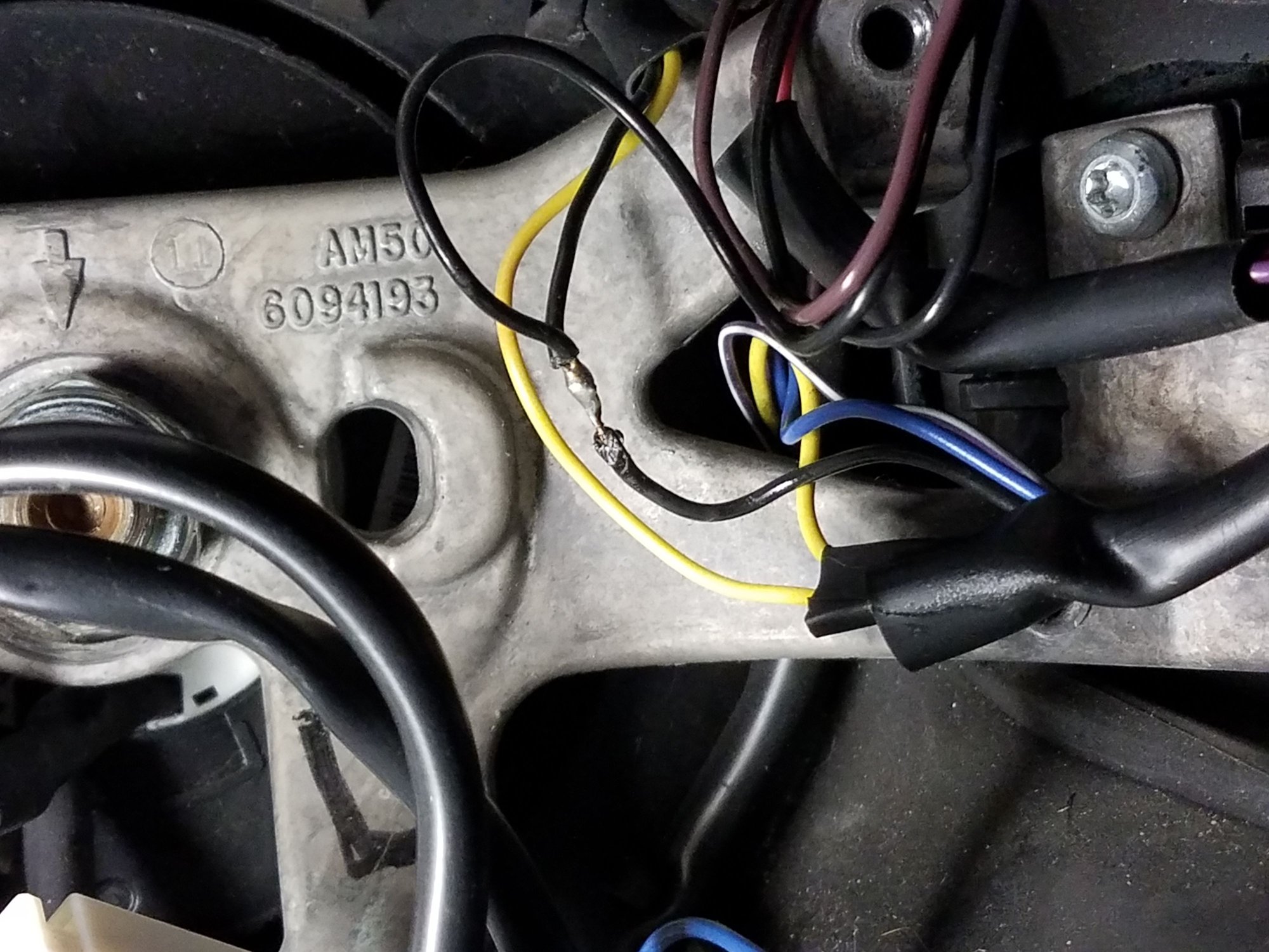

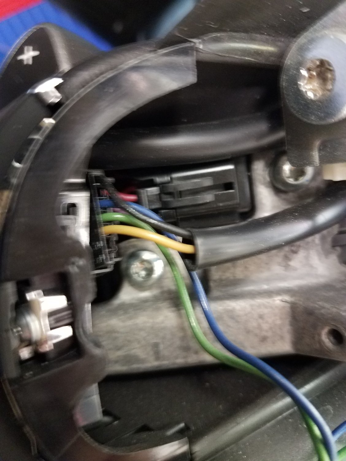

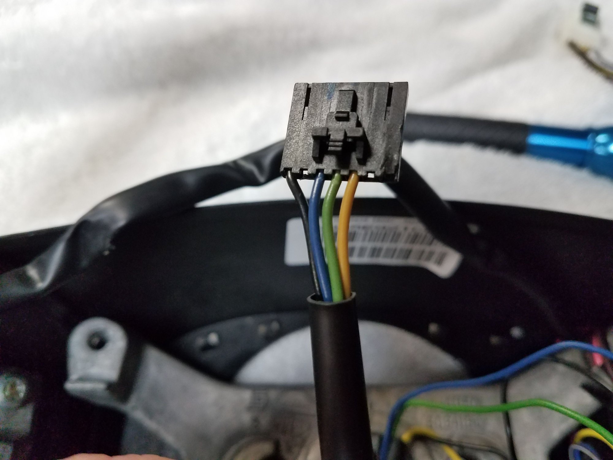

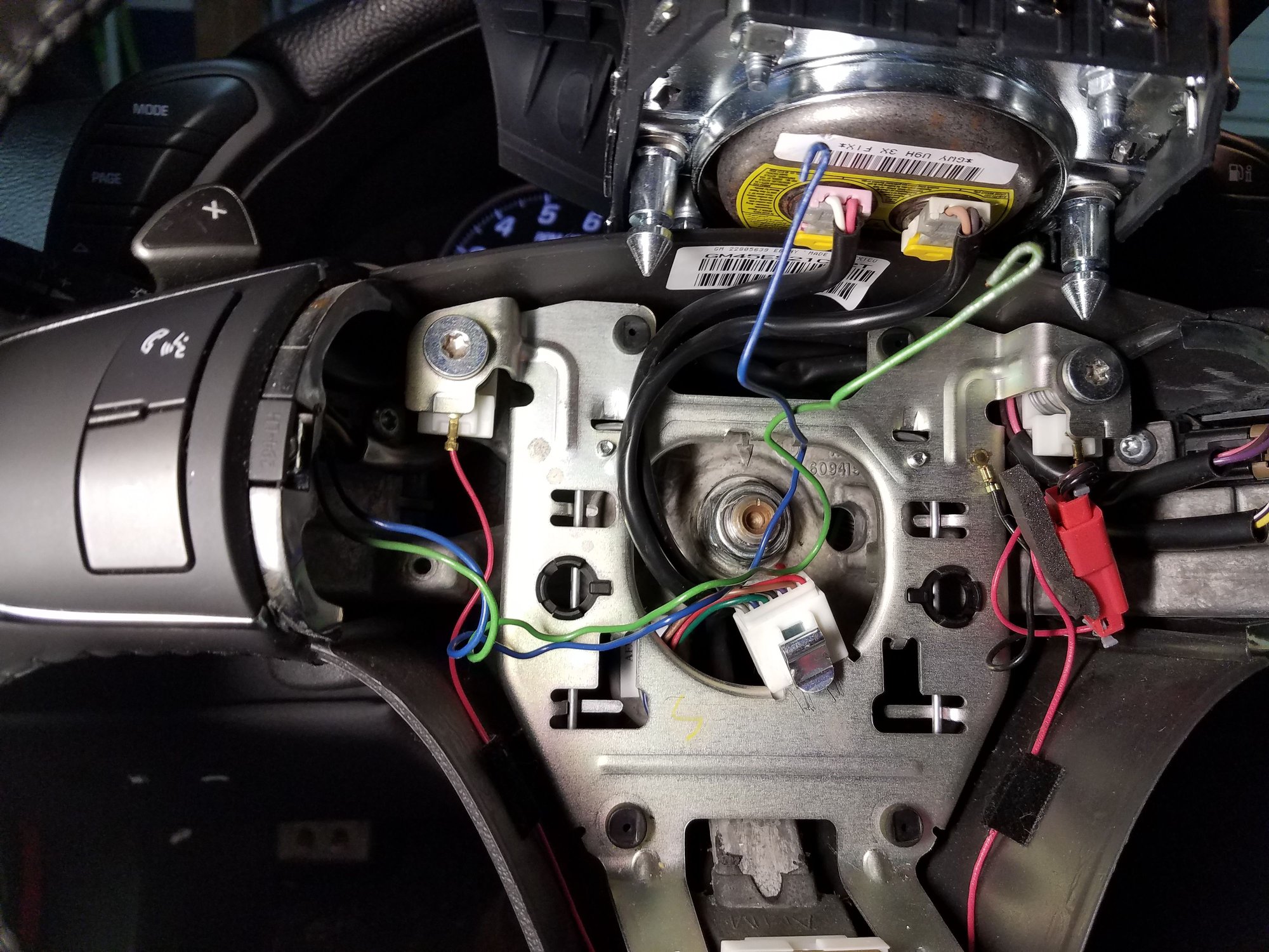

OK so these are the two wires Blue & Green I need to find where they go. When I bought the steering wheel it was like this.

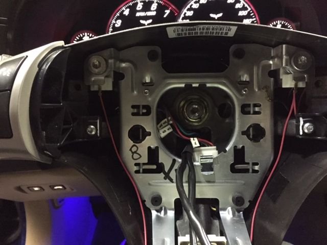

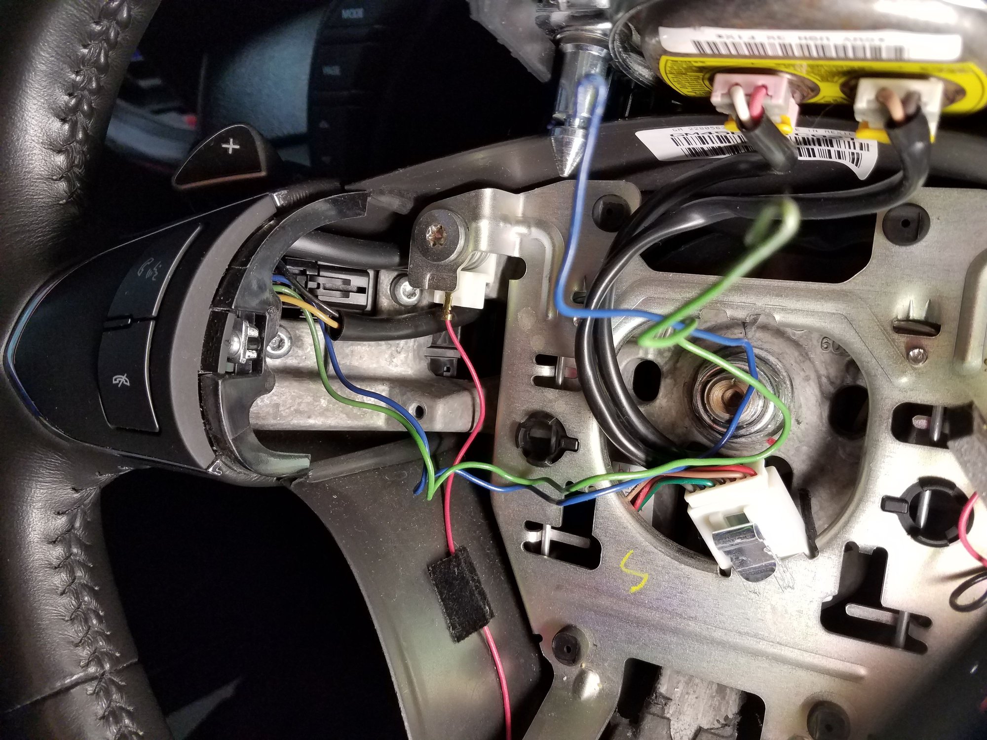

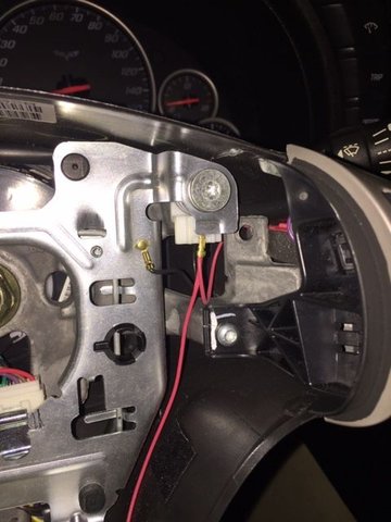

Did your car come with SWC on the right side? Here are a few pics from my car. notice the wires are neat.

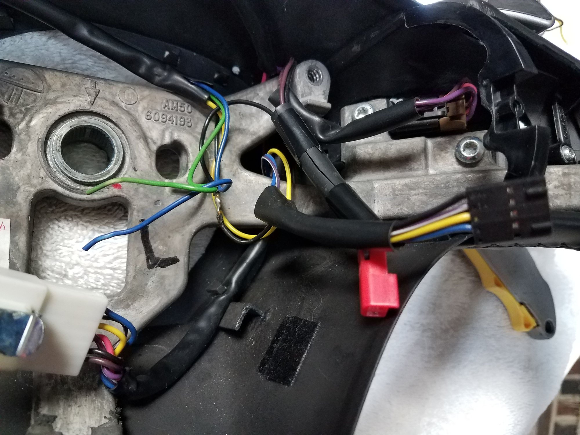

It's been 5 or 6 years since I put this 2012 wheel on my car and I had to splice the yellow and black wires from the bluetooth controls into the radio controls on the right side so I could get the buttons to light up when I turned on the lights. that left the blue & green wires with no place to go. I don't remember exactly why I had to do this but I did. I did not get all of the wiring with the 2012 wheel, I got it on eBay.
How do I remove the button assemblies from both sides of the steering wheel? This might have something to do with why I spliced the wires in.

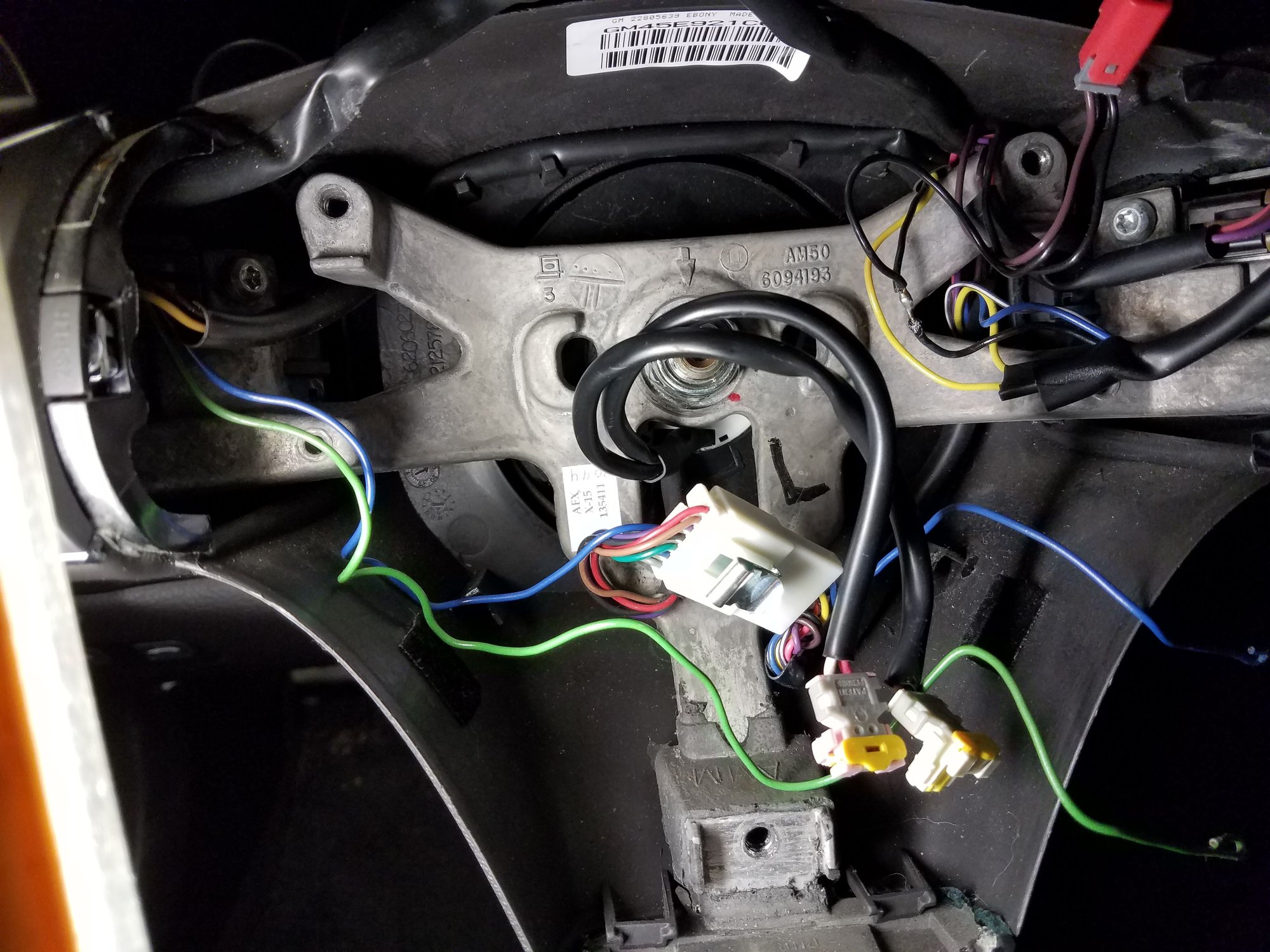

I still had the piece of wire that I removed from my old steering wheel and the black, blue and yellow on the( left ) Bluetooth side were factory spliced to the ( right ) radio controls side so that was a no brainer and those splices are complete. NOW the Green wire that must be the Trigger wire for answering and disconnecting the telephone is......... I need to find the home for it. Since my old wheel had no Bluetooth I do not know where to connect it.

OK I got it finally. Blue, Yellow and Black go back to the right side and splice in with those on that side and the Green goes to the right side and plugs into position #5. Have all my parts now so looks like I can do the install Saturday, supposed to be a Nice day in the 60's.
