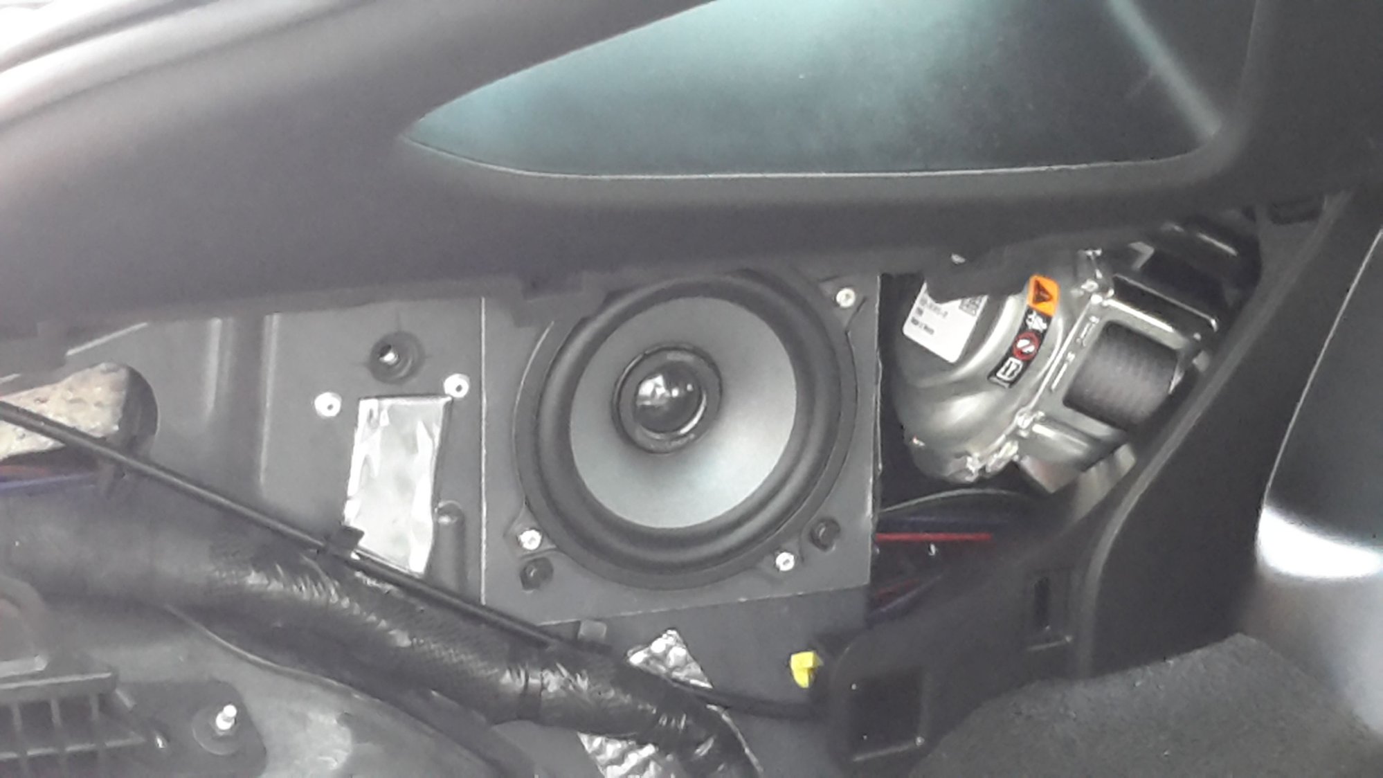

Old Mar 31, 2019 | 11:17 AM
DWillys's Avatar
DWillys
Joined: Sep 2017
Posts: 1,069
Likes: 254
I've read removing the pillar covers is the way to get the tweeter covers out. Amps are Arc X2 and the DSP is Mosconi. I decided against the OEM tweeter locations for a couple reasons - imaging is easier and arguably better when you're not bouncing the highs off the windshield and the C3CX have tweeters built in (coaxials). The center may still be used. Normally for a center to work well it should be able to go lower than the C3CXs are comfortable with and centers don't make a huge difference. Oh, and a DSP with enough channels was going to bump the cost up a significant amount. Sorry, I don't have a drawing of the plate any more. It is pretty simple. Pic below. IIRC, it is 1/16" ABS. Pretty simple, just a flat piece with mounting holes and a hole for the speaker.

Old Mar 31, 2019 | 03:24 PM
Matthewstorm's Avatar
Matthewstorm
Joined: Oct 2017
Posts: 2,009
Likes: 332
From: North Carolina
Thanks for this pic. I forwarded it to my installer. Why did you go with a separate DSP instead of with just an AMP like the JL Audio VX800/8i that has it built in? Just curious.

Old Apr 5, 2019 | 04:45 PM
Matthewstorm
Joined: Oct 2017
Posts: 2,009
Likes: 332
So, got the Morel's and Audiofrog tweeters installed. Wow, that made a HUGE difference. My installer had these preformed cups he used for the Morel's that pushed the sound into the cabin. Those OEM speakers are real crap. Doing the NAV-TV and JL Audio VX800/8i next week. Also, ordered the large Stealthbox for the rear. Got it from Crutchfield Outlet and got a huge discount.
