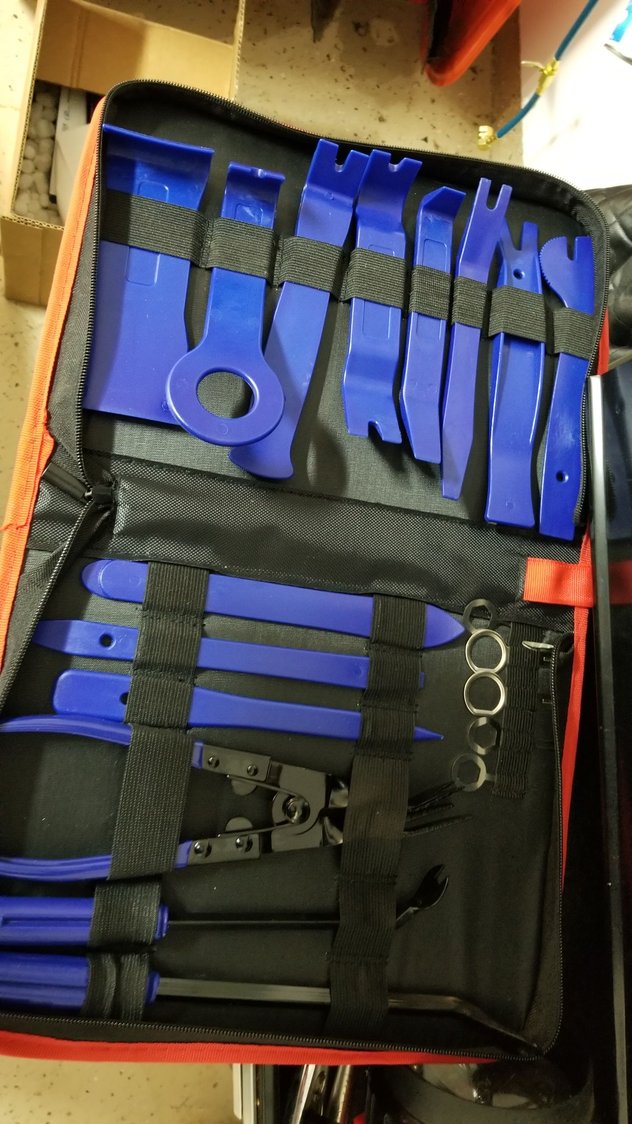

The nuts are 10mm..the screws are torx..and the door screws are philips..gm loves to mix it up
If you want to mess around with the interior..a full set of torx drivers and interior tools are needed..pretty cheap..about 45 bucks for everything

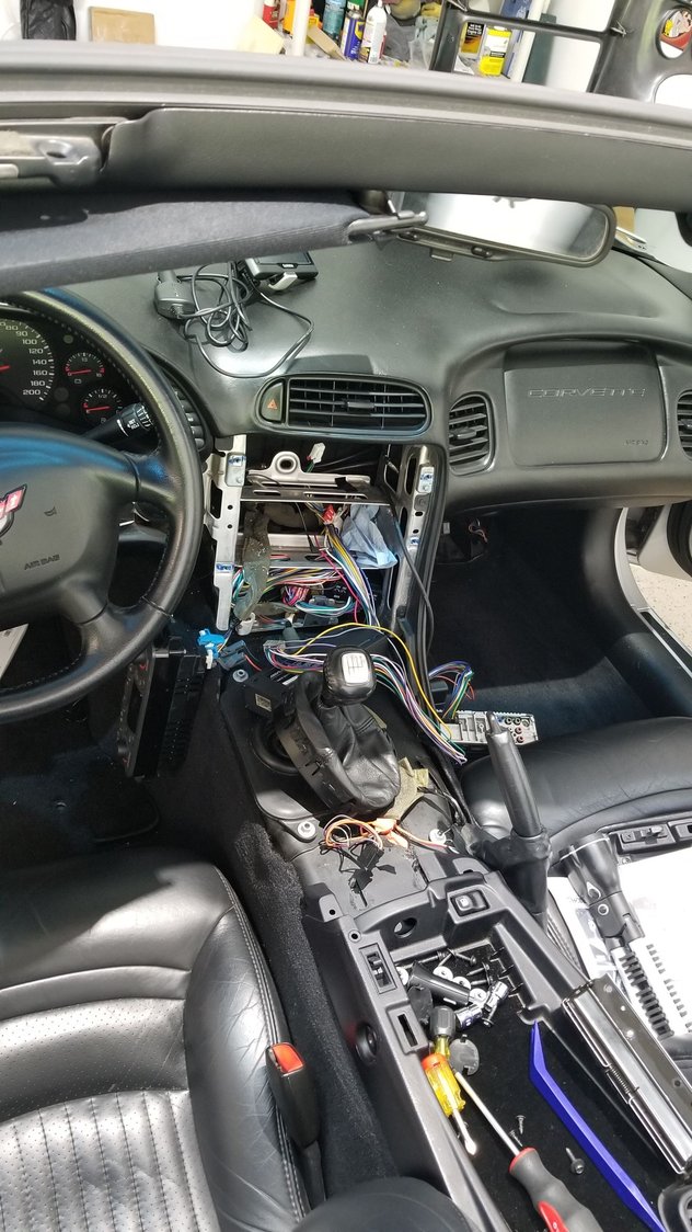

And once apart..you will be greeted with this
When you pull the bezel you have to unclip the cigarette lighter..that one is easy..the center console one is a
Bitch..i found mine cut..guess they couldnt get it off..i put bullet connectors on the wires so i can pull them easy
Also be sure to test the cig lighters for power after you hook them up but before you button it all up

Got it on amazon..look up interior tools..theyre all pretty much the same..this one had a lot
