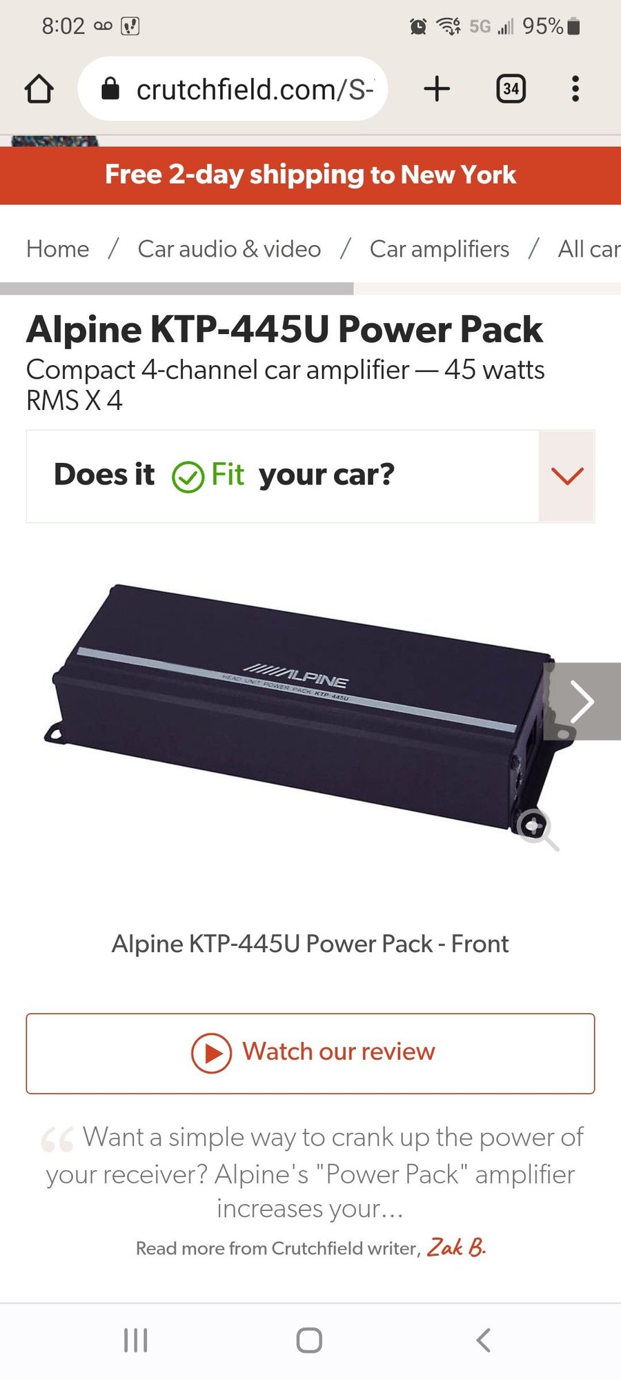

Alpine makes a small amp that fits behind the head unit..I use it to power my focals in the front..then used the HU to power the back speakers...very simple and didnt require tearing the car apart.
