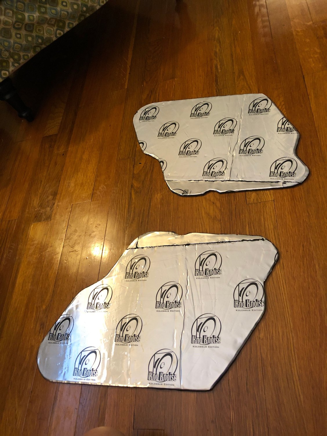

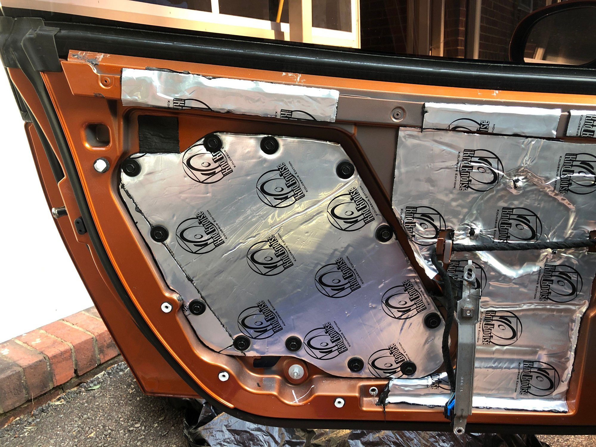

Almost finished install over weekend, everything is in and connected now. Just have to screw in tweeter to passenger door and put it back on. Have to hide the wires. Ended up mounting the amp behind passenger seat, glued wooden blocks to the bulkhead under the carpet, and then screwed amp into that.
So far, does not appear that amp is turning on- so will have to check all connections- maybe i have to set up the twk88 first? Not 100% I did the remote turn ons correctly.
Ended up having to get a new battery too (Yellow Top D35).
Anyways, super stoked on how the speakers/baffles fit perf and the sealing plates for the doors lined up perfectly as well.
