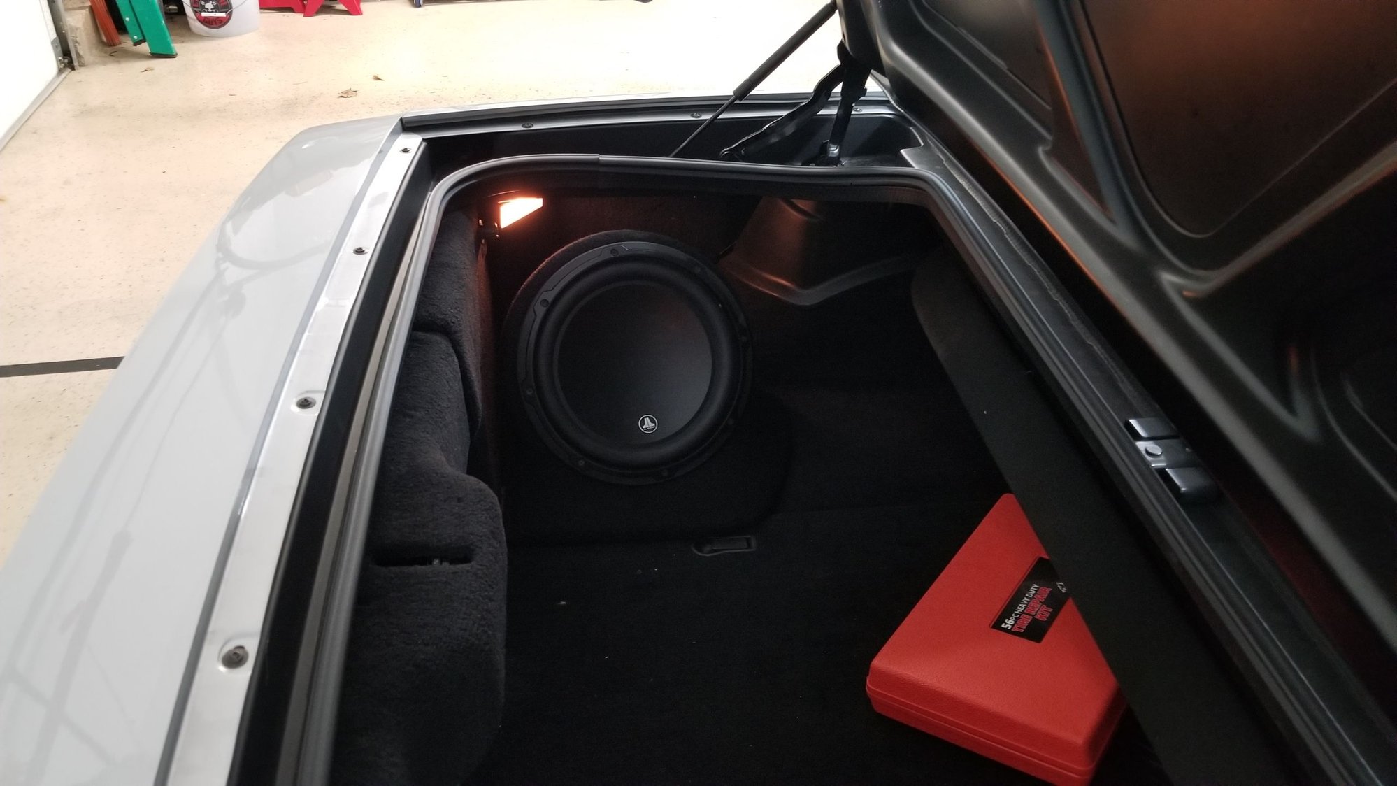

Just ordered the vettenuts corner box with JL Audio 10W3v3-2. Now I need an amp. Just want to get a mono amp for now. Spoke to Vette nuts and their experience with this sub is that it can't handle 500 watts..300 more like it. Any ideas?

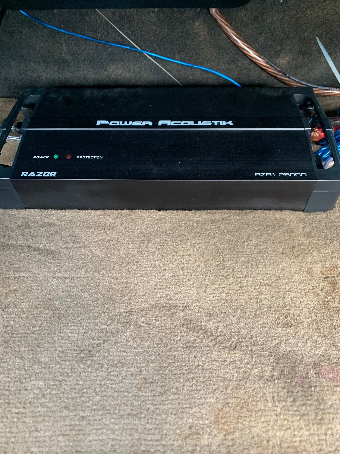

Went with a JL 500 watt mono which I'll mount behind the passenger seat.

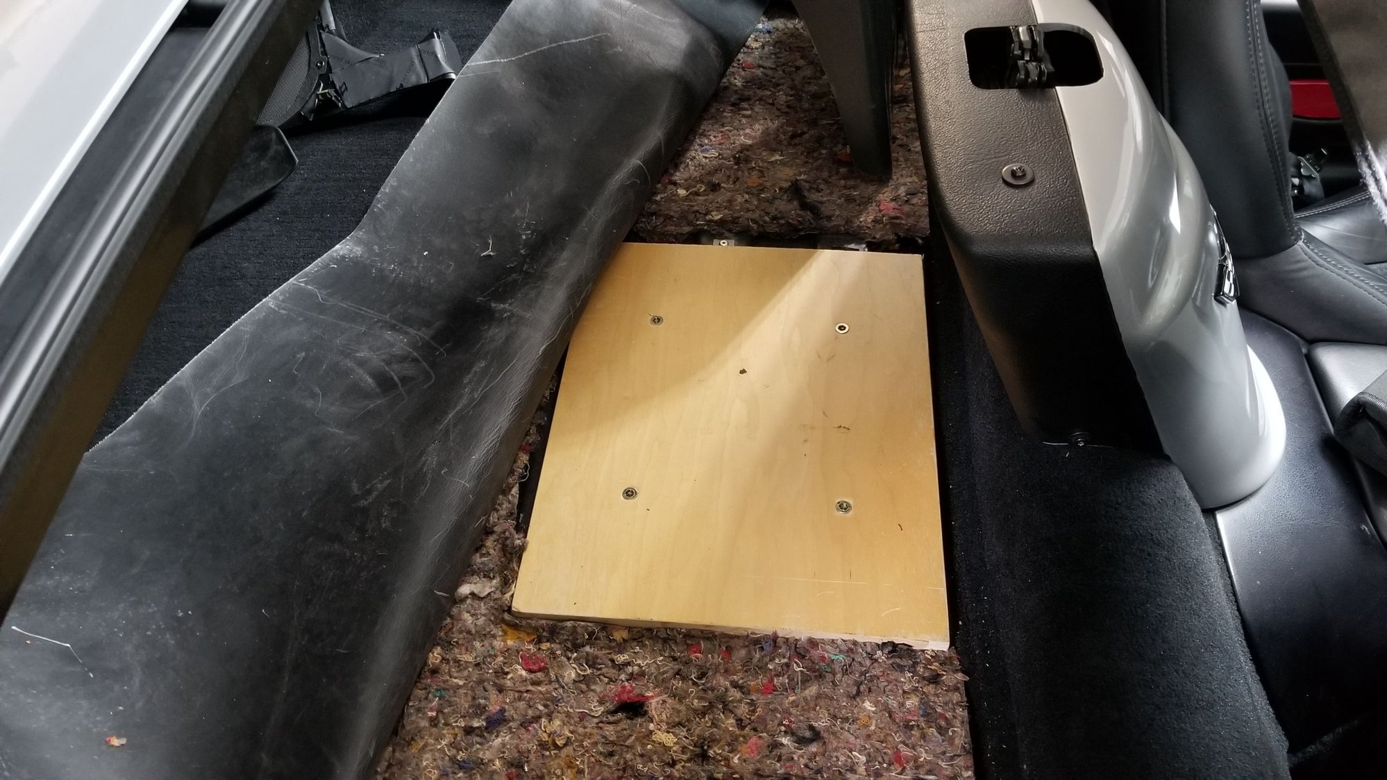

How are you going to mount the amp behind the seat? Be VERY VERY careful doing anything that involves drill there. The fuel tanks are directly behind the waterfall panel. Any holes drilled there and you WILL rupture the tank...
Old Aug 23, 2019 | 02:53 PM
mfi2000's Avatar
mfi2000
Joined: May 2019
Posts: 765
Likes: 182
3//4 plywood mounted under the carpet with 3m VB double sided tape. Screw inserts and screw the amp to it...piece of cake.

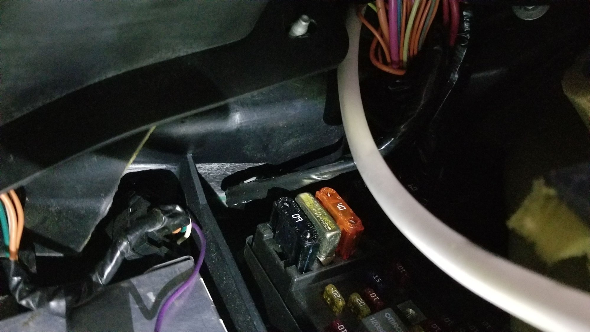

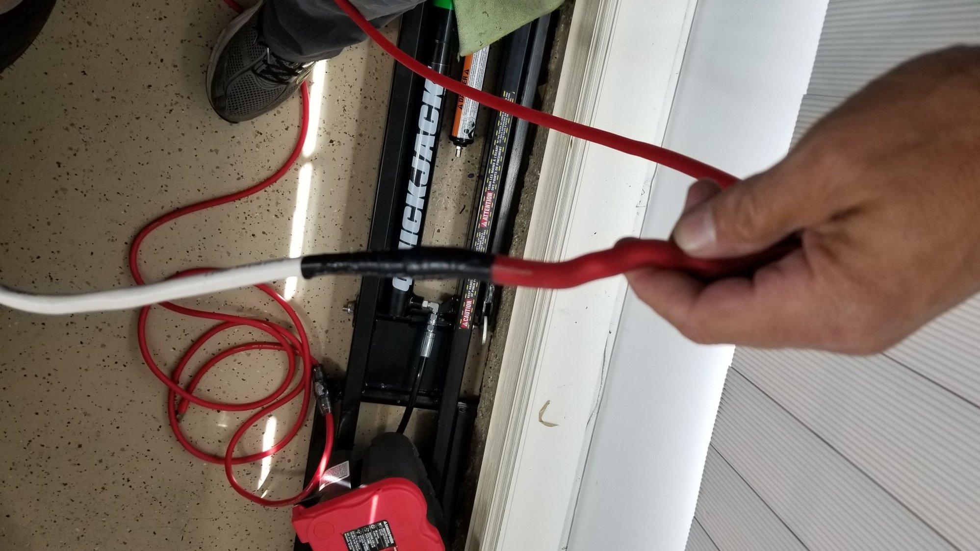

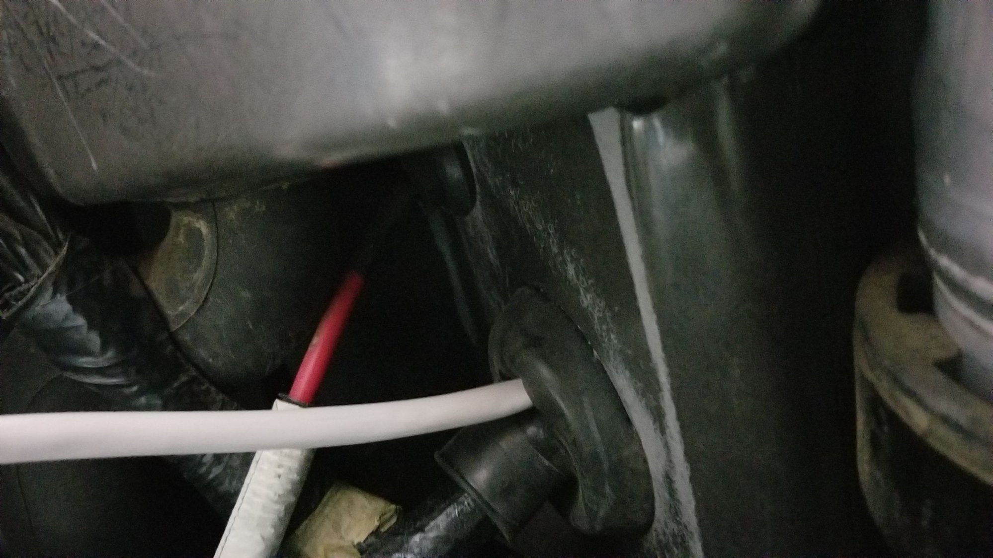

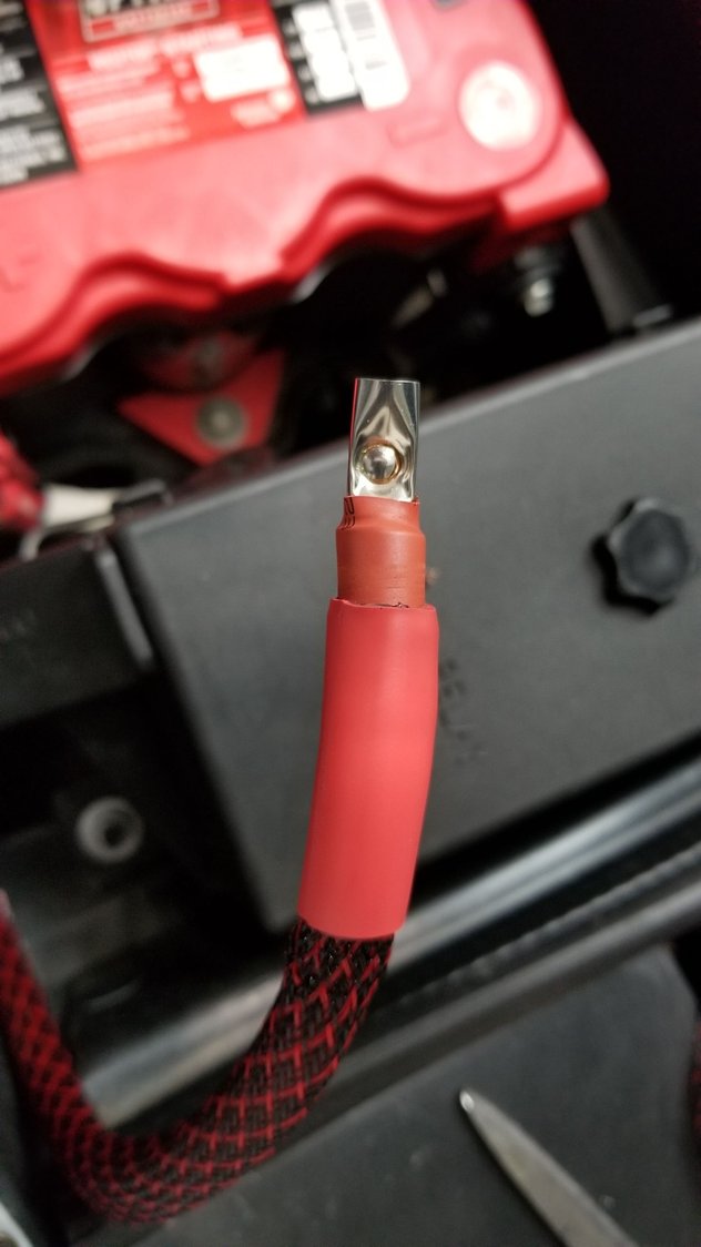

used an old speaker wire that had a pvc coating on it to make a snake to get into the footwell.
pulled the power wire through
the finished wire. It was just stuffed in there and loose out of the box. not going anywhere now

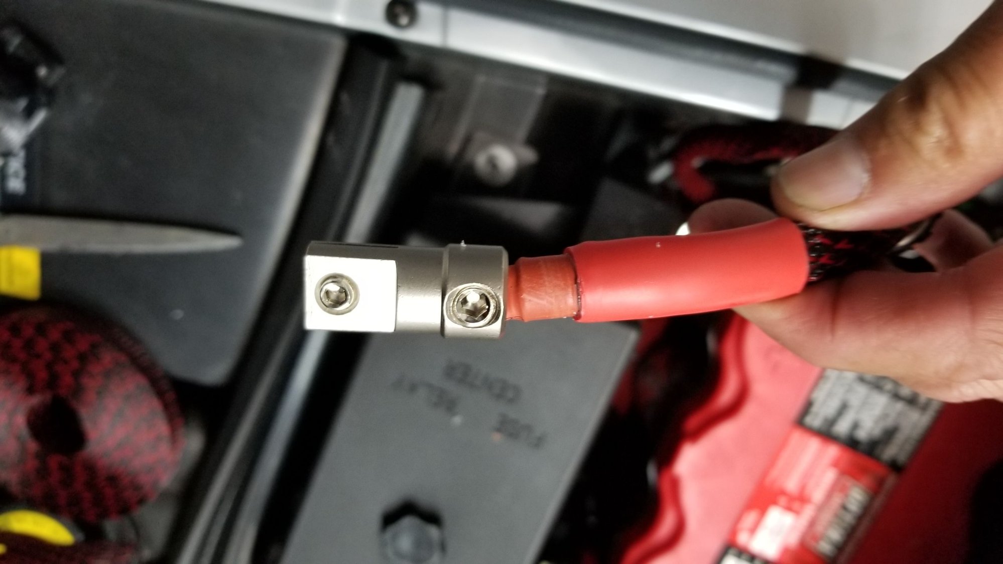

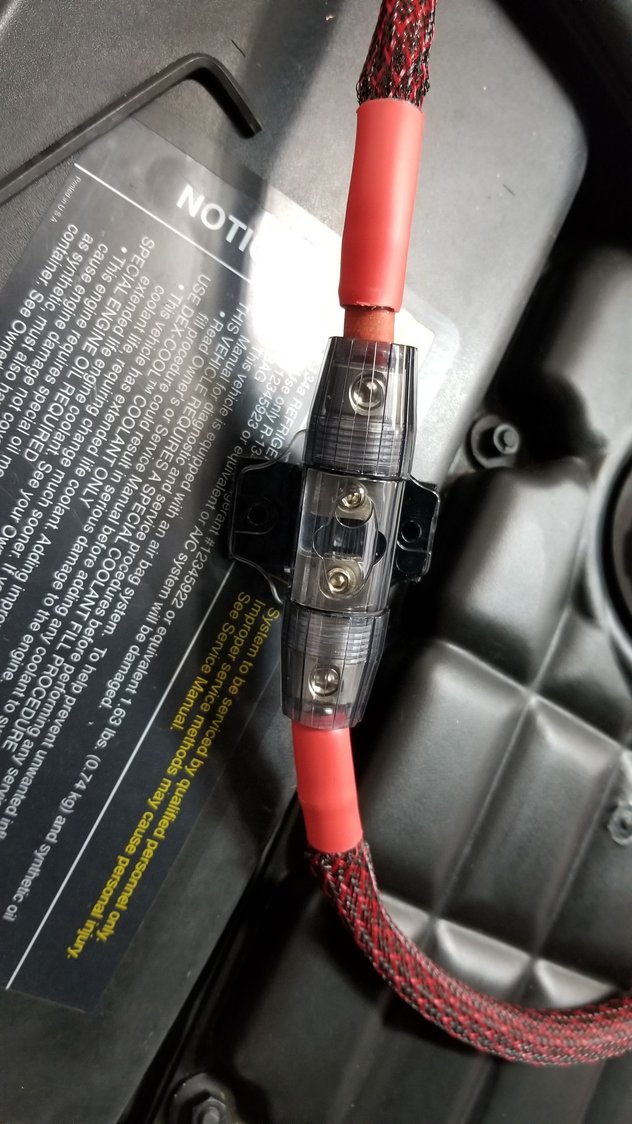

took apart the main fuse an added ferrules to the wire, and techflex covering. everything heat shrinked.
3M VBM double side tape and threaded inserts.
Started on the amp yesterday. Real pain to get the 4 gauge wire through the grommet but figured it out. From there wasn't too hard to get behind the waterfall where the amp will go. Some plywood, double side tape and threaded inserts. Grounded it to the waterfall metal. Now on to the speaker wires and signal wires..then hopefully won't have to touch this again for a while.

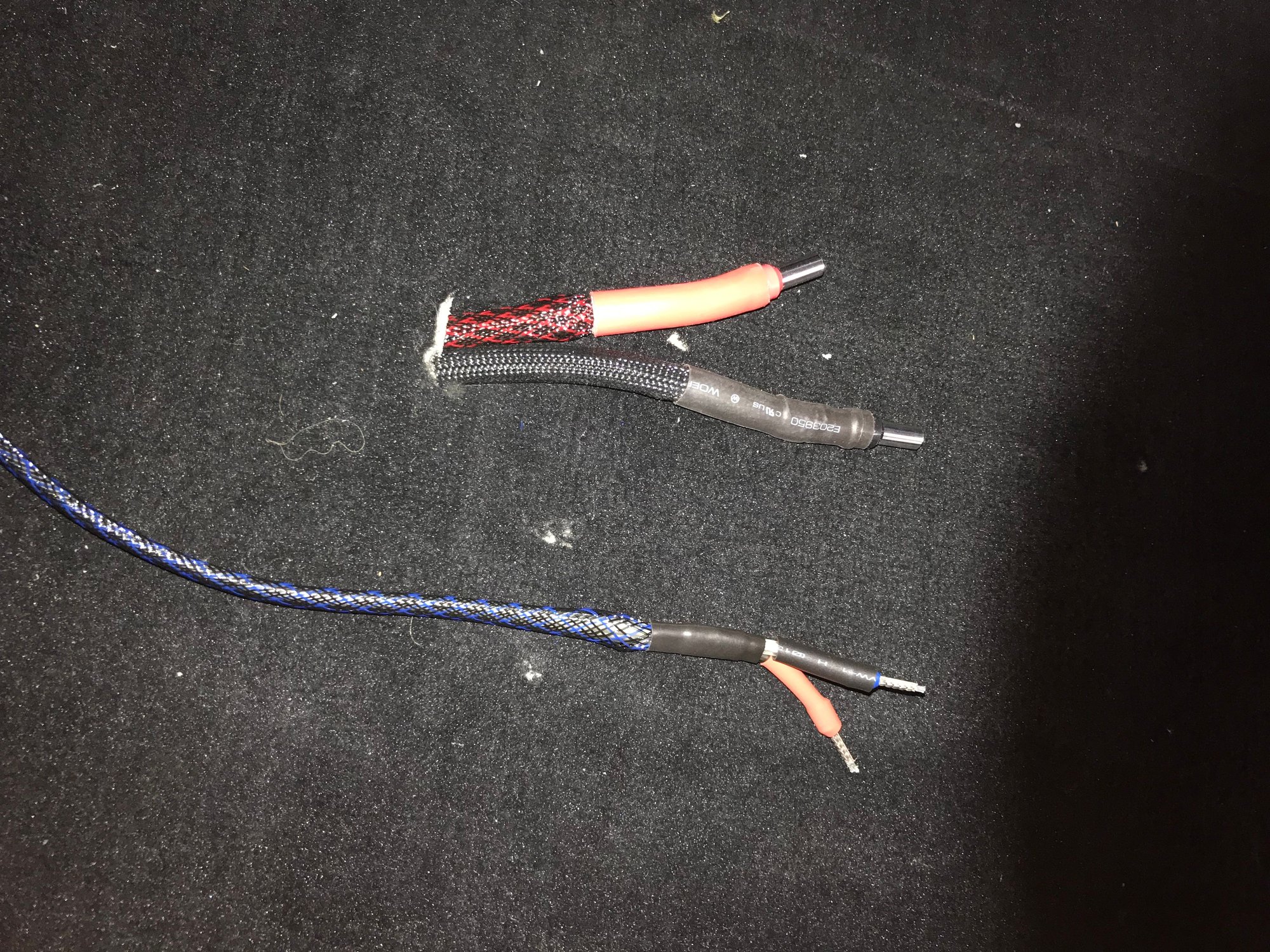

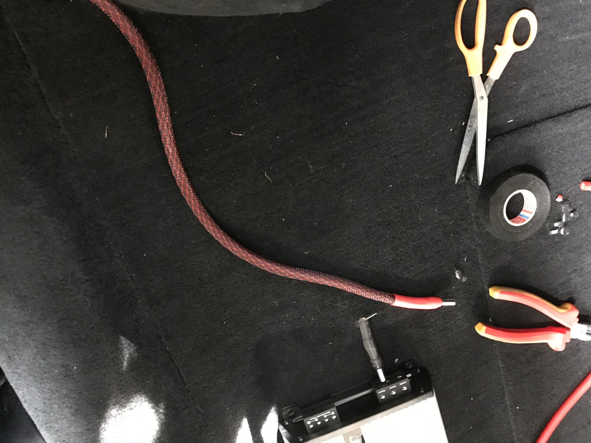

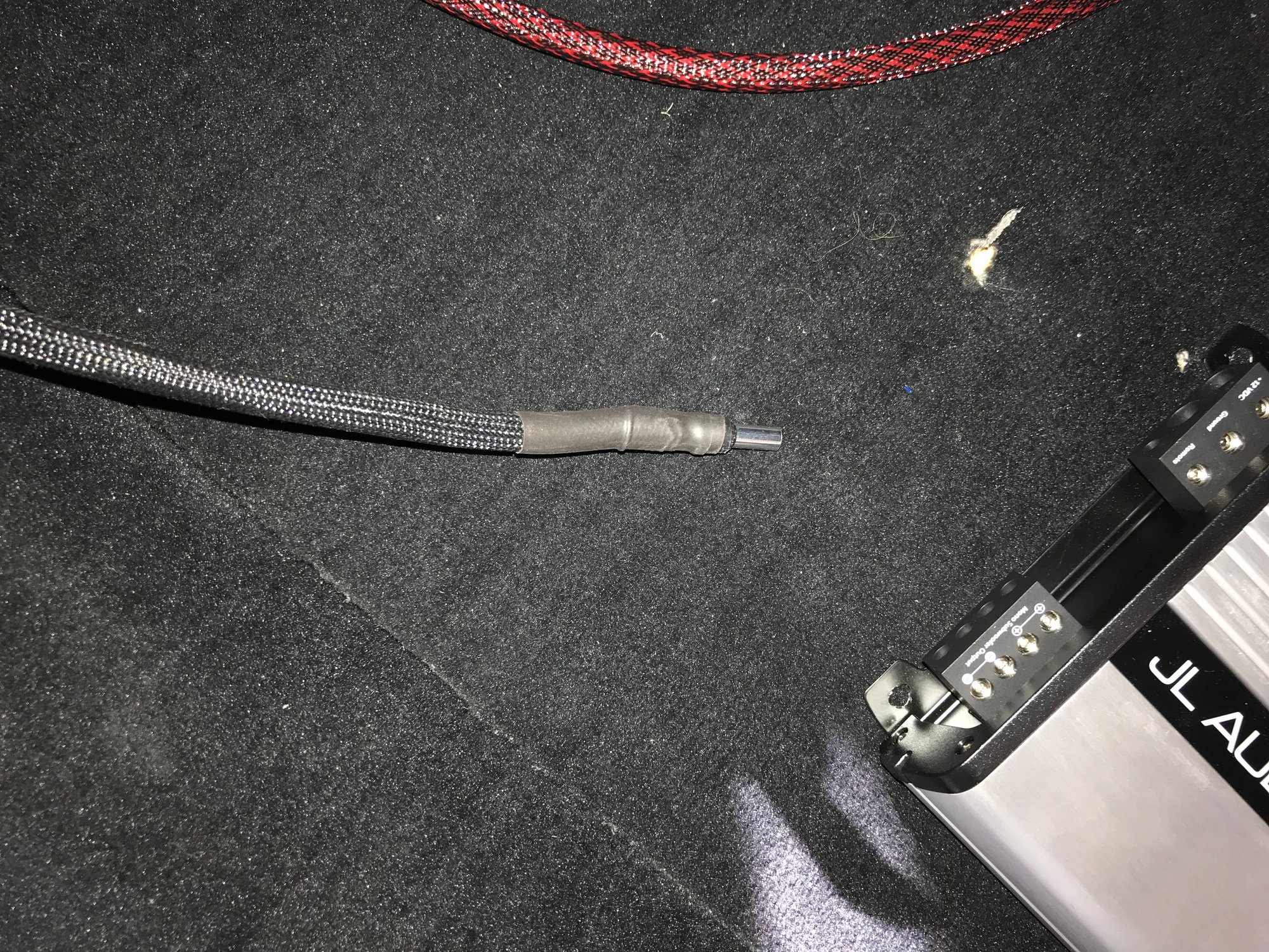

Main positive cable with ferrule and techflex covering
Ground with a ferrule and techflex
and the speaker wire
Doing these cables the right way is certainly the loooong way. The ferrules are cool and with the right tool they work great. Putting the techflex covering on adds a good amount of time as you have to scootch it on inch by inch..then heat shrink everything. It does look very good when your done though. Next up is pull the radio again and hook up the amp turn on and the signal cable. Then I can get the whole thing tuned up.
