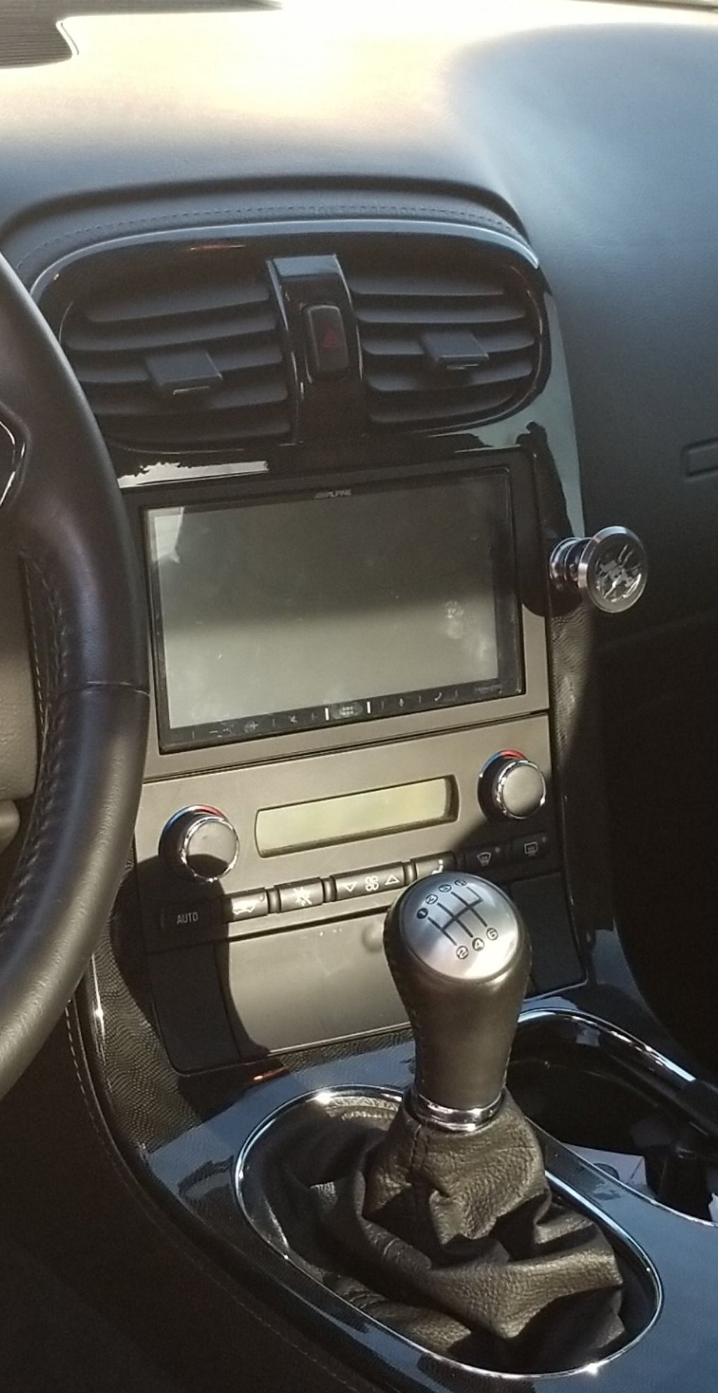

Default Ilx-w650 static noise
Just installed with the pac rp5-gm11 harness
everything when smooth.
when there is no music, I can hear static. It gets drowned out when the volume hits like level 3. Any clue?

What kind of static though ? White noise ? Ground loop noise ? Alternator whine/noise ?

White noise
someone on Corvette fb group said to make sure the Pac is plugged into the amplified connection and not the non amplified one. I think I plugged it into the non amplified one cuz I don't have bose. But he said doesnt matter since I have a stock amp even without bose
ima try that and we'll see

Raptor, this is correct. Bose and non-Bose cars follow the same directions because both have a factory amp. Plug the harness into the jack labeled for an amp. Once you do this it should take care of the noise issue.

Purely out of curiosity what is that **** to the right of the head unit?

It's a magnetic phone mount. Not really a ****...

Yea a magnetic phone mount
