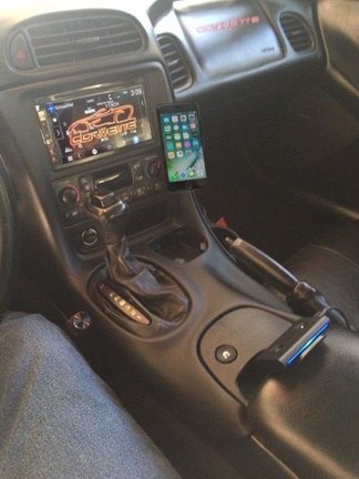

I just put a DD in mine. Got everything from Crutchfield. It all worked fine and seems to be very secure. The biggest PITA is removing the two metal brackets that are back in the dash. But when all was done I was very pleased.

Originally Posted by NYC6
just had a new kenwood HU put in my C6 which connects my iPhone via USB and already I’m tired of it sliding around. Was thinking about buying the weathertech cup thing but your idea might be better. What is it, how do you like it and where do you get it? Thanks
Sorry I have not got back with you on this but it is from Proclips (as madsnop said). Works great. You purchase the clip and how you want to mount it on the clip separate. I got the magnet on the clip and a small metal plate on the phone. Very sturdy!!!
