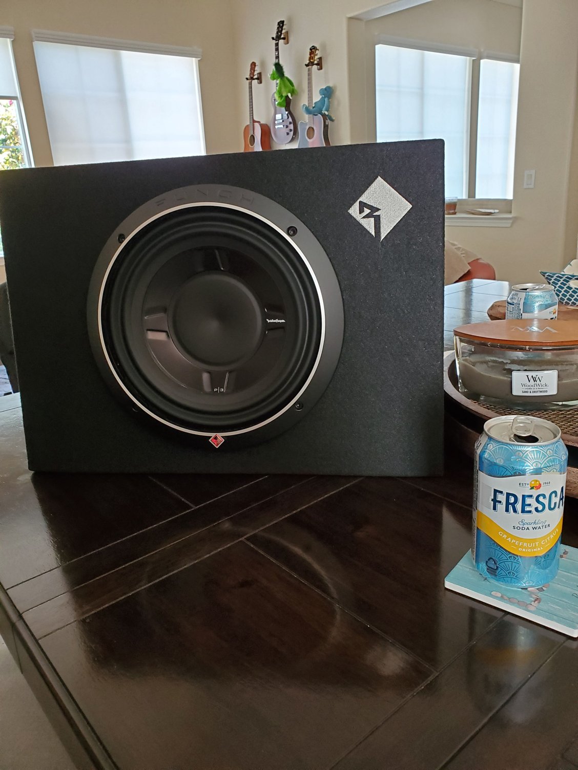

I just pulled the trigger on a shallow 10" Rockford Fosgate loaded enclosure. (https://www.sonicelectronix.com/item...-P3S-1X10.html)

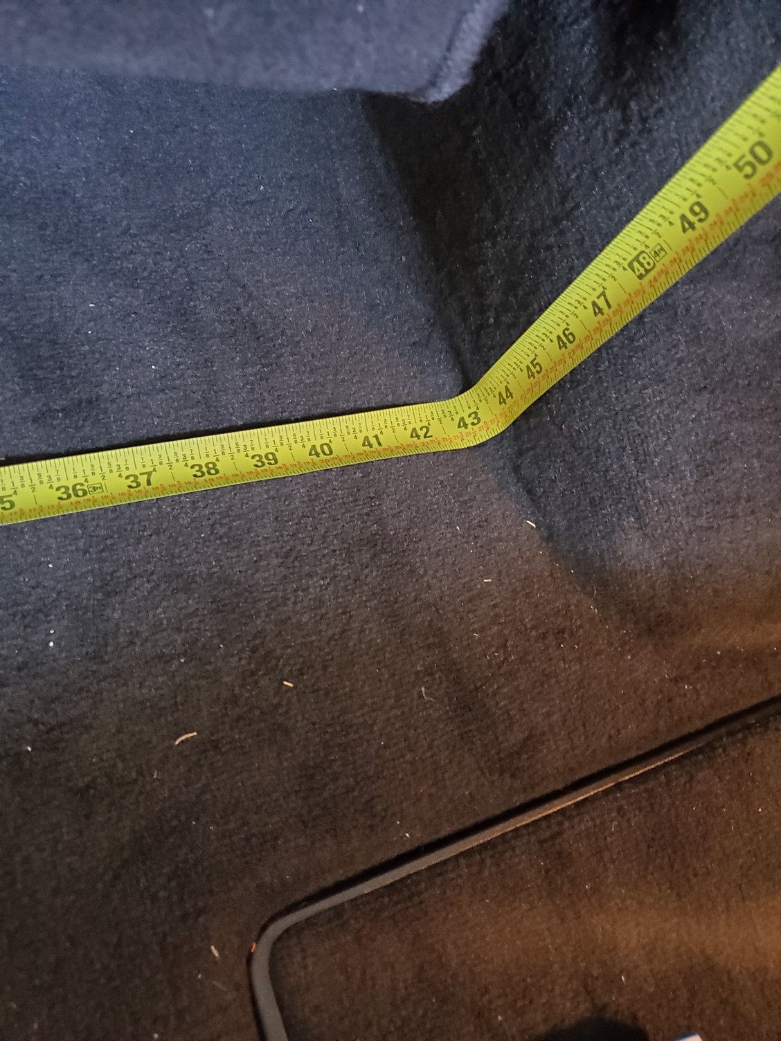

The measurements of the enclosure are almost exactly the right size to fit under the convertible top storage at the front of the trunk - it will protrude 3-4 inches into the main trunk area but if the tape measure is not lying I should be able to fit my carry-on luggage or golf clubs with no problems when done. Further - if needed I bought enough amp power to drive a second one if it fits like I hope. The distance between the wheel wells is 43.5 inches and this enclosure is 19 1/8" wide each. I will update on how it goes but it seems like it may be as close to a custom fit as possible without the JBL custom fit price tag.

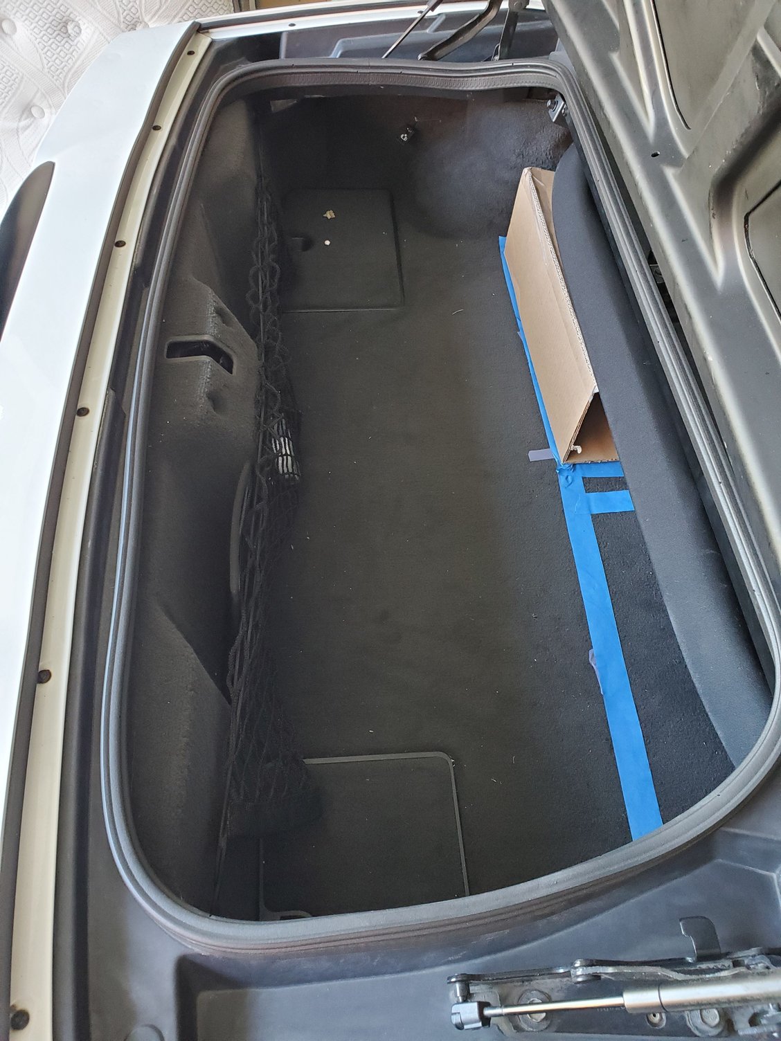

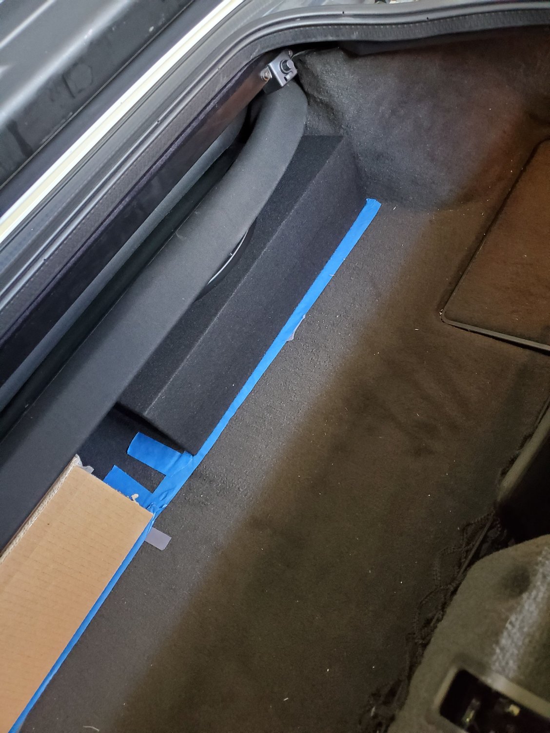

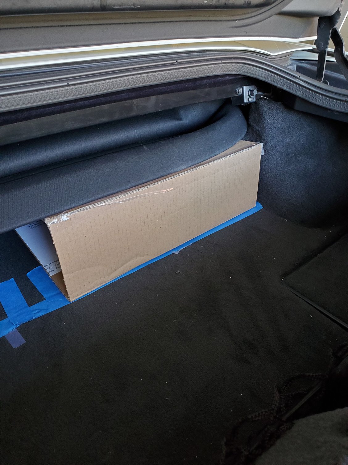

Default A couple of cardboard scale mockups while we wait.
Test fit of the Amp under the waterfall. Wires will make it tight.
Sub mockup on passenger side trunk. (I I ordered two)
Sub mockup on driver side of trunk. These are very very snug but i am hopeful it will work out perfect.
Golf clubs and carry on luggage still allowed.

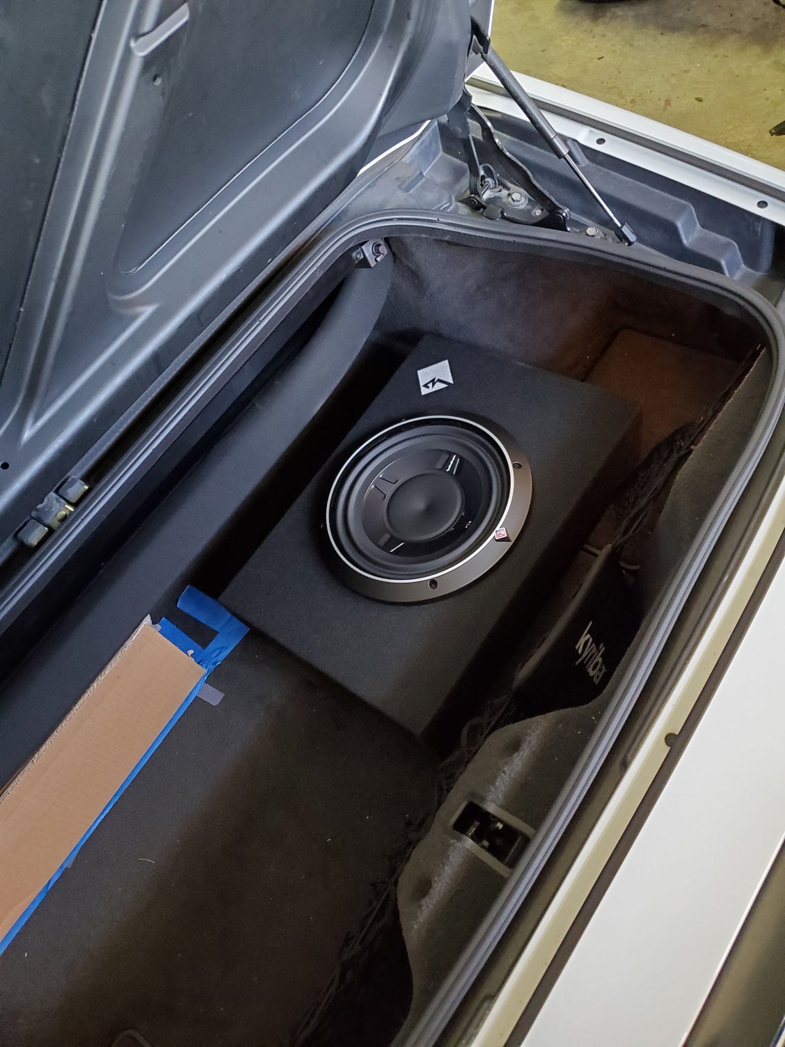

Default Update. Partial shipment arrives from sonic.
This is working out better than I imagined and I can't wait for the amp to arrive. Only one of the subs came today so I quickly moved to test fit and it fits like a glove. Now if I can just get my amp and second sub....
Rockford Fosgate Punch P3S-1×10 is a custom fit c6 Vert 10inch application with a mass electronic price..
More updates once we get them lit up.
Unpacked from FedEx.
This may just fit.
The tape did not lie. It fits like it was made to go here.

I think my concern would be the movement of the speaker impacting the roof, but at the angle of the photos, I can't see if it could be an issue or not.
Old Apr 7, 2020 | 09:29 PM
derksens's Avatar
derksens
Cruising
Joined: Apr 2014
Posts: 12
From: San Francisco, CA
Default Not a concern. Trim ring is an inch deep and is not touching anything.
It's safe. Nothing is touching and the trim ring allows for more than the woofer throw. I'm actually a little shocked how good this looks.

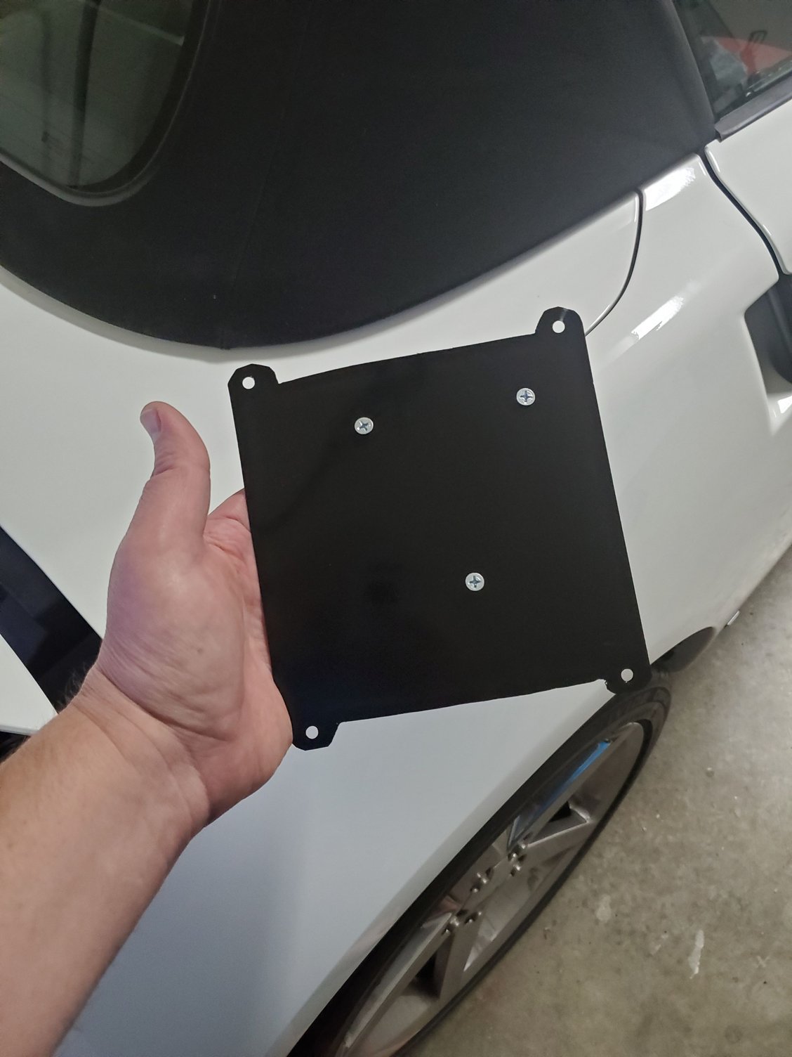

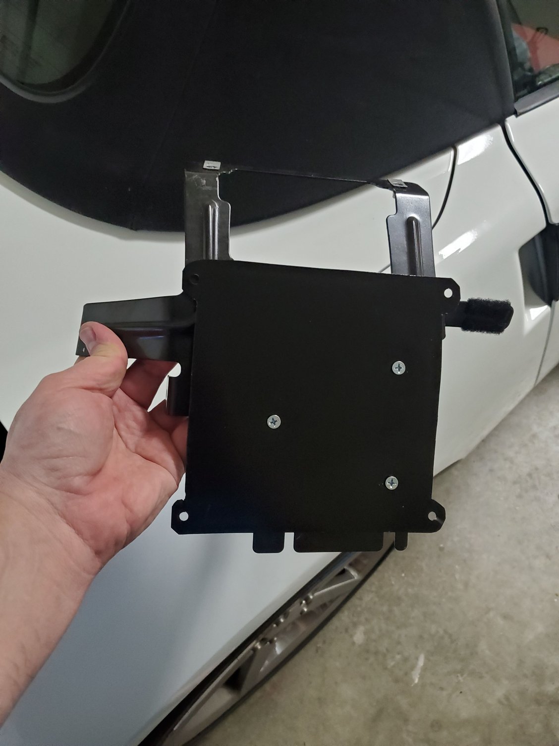

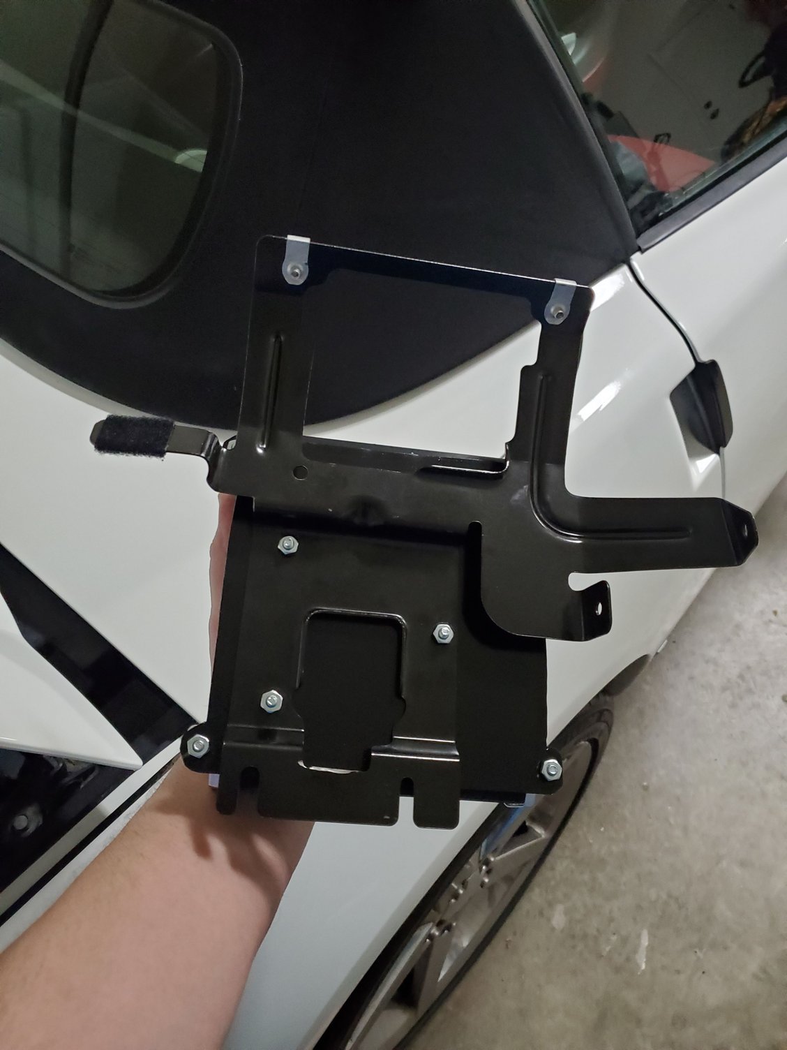

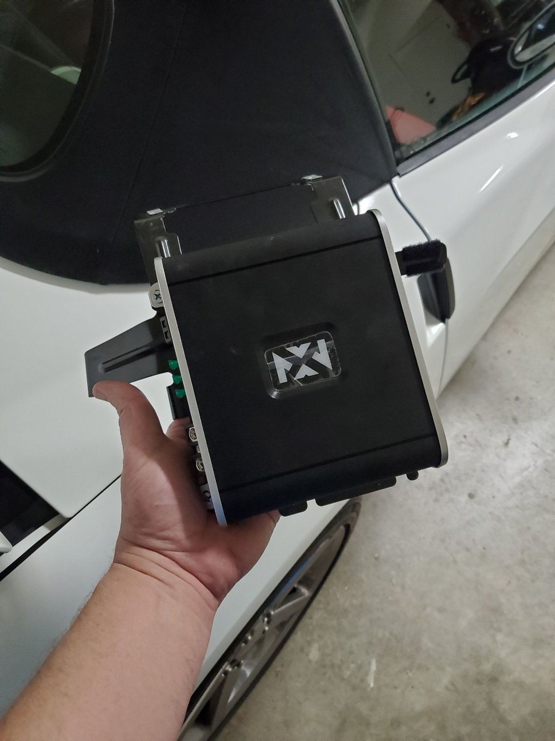

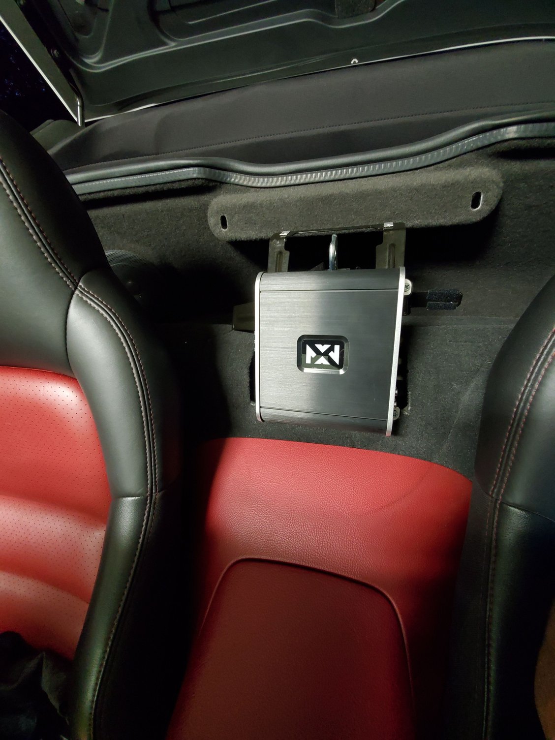

So the rest of the shipment arrived and I have the test fit for the amp completed. I made a little bracket for the amp and it fits nicely in the waterfall. Have a look.
Bracket completed
bracket attached to factory xm reciever bracket
back of it all together with amp installed on bracket
Front view
In the car.
Behind the waterfall
To My C6 Convertible Subwoofer Experiment
