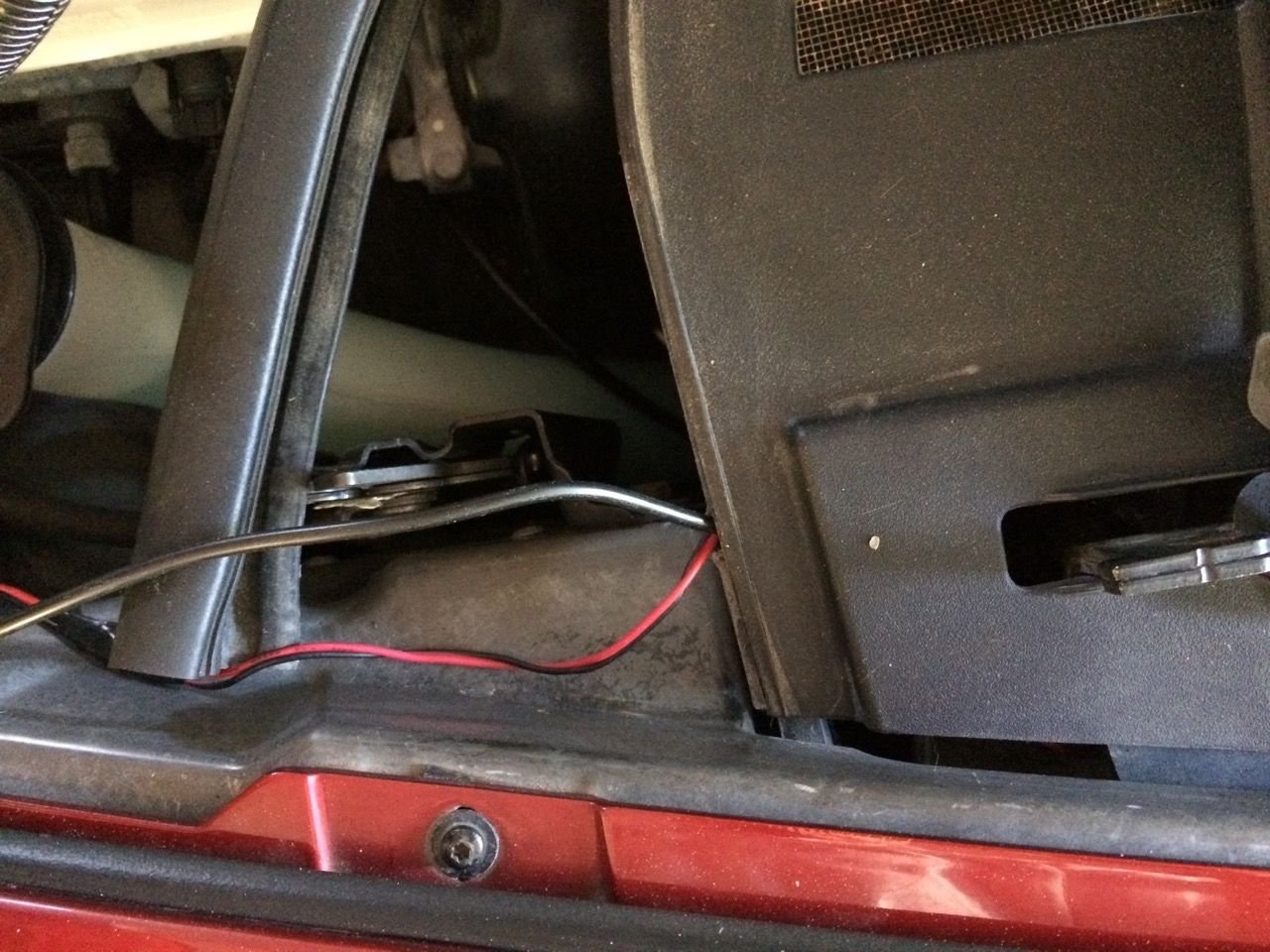

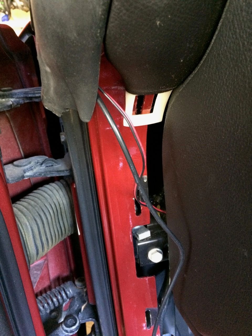

I went at it a bit differently. Used some plastic wire loom to encapsulate the power and video wires from the front camera. Ran that kinda parallel to the driver's front fender, then under the cowl and into the cabin near the A-pillar, then straight across the driver's side footwell area into the center console. Hopefully the pictures tell the story here.
Wires partway in wire loom
Under the cowl
Out the other side and towards the A-pillar
Now in the cabin
