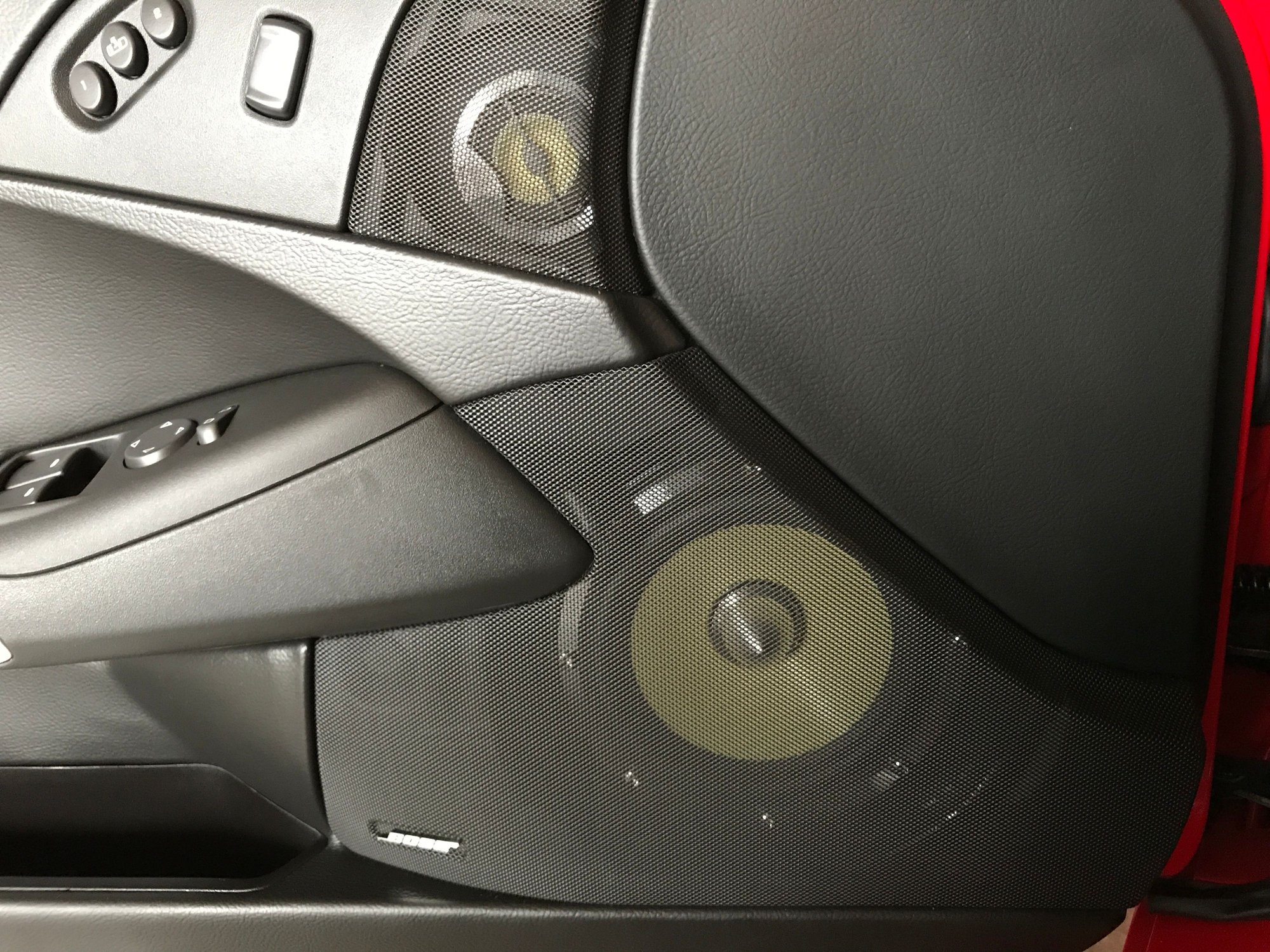

All you have to do is start. Mine was a daily driver also. I drove around without door panels for a couple of days. I used the emergency release lever to open my door to get out.
