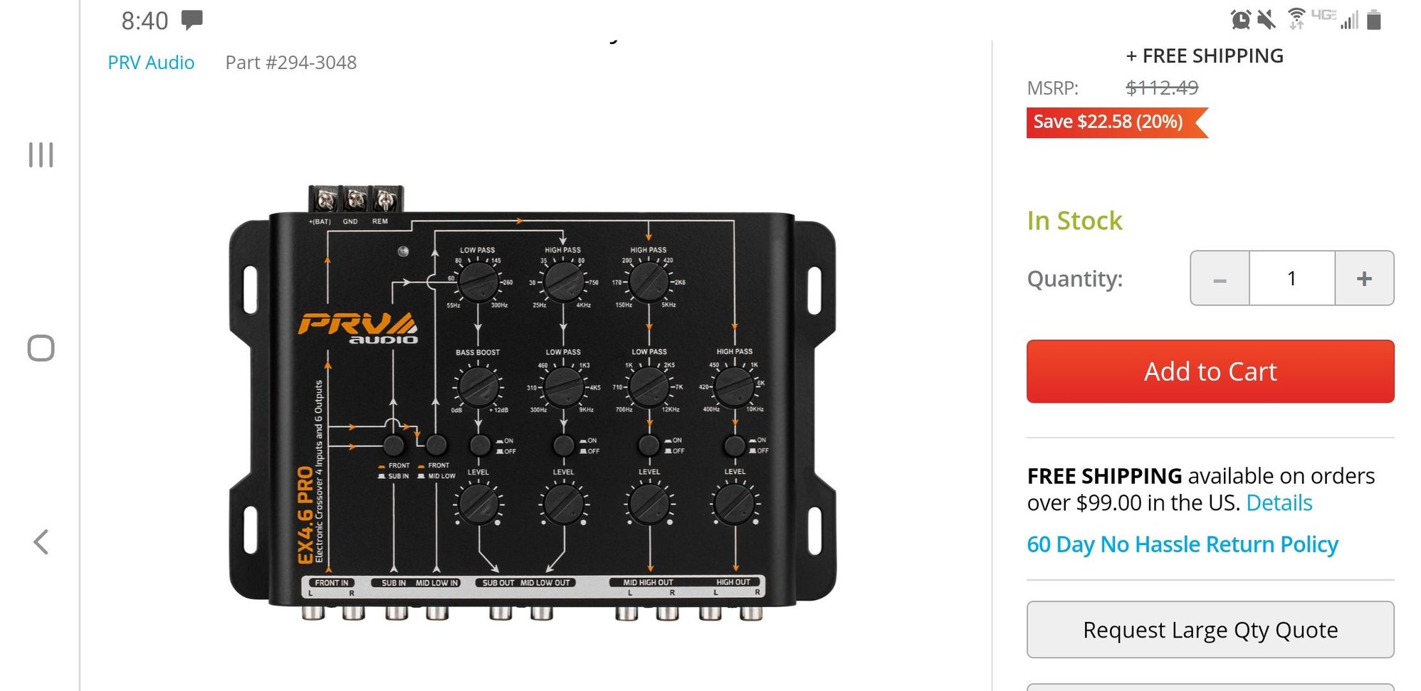

Looks like this will do it, but I'd prefer a higher sn ratio. Do most oll of these things allow us of 1 input to drive all outputs?

You may want to consider the Audiocontrol 6XS.

Vince's recommendation is spot on.
