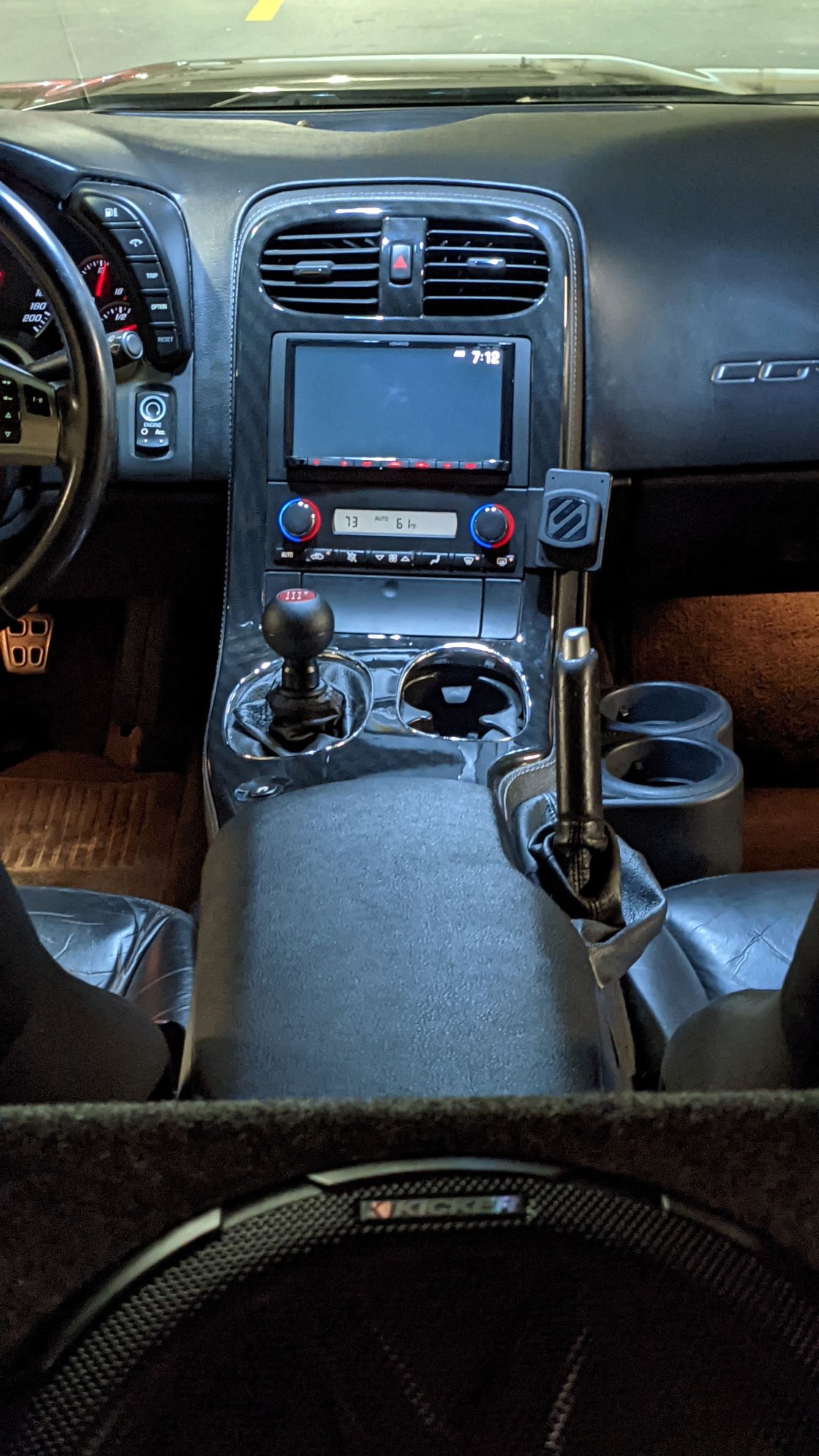

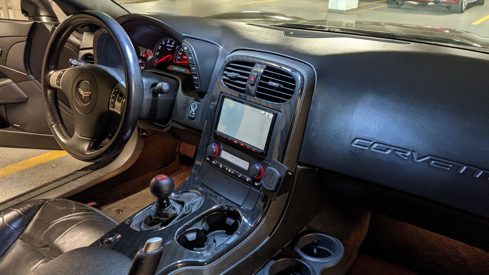

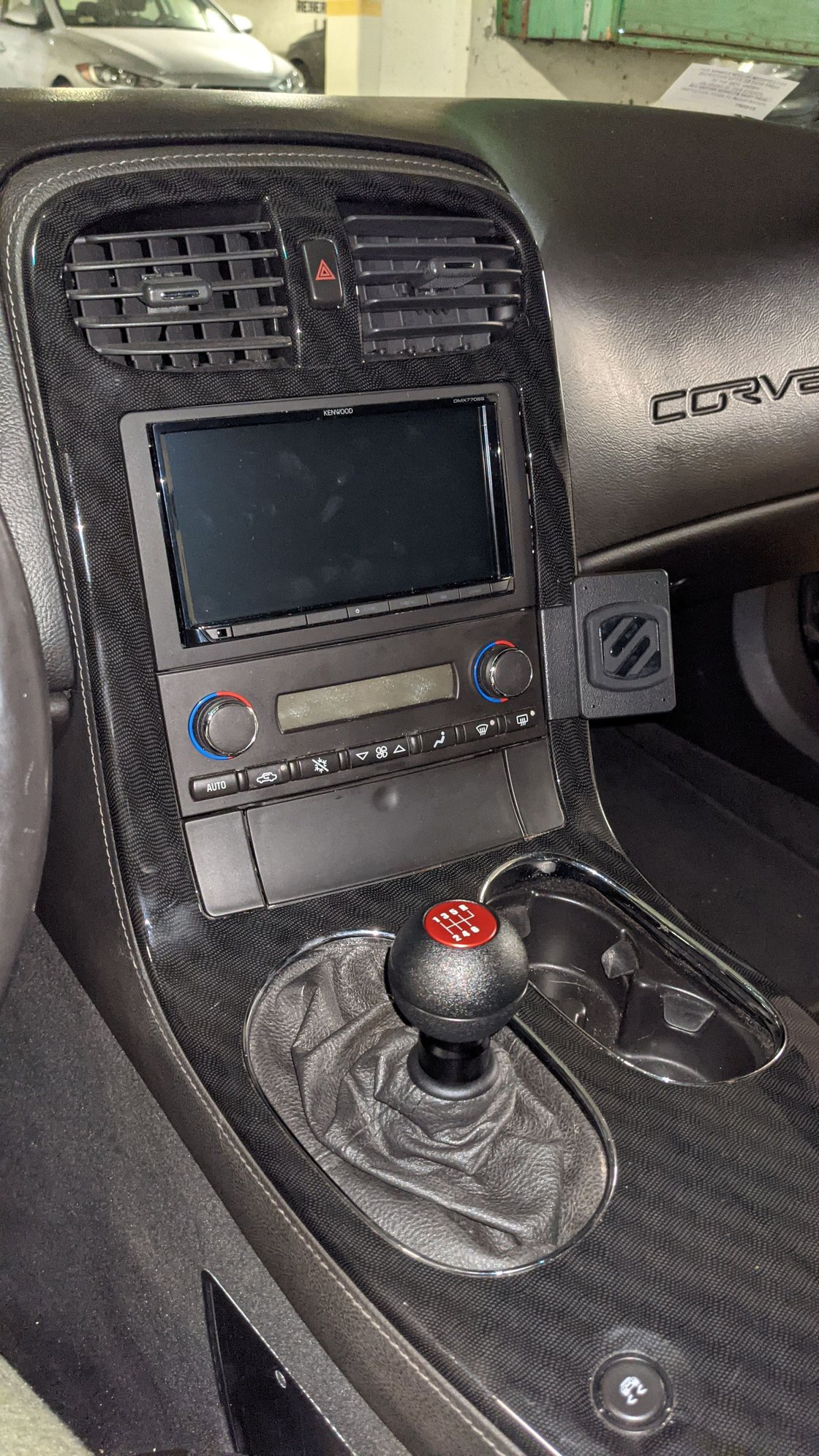

Done except mounting the sub down. Some of the leather from the center console was separating along the right side so I used 3M spray adhesive on the back to reattach it. Also noticed the weather stripping on the a-pillar wasn't in the track so I tidied that up when I put it back together.
Stereo is great, sub is definitely not as powerful as I had hoped, so I'll probably be buying a new setup over the winter. MGW shifter is really nice. I opted to switch out the chrome ring on the boot for the black one supplied because the chrome against the black shaft looked off to me. It's going to take a little getting used to because of how close together the gears are but it's a good thing.
Really appreciate all the help, happy to pass on anything I can to the next person. Getting the steering wheel controls programmed wasn't too bad but there aren't many videos online and the instructions are terrible. Also getting the screen to line up perfectly around the edges was time consuming, but worth the time.

Looks like it turned out nice What did you install for a sub ?

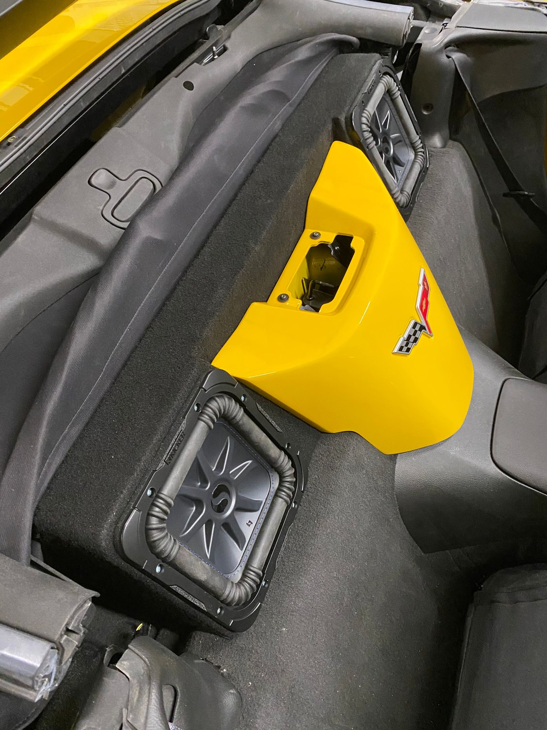

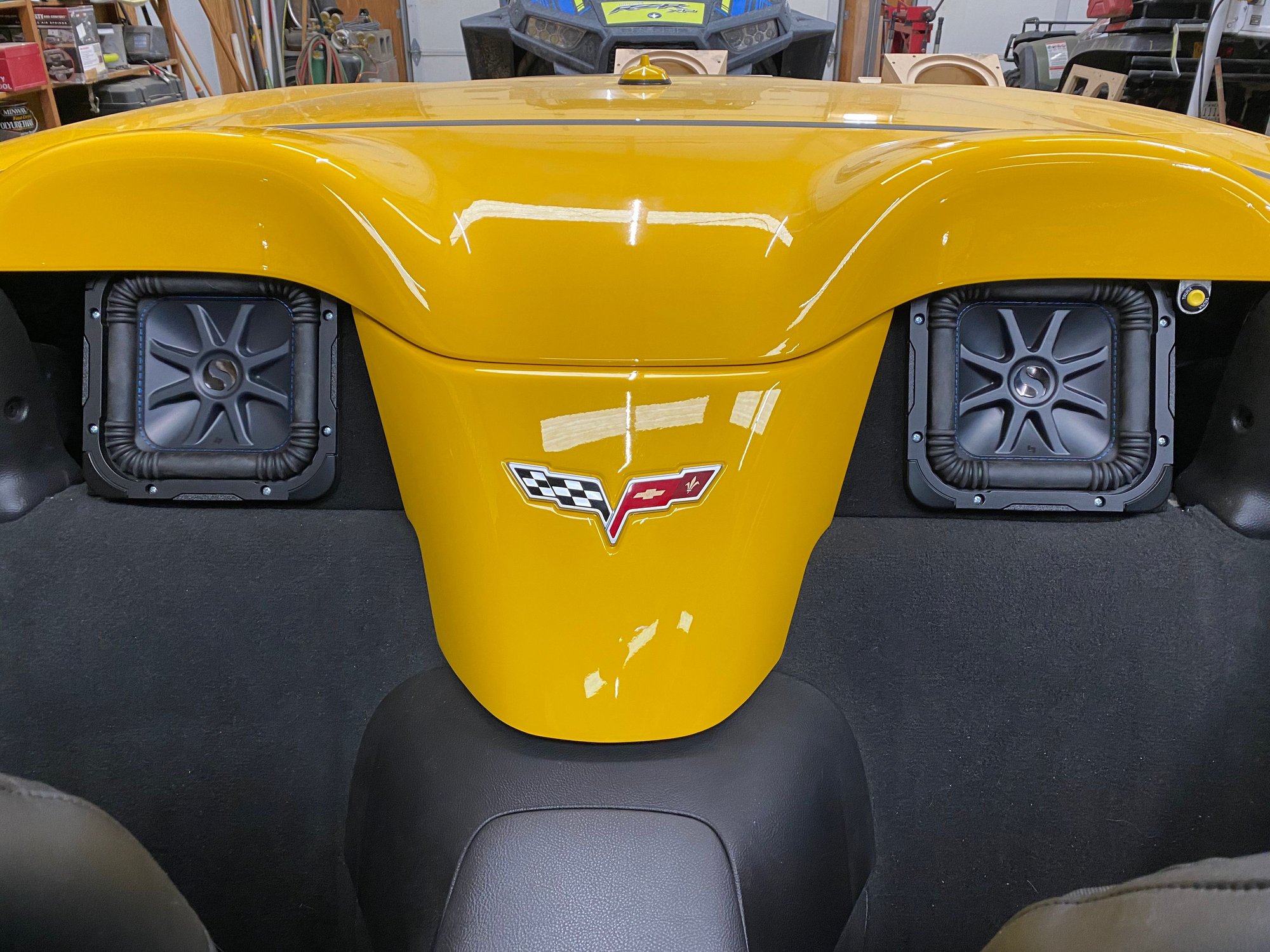

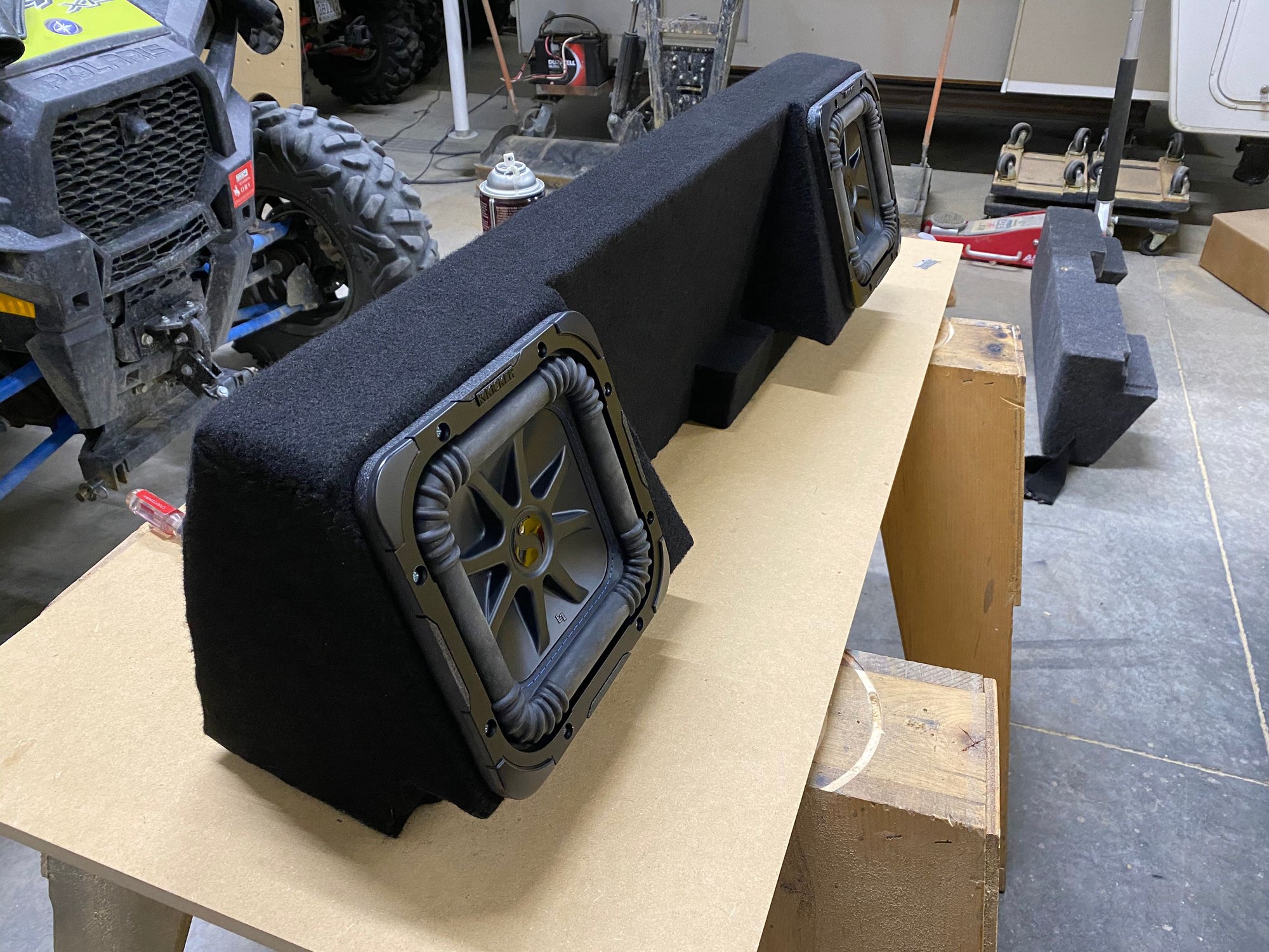

Yeah, I can see at only 100W where it wouldn't be enough. I personally designed and built one myself for my vert that sits behind the seats and uses dual 8" square Kicker Solobarics powered by a Kicker amp at about 300W each. It sounds really good. Here's some photos of mine,

PS Madonsp that is a clean speaker install! Almost think Verts have a better sound stage to deal with.

Thanks, I appreciate that, I don't know if vents have a better sound stage or not, I just know that when the tops down if there's a sub in the very back, the sound can get muffled which defeats the purpose of the sub, hence my design where you get the same sound out of it no matter if the tops up or down.
