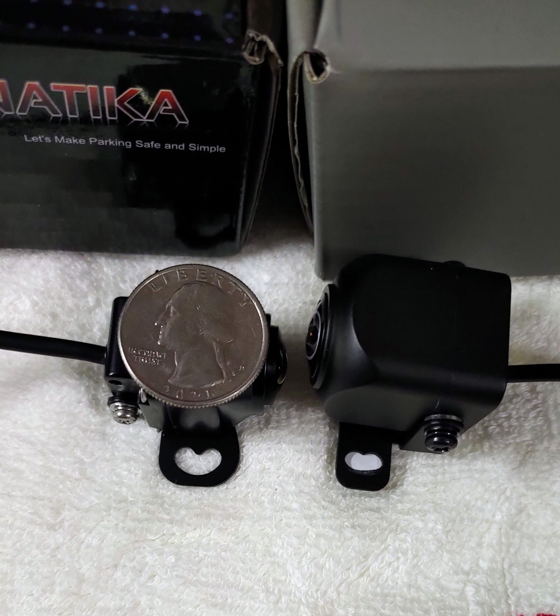

I purchased these two on Amazon. They were around $40 each.
The smaller one is 720P resolution which I'm going to install in the front and the slightly larger one is full 1080p which I'm going to install on the rear.
The picture of the license plate is from a YouTube video that I saw a guy installed the same PixelMan camera on the rear of his C6.
Amazon Amazon
Amazon Amazon

Since that camera so small I may end up sending back the PixelMan camera and getting another one of the Natika ones!
I'm going to hook it up to a monitor I have here and a 12 volt drone battery and check out the Natika before I install it. I played around with the PixelMan camera that seem to have good resolution but it's definitely larger.
