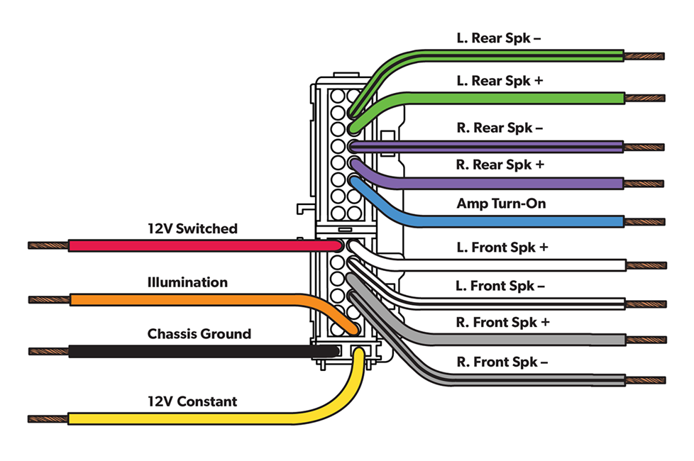

The RP5-GM11 is the most commonly used interface used on this forum, however there are other interfaces and other manufacturers of interfaces that'll also work depending on the features of the specific head units needs, but the RP5-GM11 pretty much covers the needs of any head unit out there, though all connections may not be needed depending on the specific head unit being installed.
On a side note, another thing that's been standardized with the aftermarket systems is the wiring colors to help simplify installation, not all car manufacturers however have not all adopted this standardization with their stock stereo systems, however the manufacturers of interfaces has, which makes for simpler wiring of the head units wiring to the wiring of the interface, you basically wire them together color for color then the interface has connectors that match those of the cars factory radio connectors, so this basically make it plug and play once you've wired the interface up to the stereos wiring harness. Here's an example of the standardized wiring colors.
Depending on the system being installed there may be additional colored wires such as Pink for a VSS (Vehicle Speed Sensor) used in navigation systems, or Light Green for a parking brake connection, Blue with a Yellow stripe for steering wheel controls. For example, if you bought an aftermarket head unit requiring these connections, an interface capable of these added connections would be required. Also, keep in mind that a lot of these interfaces are designed to work with a wide range of vehicles, so there might also be wiring that wouldn't be needed for a Corvette such as the RSE (Rear Seat Entertainment) wires on the RP5-GM11 which (for obvious reasons) wouldn't be used on the Corvette.
