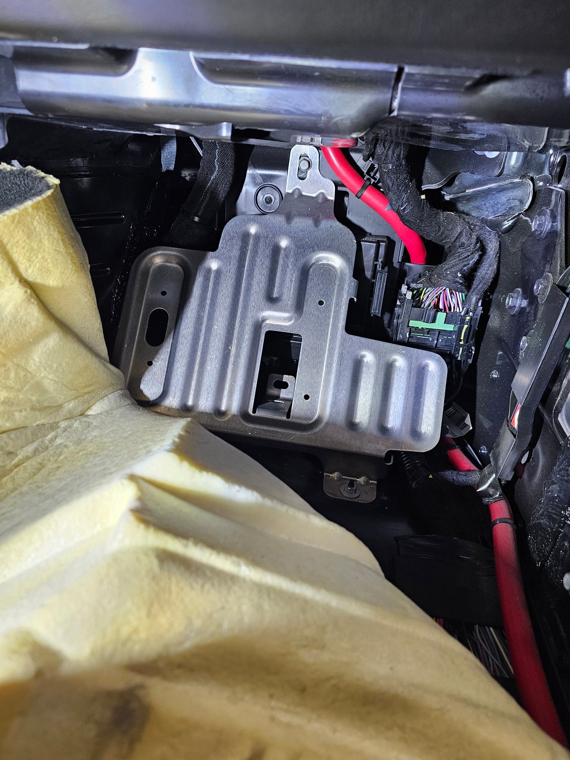

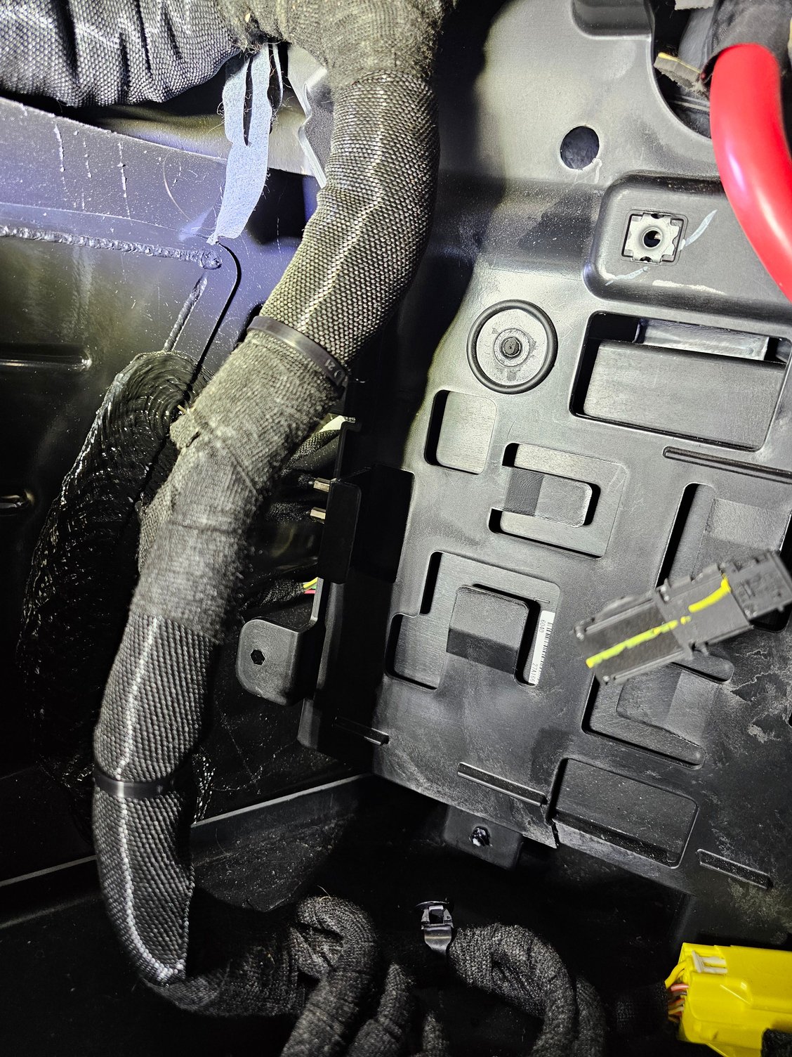

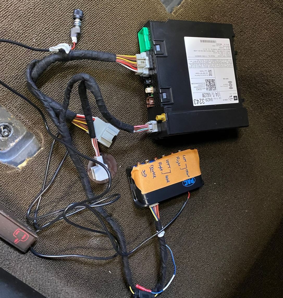

I got down to the radio module and only slid it out partially so I could unplug the two plugs. I added a pic from another thread showing the PAC and radio module connected. There are speaker designations written on the PAC, just not sure how accurate they are. I broke a tab on the kick panel while removing (JB WEld)
Edit: you need to remove the thick black wiring harness clips to give you slack
Old Apr 6, 2024 | 06:24 PM
gsd103's Avatar
gsd103
Joined: Jan 2023
Posts: 17
Last edited by gsd103; Apr 13, 2024 at 01:14 AM. Reason: add: This is a pic I found from another post and the labeling was accurate.

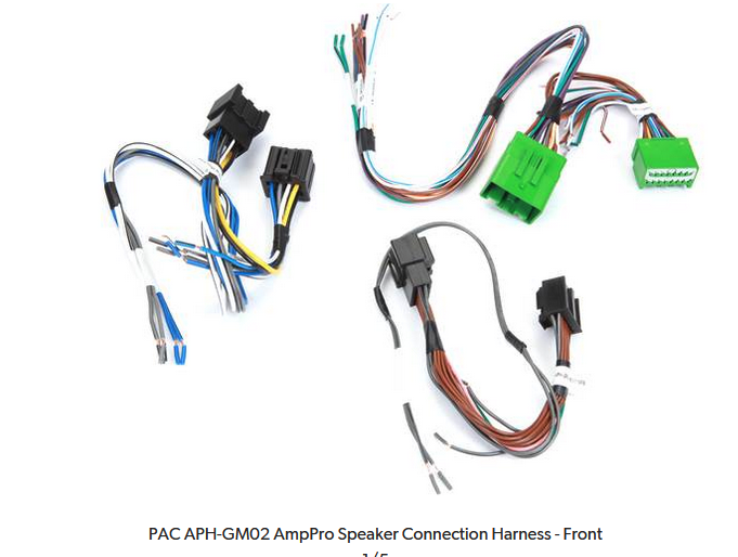

These hook up to the Bose amp minus the lower one in the pic. Disregard the wire labels they are wrong, Use a 9volt battery to see where your speakers are located.
PAC APH-GM02 AmpPro Speaker Connection Harness

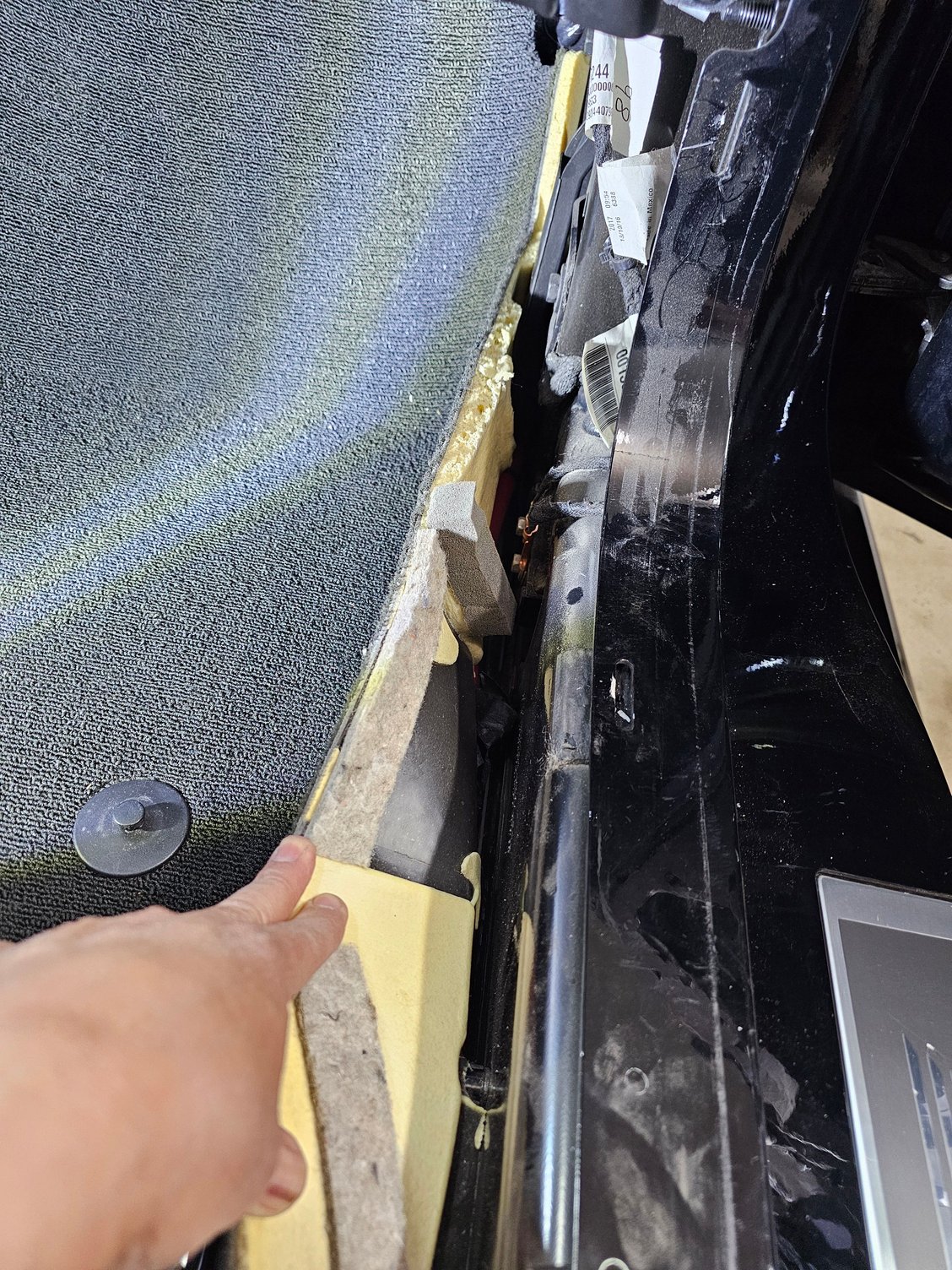

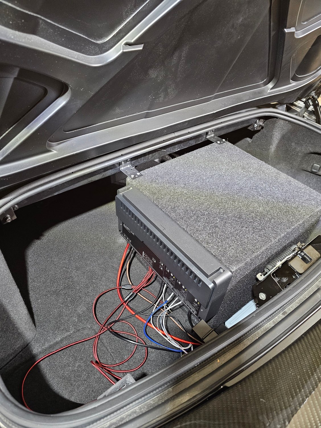

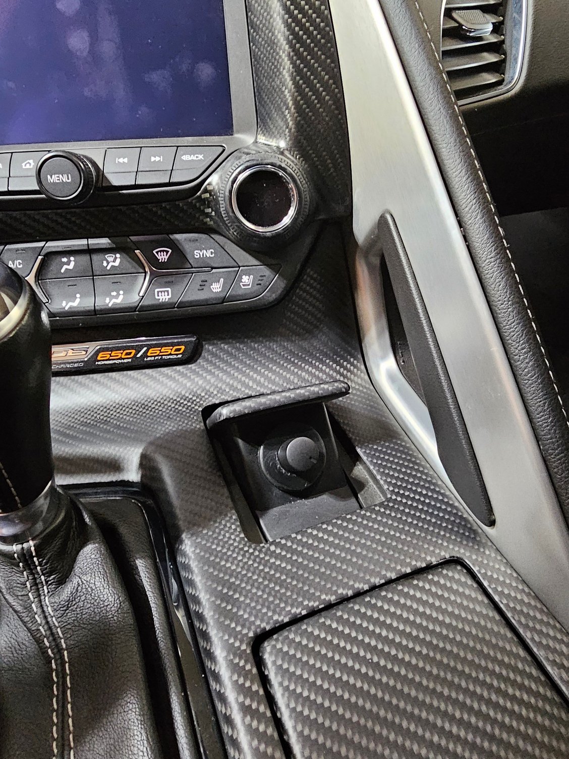

Well I am finally done. I used a large portion of the trunk that some wont like. I do not like the behind the seat subwoofer box look, and would rather give up trunk space. I removed the convertible top interior piece so the box would fit, and used a taped magnet to fool the system. I could not find sub boxes for C7 convertibles that fit in the rear, or pics. The sub is a 10 inch JL 10W6 powered by a JL 900/5 RD . The remote sub woofer controller from the PAC box did not work for me, so I used the JL sub remote.
Used the front aux charger for my bass **** control.
After starting the car I had so many codes on the display, stablilitrack, rear axle, and engine light with poor idle. I changed the battery and I still had the the codes. I disconnected the ground wire and checked the small wire attached to the ground, waited 30 minutes before reattaching. All codes were gone except service axel, and idle was good.
Still need to hide the wires with black plastic tubing.

@VinceC5 and @gsd103, thank you both for your comments above. I had just ordered 3-foot RCAs and started reading the Pac Amp Pro manual, and couldn't believe that the unit gets installed in the passenger footwell area (hence digging up this thread). Seeing all the other amp installs in the back, I erroneously assumed that the Pac Amp would also be installed in between the Bose and new amp, but that was incorrect... So now I now have 20-foot RCAs on order . The silver lining here is that it looks like I won't have to buy a separate ANC-canceling dongle, per Vince's reply.
Some questions for you:
* I had to look up what you were referring to with the 9V battery trick. That's great! Any chance that would hurt the smaller (3") door speakers? The video mentions not doing it on the tweeters, so I assume it would be difficult to test the door woofer wires since they're wired together with the tweeters?
* I am planning on mounting the amp in place of the rear sub in the hatch area, which I will remove since I'll be adding a 12" in the hatch. Is there anything special I need to do to "trick" the Bose system since the stock sub will be missing, or is removing the sub merely an unplug-and-remove exercise? (I'll have a Pac Amp Pro + aftermarket 5-channel amp powering all the speakers and new sub, so the Bose amp will be bypassed on all those fronts.)
* Dom, awesome job on the cigarette lighter plug! I saw some other folks had cut out a square/trapezoid to fit their control *****, but yours looks close to "factory." Is there a specific cigarette lighter plug cover that you used to mount the control ****, so that it was round? Or how was that accomplished?
