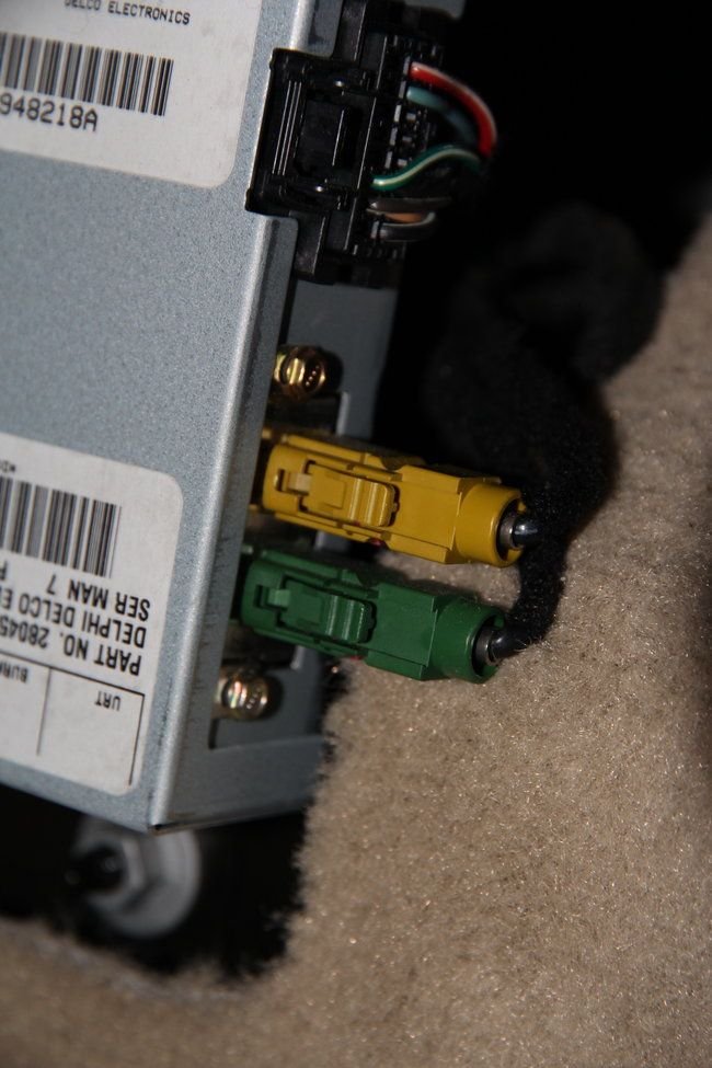

Took off the waterfall. All 3 cables connected. Disconnected all 3. XM1 & XM2 no longer showed on head unit. Plugged in power cable; XM returned on head unit. Plugged in green antenna cable; preview channel audio played for first time. Then plugged in yellow antenna cable; original problem returned, no audio & no signal. Removed yellow and audio & preview returned. Bad antenna? Which one?

Well if I recall correctly the yellow connector is for the signal from the satellite, the green connector is for the ground based signals. Could be your antennas bad, or possibly you have them plugged into the wrong jacks, they should look like this when plugged in.

They are in the right jacks.

Well then I suspect you either have a bad antenna, or your mirror was replaced with one that didn't have an antenna, or your tuner is bad. One way I think you could test it would be to get a antenna off eBay such as this and plug it into your tuner to see if it works then. https://www.ebay.com/itm/37414544825...3ABFBM5Ii5nJRh Other wise I suggest you don't even worry about it and just replace your head unit with a new XM tuner, and the antenna that comes with the new tuner you can mount behind the dash on top of the center vents, it works fine there.

Once I removed the yellow connector, the radio started to play. It stopped again when the yellow one was reconnected. Bought a replacement from Amazon and now works fine. Will be replacing the head unit in a while. Thanks for all your help!

Well then like I mentioned, your issue seems to be with one of the antennas in the mirrors, it's either been replaced with a mirror that didn't have an antenna in it, or somehow the antenna went bad. If I recall correctly, there're some Fakra antenna connections under the dash on both sides of the car that are able to be disconnected for mirror replacement, etc. and perhaps someone unhooked and never reconnected, and I've seen pictures of where they're located, but I can't remember where I've seen them at, if I stumble across them again, I'll let you know.

Well then like I mentioned, your issue seems to be with one of the antennas in the mirrors, it's either been replaced with a mirror that didn't have an antenna in it, or somehow the antenna went bad. If I recall correctly, there're some Fakra antenna connections under the dash on both sides of the car that are able to be disconnected for mirror replacement, etc. (see photo) and perhaps someone unhooked and never reconnected, and I've seen pictures of where they're located, but I can't remember where I've seen them at, if I stumble across them again, I'll let you know.

Tested the yellow antenna connector at the waterfall and it reads a dead short. That's why it kills reception when I plug it into the rcvr. Still can't find how it's rouited between the waterfall and mirror?

Yep, that would probably do it. I can't help on the routing, mines an 05 with the "wart" antenna on the trunk lid. I would suspect your wire's pinched someplace. perhaps where it goes from the car into the door.
