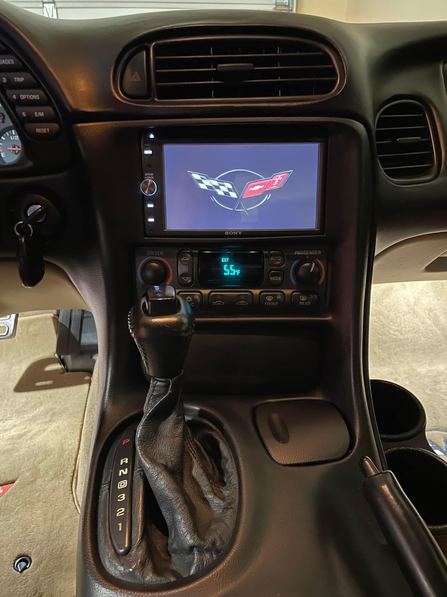

Hey guys just wondering how do you load the C5 badge graphic onto your unit once installed and where do you find these graphics like this one ? Does it show up once the car starts also without icons of apps blocking the image ? Thanks…

depends on the unit. Some units allow you to do it, some dont.

Hey Pete, this is Pete. Welcome to the forum. One thing I suggest is to buy a quality head unit i.e. Kenwood, Pioneer, Sony, Alpine etc. and spend the money to get all the features you want, like you mentioned adding the C5 badge to the display, also one that has multiple camera inputs. I know you mentioned a dash cam, but I suggest a front camera mounted at the front of the car (which can help in avoiding front end damage from hitting curb stops), and a backup camera mounted at the back which is really handy for backing up. If you want the ability to record the video, you could incorporate a cheap 12V DVR into your system, I did that with my front camera and have the ability to play back the video on my head unit, should I be involved in an accident that wasn't my fault, I'll have video proof.
