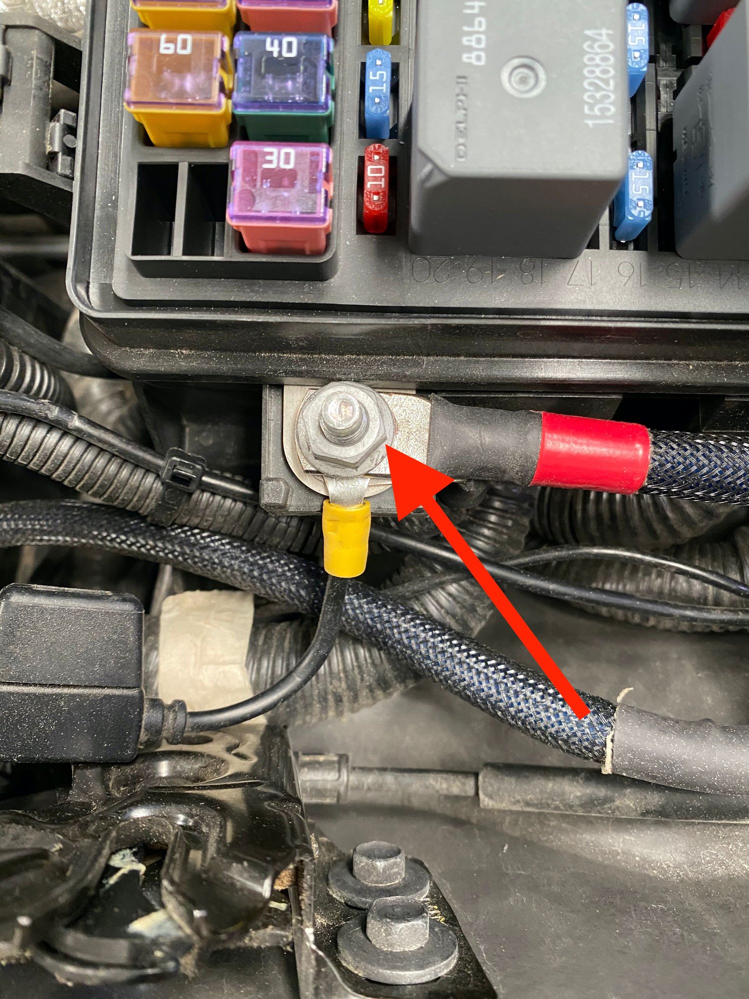

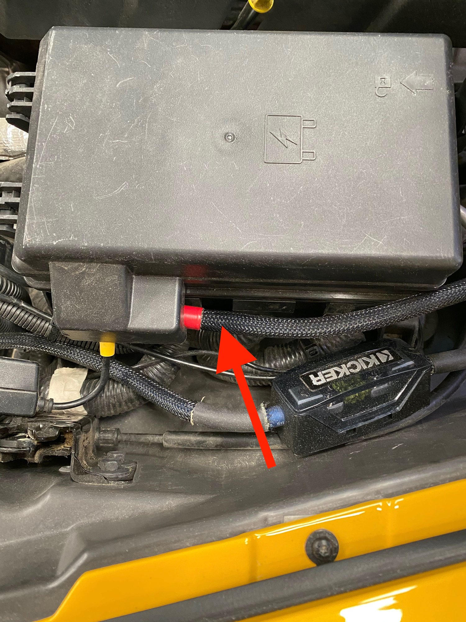

Easiest just to come off the Kenwoods Sub output RCA connections on the back of the deck then running the RCA cord to the sub amp inputs. There'll probably something you have to turn on in the Kenwoods settings to turn on the sub outputs. As far as running power for the sub, ideally you want to ground the sub amp as close to the amp as you can, then I personally ran the positive power through the firewall and connected it to the battery + connection which comes directly off the battery on the underhood fuse box. Just don't forget to add a fuse on the power line close to the battery connection, and run the proper gauge wire for both the + and - wires per the sub amp manufacturers specs.

I did the same in a different way. I added a terminal block to screw other devices on like cameras, wide band etc. It was easy going through the firewall with other wires behind the battery.

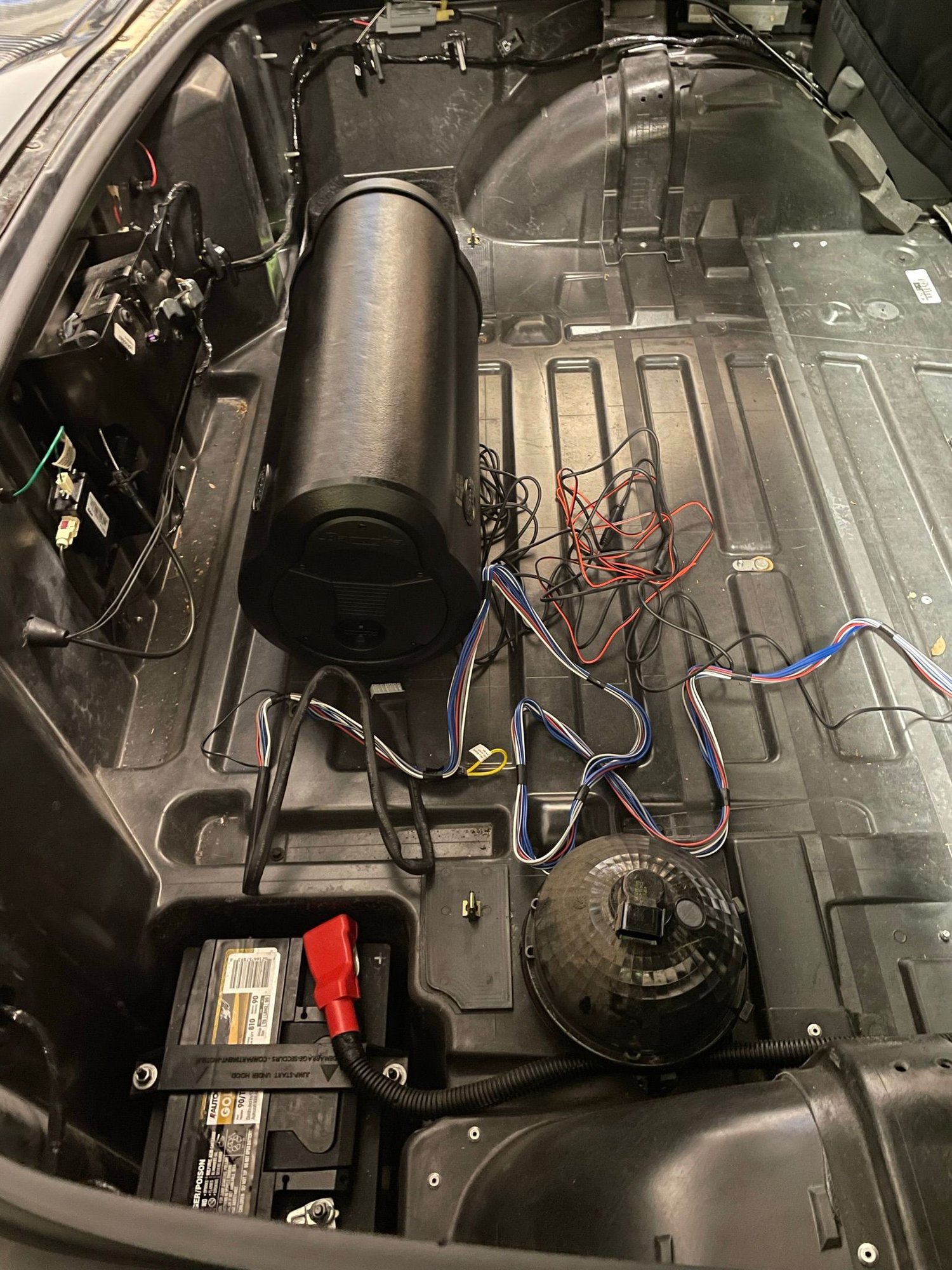

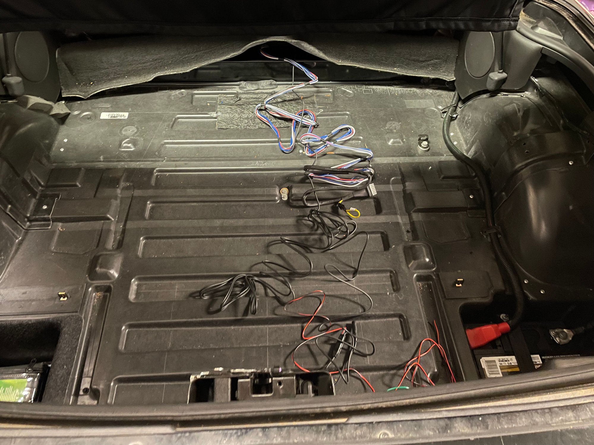

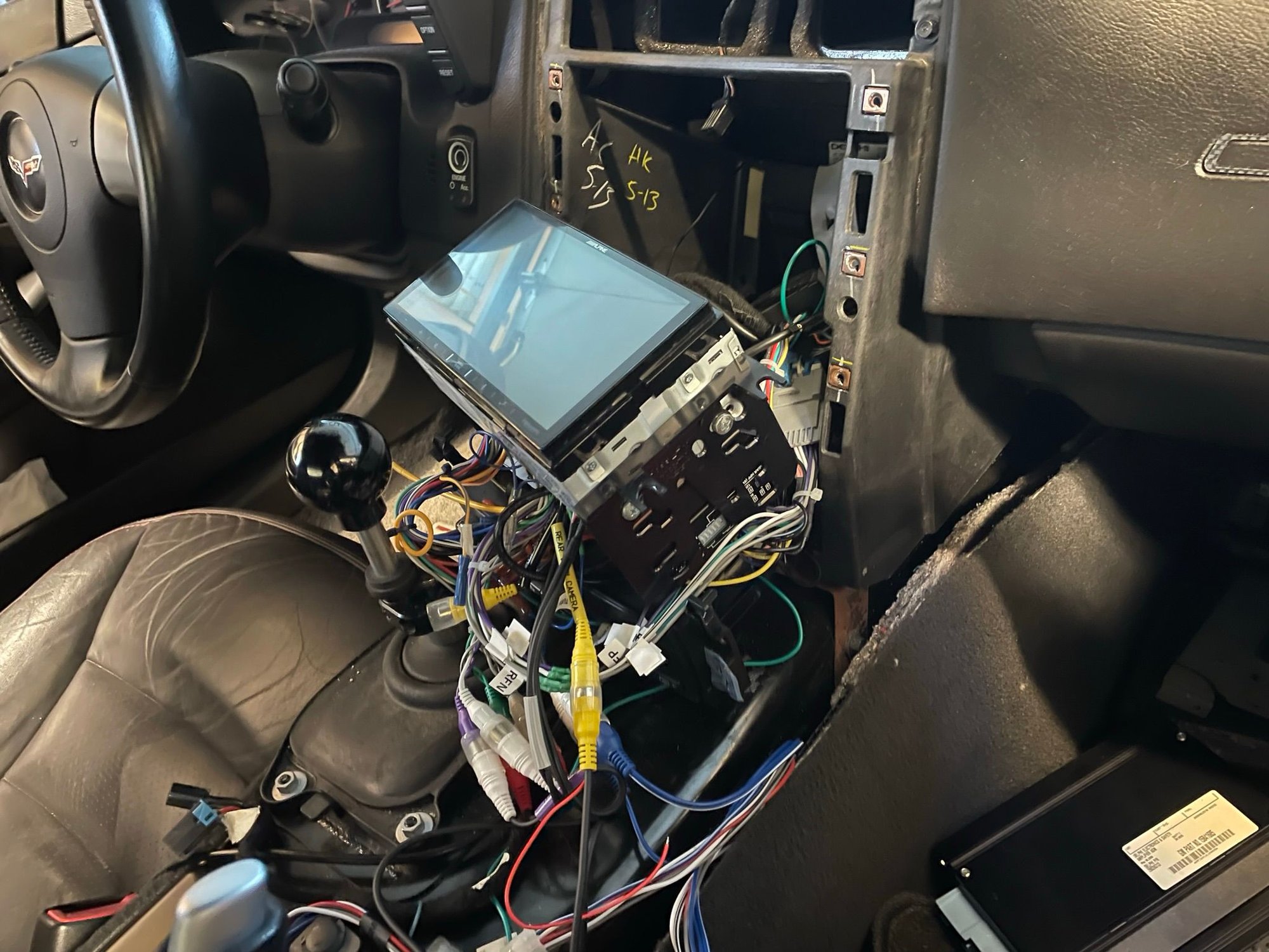

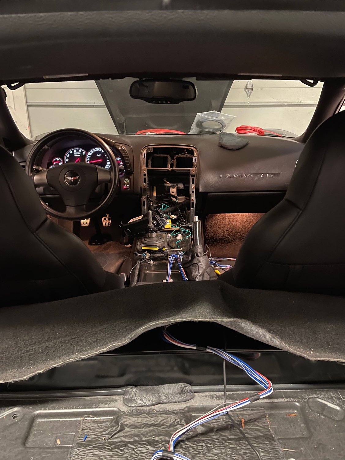

I’m in the process of installing one of these (as I’m not looking to rattle my teeth either):
https://www.crutchfield.com/p_204BTA...-BTA850FH.html
I’m going to use the sub RCA outputs coming off of my Alpine receiver. I’m going to mount it in the rear (easy access to the battery) so it can easily be unplugged and removed if I need more space and for auto cross and track days.

I remember back in the day, the Bazooka subs where pretty impressive, but it's been years since I've heard one. I kinda considered one myself for my Vette, but I have a vert and figured the sound would get muffled with the top down, so I designed and built one for my Vette that mounts behind the seats that sounds real good with the top up, or down. You'll have to let us know how the Bazooka sounds when you get it installed.
