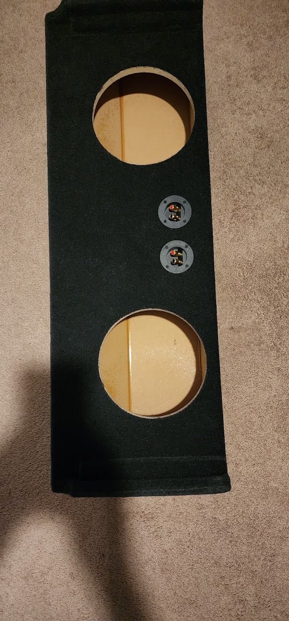

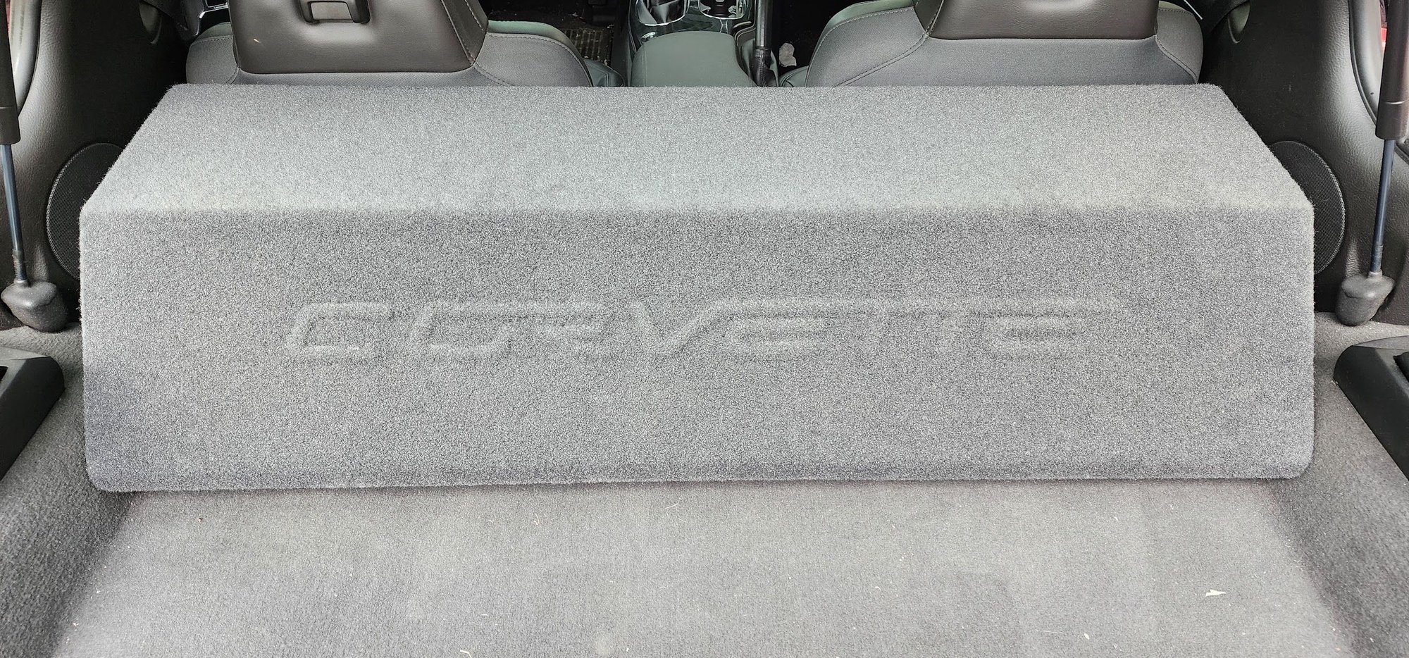

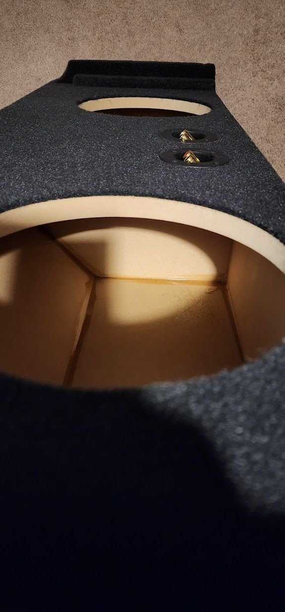

I just bought the down-fire 10" box but I don't have anything installed yet. The enclosure seems to be good quality and the carpet matches well. I'm going to be running Sundown Audio SD-4 subs on a Down4Sound JP 13.2 AB amp. I'll throw the enclosure in my car and take some pics later today.
