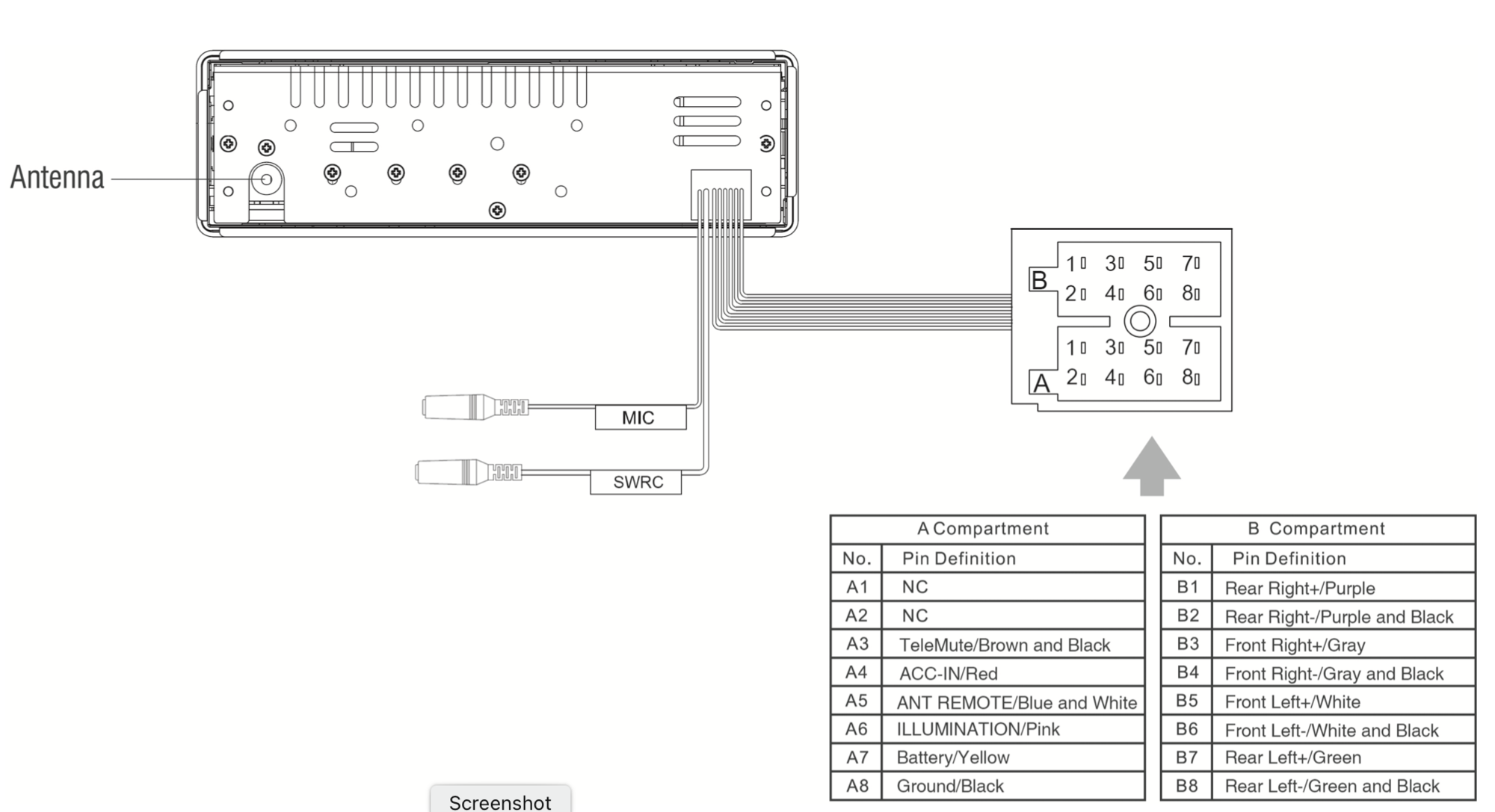

Not sure which specific radio you have but the way I see it is that A4 should be the switched +12V and the A7 should be the constant +12V. You're right, their instructions suck.
Old Mar 28, 2023 | 11:18 AM
  #56
madsonp's Avatar
madsonp
Joined: Oct 2017
Posts: 5,427
Likes: 2,309
Another one of their diagrams, in this case A4 (Red) is switched +12V and A7 (Yellow) should be constant +12V
I believe it was in 1995 when all aftermarket stereo wiring was standardized, so all manufacturers should be using the same colors in their wiring for all connections.

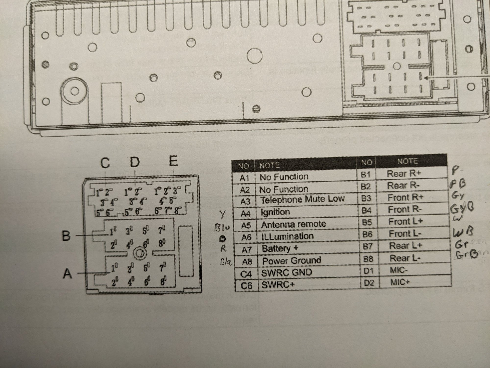

I wrote in the wire colors when I installed it: I remember reading a comment on a Youtube video where some guy mentioned that they were opposite, sheez could the diagram be wrong? I'll check it again but doesn't look like I'll get to this today, it's going to rain all day and the Jag does not go out of the garage on days like this...
Yeah, it looks to me by your drawing that you have the Yellow and Red reversed, Red should be ignition, and Yellow should be Battery +

Well I'm pretty sure I matched the colors to the pins correctly. It does bother me that the second photo you posted shows something different. If the manual or the pin wiring is in error I don't think there is any way to verify that, when I started this whole thing I tried to contact Continental a couple of times to check compatibility and never got a response.
Is there a downside to switching the red and yellow wires to see what happens?

Switching the Red and Yellow wires shouldn't be an issue, they're both a 12V+ signal, the only difference is one is switched 12v+ and the other is constant 12V+ which maintains the decks settings and clock when the car's not running. Continental is not known to be a quality brand like Pioneer, Kenwood, etc. so it's hard to say what they're doing with their wiring.
