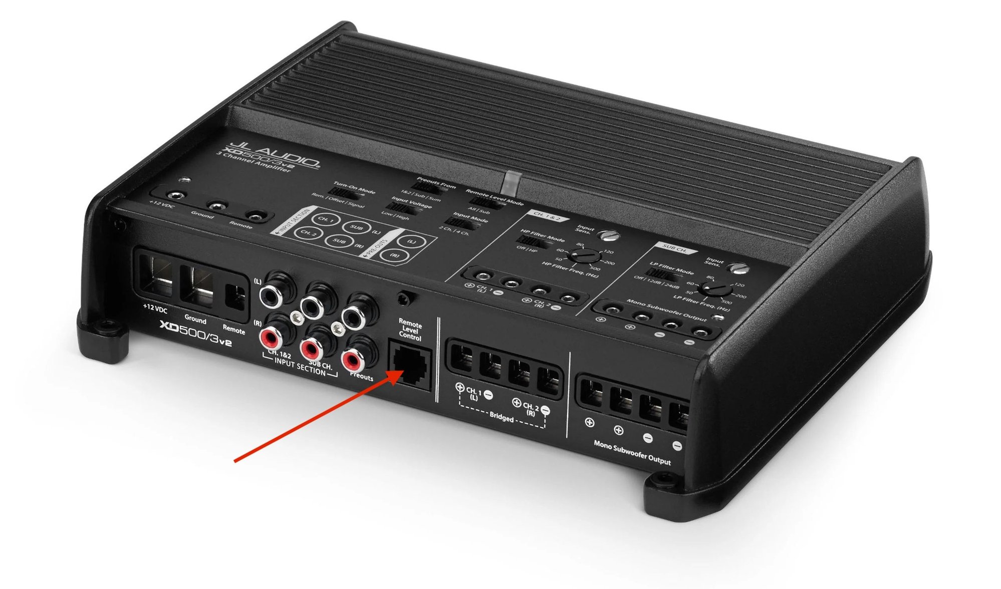

Well looking at your amp, it looks like it has a jack for a remote to adjust the bass level (see picture). Do you have the remote connected to it ? Also like I mentioned before, you should be able to adjust the subwoofer levels in the settings of your head unit.

Afraid no remote.
